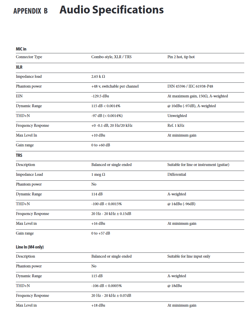

The M2 is not as good. The best performance with the M4 is with the two rear inputs.
See attached, and take note of the M4 only bit. The other advantage of the M4 is the fixed gain on said two inputs. Makes things MUCH easier for repeatable measurements. You can set the levels digitally, whereas with the front inputs you have variable gain (via the gain knobs) so getting the exact same setting across measurements can be difficult (had that problem with my focusrite 2i2). This is from the combined manual for the M2/M4.

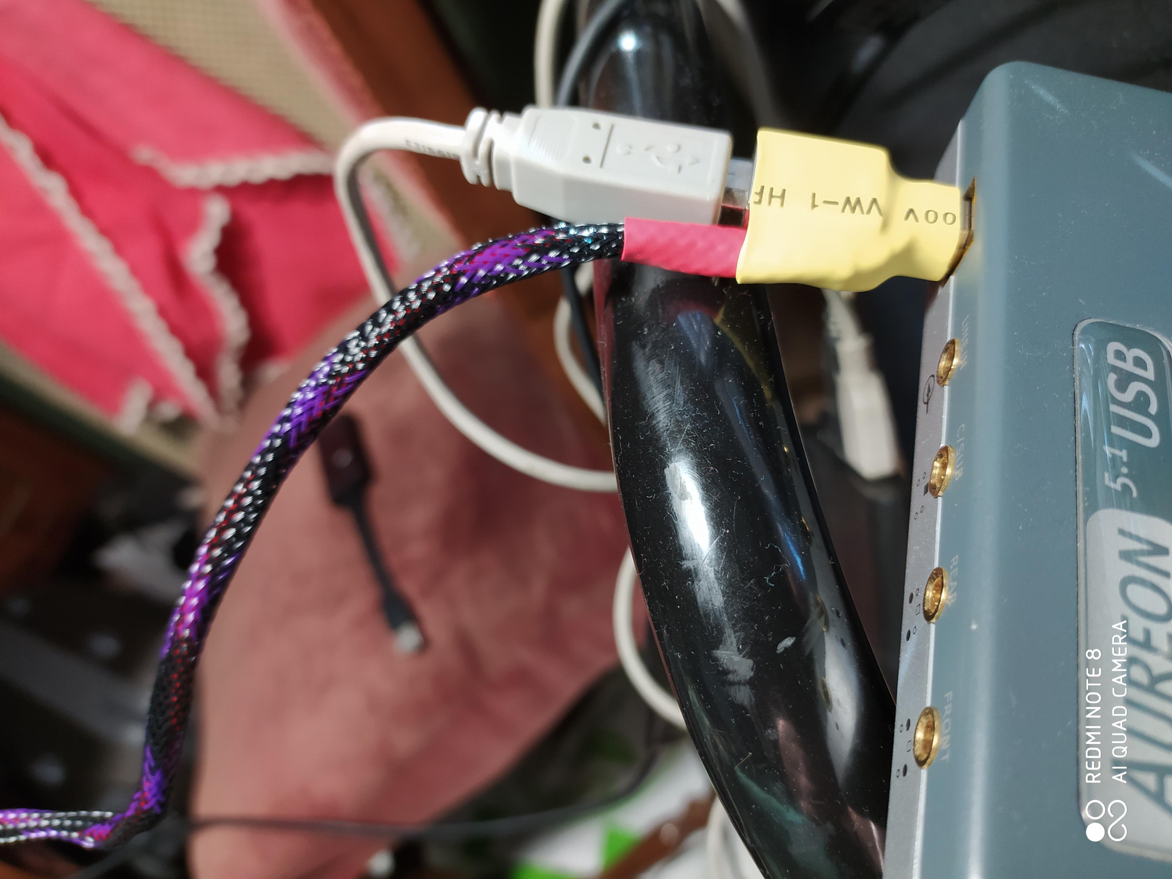

Thanks a lot for the helpful explanation. With the usb injection cable 😱 i bought i will be experimenting different +5VDC power options with my very cheap sound card. My reasoning is ... this card for sure will have very very basic circuitry and a very low suppression of the noise coming from the usb power line. Therefore a good tool to check the noise of the different power solutions. The better power supply (the one with cleaner output) could lower the noise floor of the card. At that point i will know which one is the better power supply and i will upgrade the card. Someone has told me already that there will be no difference at all. With the noise depending exclusively on the adc used.
If there will be no differences with any power solution ... well it will be very important as well. But i have to see to believe
It will take some weeks to receive that bloody usb injection cable.
I have also bought some step down converters that can take a wide range of DC voltages at the input (try a SLA battery will be much easier) and have a usb socket at the output to feed the card.

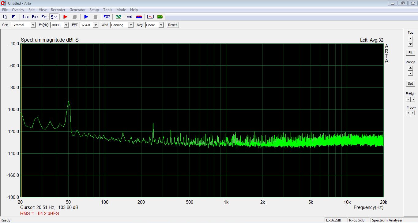

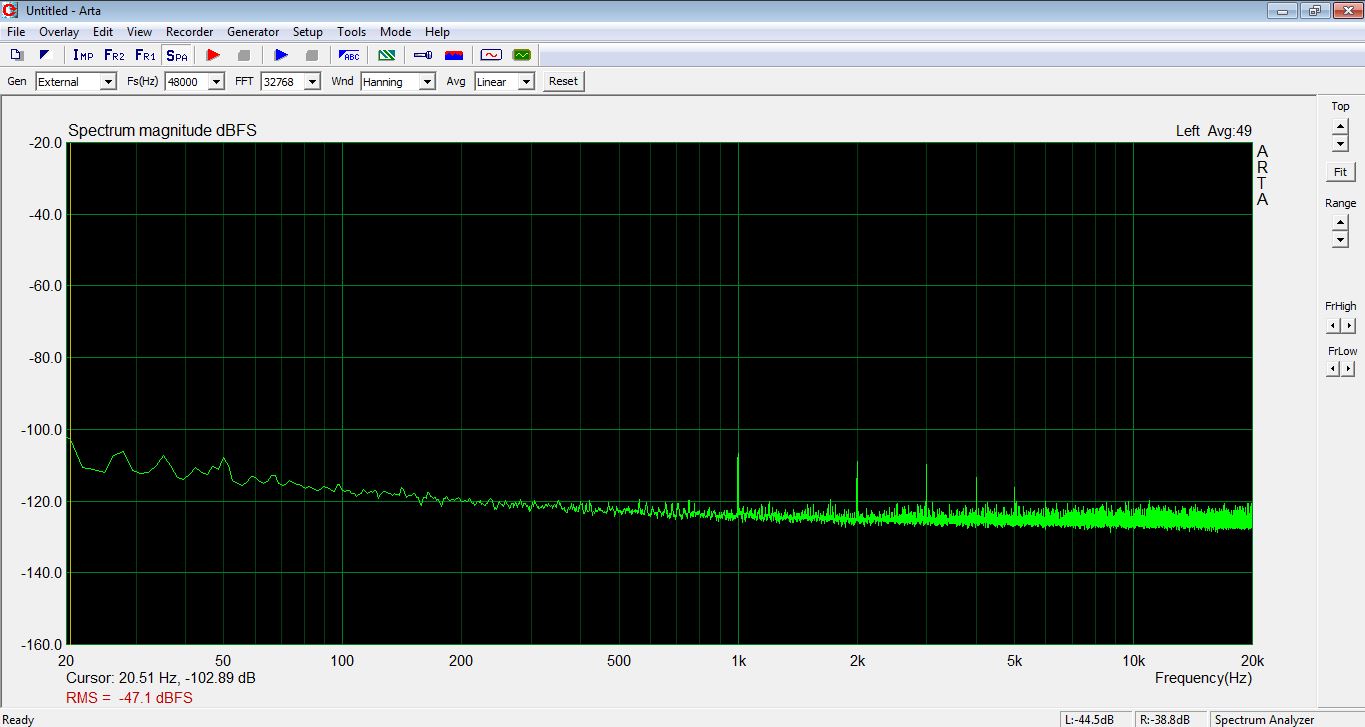

Hi ! i got the power injection cable. No differences at all with different +5VDC power supply solutions 🙁😱
Therefore is not the power supply responsible for the card noise floor ... it is something inside the card itself ... i see 4 screws 😀

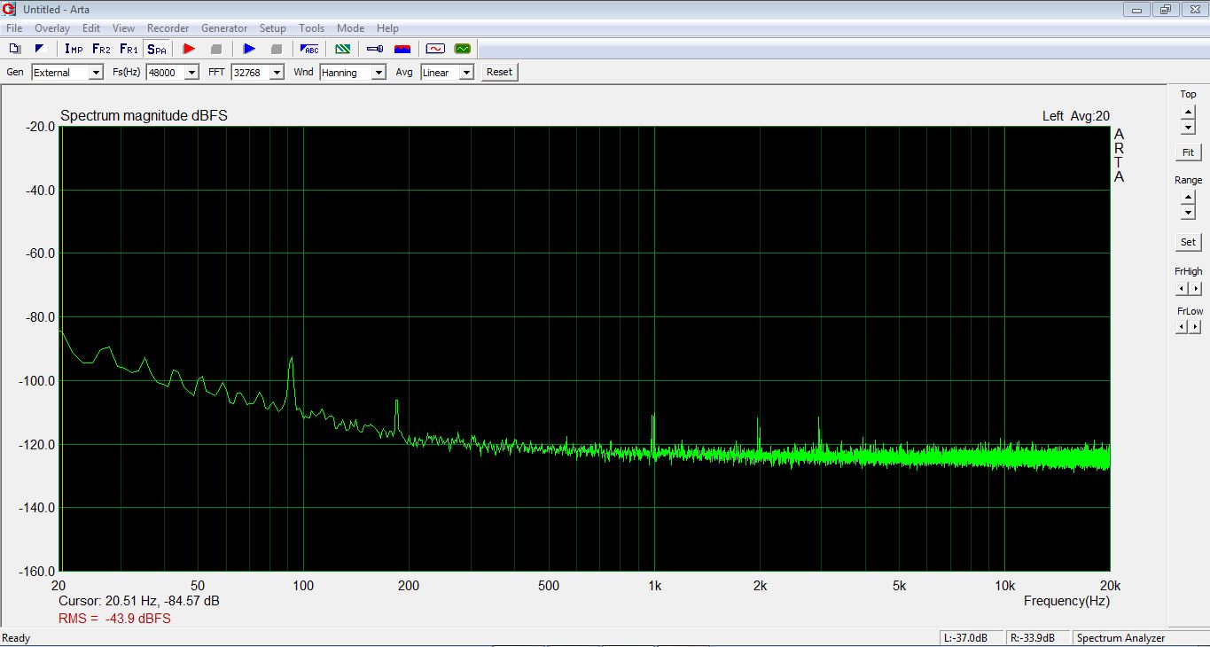

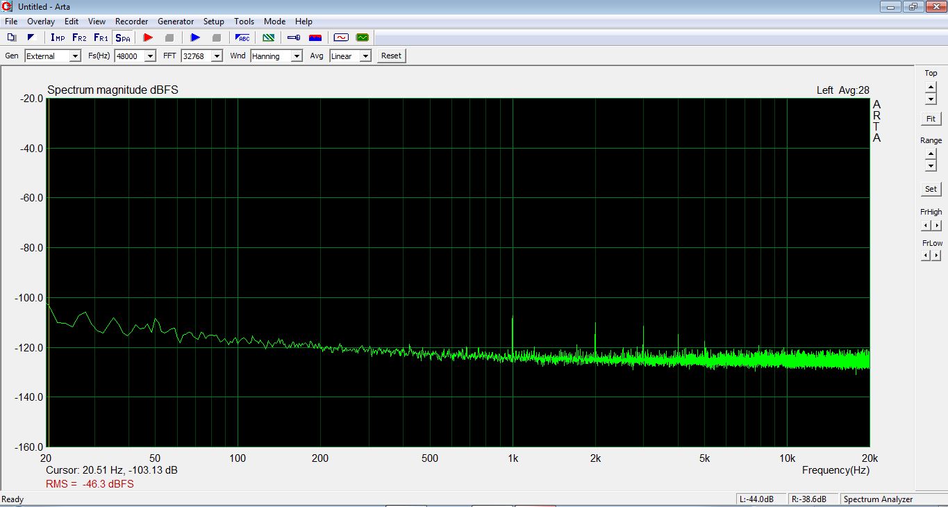

Hi i checked better with the card powered via usb cable by the laptop
From the attached pic i see the same noise floor more or less. So to me the noise floor is very card dependent and not influenced by the power supply.
If i want the -140dB i have really to change card ... and it is perfectly fine because this is a very cheap sound card. No surprise.
In the other post the first two graph have been obtained
1) 12V linear power supply and a dc-dc converter to provide 5V
2) 5V linear power supply coming with the usb injection cable
First two are really very similar, but the third one definitely looks much noisier.
for me the last one looks less noisy
Maybe something changed except powersupply?
Hi ! i notice now that i have not used the same dB range on the left ... so some graphs look noiser than the other ... but not enough for me to say that using an external power supply improves things significantly.
Maybe there is another dc-dc conversion inside the card ? and that sets the overall noise performance.
anyway there is a RMS value for noise on the graph (bottom left). Very similar in all cases. 🙄
The limits are clearly inside the card 😱
Maybe I was wrong, the last one actually less noisy but has to much "grass". It doesn't help for measurements. So easier to use first two. The last wants some clean.for me the last one looks less noisy
The 1 KHz could be the USB communications getting back into the audio. Was the input shorted for these measurements?
