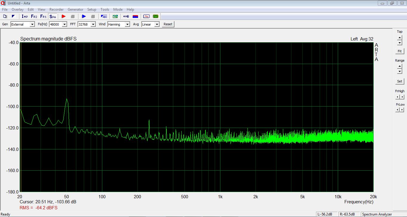

- this is not a right made test. It describes only a part. It is made in ASIO 16 bit mode and bad motherboard.
So, this test shows something like how bad it can be but not how good it can be. "If we'll work with bad motherboard with much surrounding noise in 16 bit" test.
The STX has a claimed distortion of 0.0002%, which is really good for consumer gear. My current utility USB sound card is a Focusrite Clarett, which is ever so slightly better at 0.0001%, and works really well as a measurement device. It also sounds great and has a surprisingly good headphone amp.
Hi ! thanks a lot for the interesting advice. I guess you use an external power supply ? i ask this because i cannot understand how 5VDC weak and dirty can power a usb sound card properly ... first think i learned not to rely on usb bus power voltage. A serious usb sound card should have an external dc source.
And actually i see a dc socket on the back panel of the Clarett ... good !
Yes it is PCI card. But there are good enough USB cards too. I have got "first" generation STX, not STX II. STX II have to be better a bit with it's internal noise.
Your ARTA spectrum screen is made without an averaging (AVG: 0). Mine screen is with averaging ( AVG: 100), so difference is not so much.
I don't have a spectrum without avg. now to compare (can do it at Monday).
Averaging helps to eliminate noise and lefts periodic signals. (It improves signal-to-noise ratio).

i am attaching the noise of the open line input with avg linear ... and this is with laptop powering the card through USB.

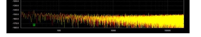

QuantAsylum QA401 (which you should consider) and several of the PicoScope range of external "sound cards" are quite serious - and USB powered.Hi before replying i would like to state again the question ... how can you live with USB power ? the +5VDC are weak, dirty ... and a card that has to rely for power on that voltage has a very big challenge ... a serious usb sound card asks for a separate high quality power supply imho. 😉
Hi ! very impressive noise performance indeed 😱
