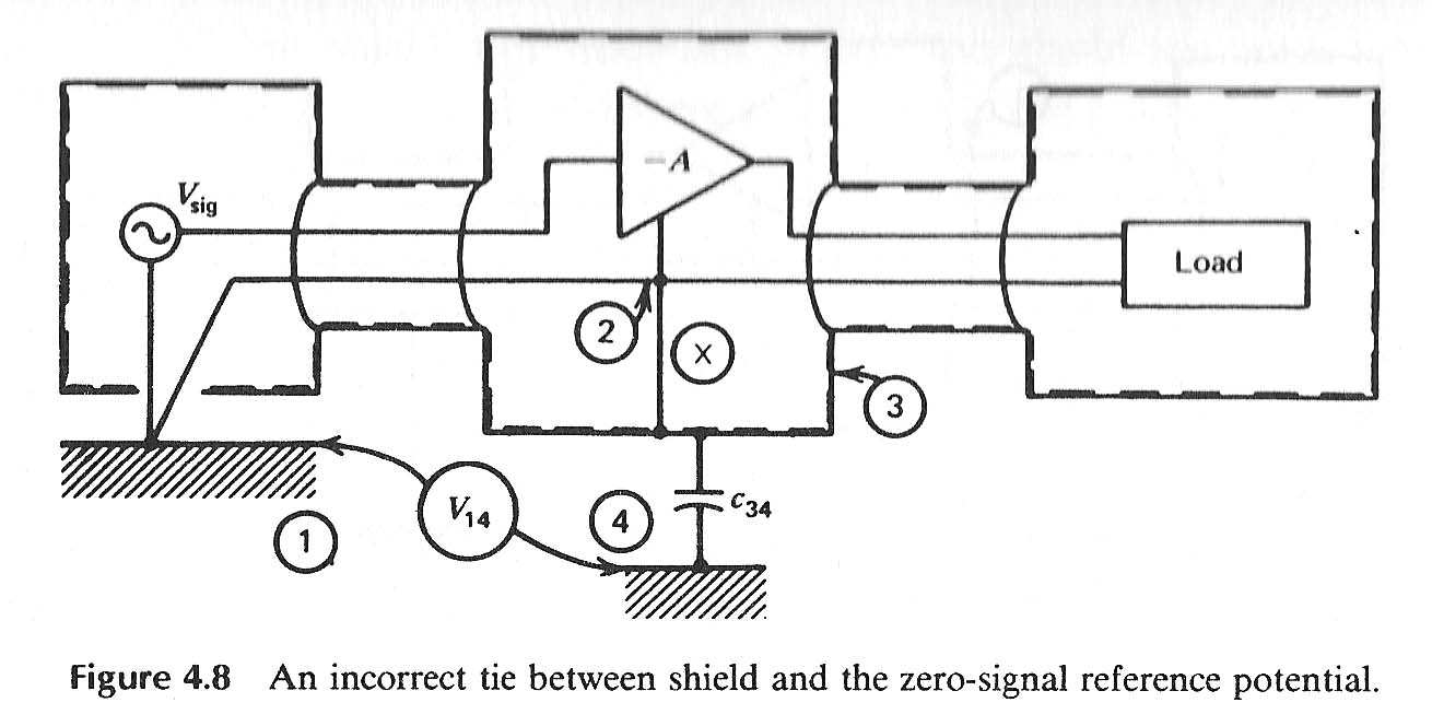

The ADC is NOT the final frontier. For noise measurements, one uses an
external preamplifier with 50 to 80 dB gain and the line input. That masks the ADC
noise completely. The ADC needs to sport a flat frequency response and that's it.
ADC dynamic range is needed only for distortion measurement. Dynamic range
is the weak point of my Agilent 89441A FFT analyzer with its 12 Bit 24 MHz ADCs.
It gets problematic below 100 Hz when its excessive 1/f noise finally wins against
the added preamplifier gain.
But a sound card does not have a 12 bit ADC.
The final frontier is the noise of the preamp input stage, ground loops and
bad shielding. Local batteries in the preamp help a lot.
I usually have the preamp in a Hammond box with batteries inside and the DUT
in a second Hammond box.The 2 boxes are connected by a short piece of
semi rigid coax cable and nothing else, and everything together is in another
large metal box.
When the 2 Hammond boxes inside touch in addition to the semi rigid, you see
additional signals immediately because of the 15 cm ground loop.
Illustrated by Morrison in "Grounding and Shielding Techniques in Instrumentation", V 1->4
