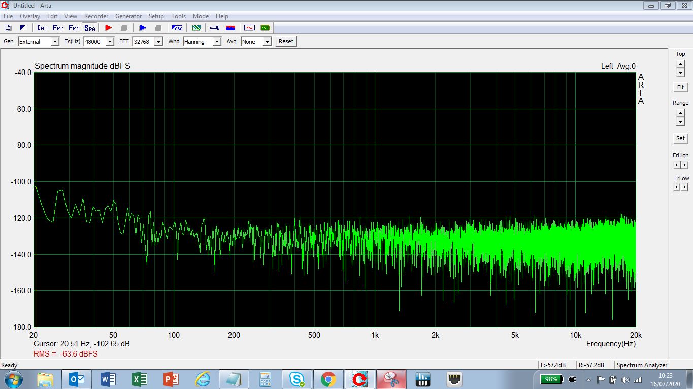

I am attaching (i do not know if i did it right) the noise of my current usb sound card (Terratec Aureon USB 5.1) with the mic input open and powered from the laptop. (This laptop is running Win 7 but mine runs Win 10).

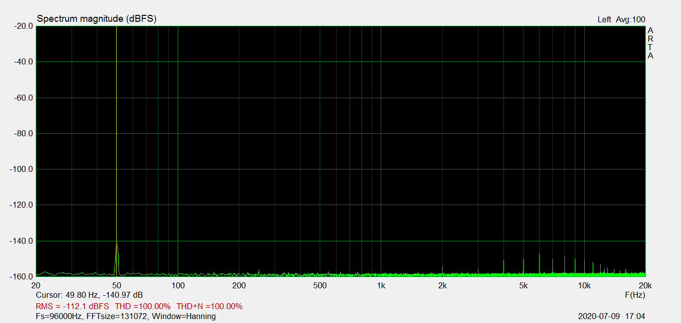

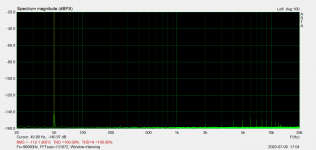

This is my Asus Xonar Essence STX Line-In (ASIO 32 bit), in attachment. I think it is good enough for audio. If it is not sensitive - then I don't know... 🙂

Your Asus card looks 40dB less noisy than mine ? 😱🙁

Yes it is PCI card. But there are good enough USB cards too.
I have got "first" generation STX, not STX II. STX II have to be better a bit with it's internal noise.
Your ARTA spectrum screen is made without an averaging (AVG: 0). Mine screen is with averaging ( AVG: 100), so difference is not so much. I don't have a spectrum without avg. now to compare (can do it at Monday).
Averaging helps to eliminate noise and lefts periodic signals. (It improves signal-to-noise ratio).
