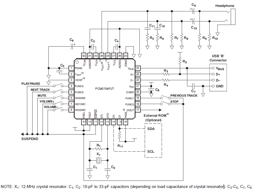

New schematic attached.
All Function and HID inputs grounded.

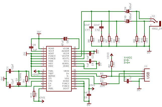

Hello,
I'm still struggling with the PCM2706.
I have build on a stripboard the attached schematic.
Any idea what went wrong.
The message i get is that the device has malfuctioned and cannot be recognised by windows.
Any suggestions welcome, I'm desperate.
Thank you
If it's helpful to you, you can find my PCM2707 implementation schematic and PCB here. PCM2707 is pin-compatible with PCM2706 so I guess this might be useful. It is confirmed working.
FSEL should have a pull up/down so it can't inadvertently be floating (and then it only needs a 2-pin jumper). U2 is a 74LVC1G08, a 1 gate 2-input AND with 5-volt tolerant inputs as a level switcher, run with Vcc at 3.3V. It's not strictly required, just makes sure the device won't start up without local power (voltage divider on Vbus works too), but don't put 5V here.
Pretty straightforward.
