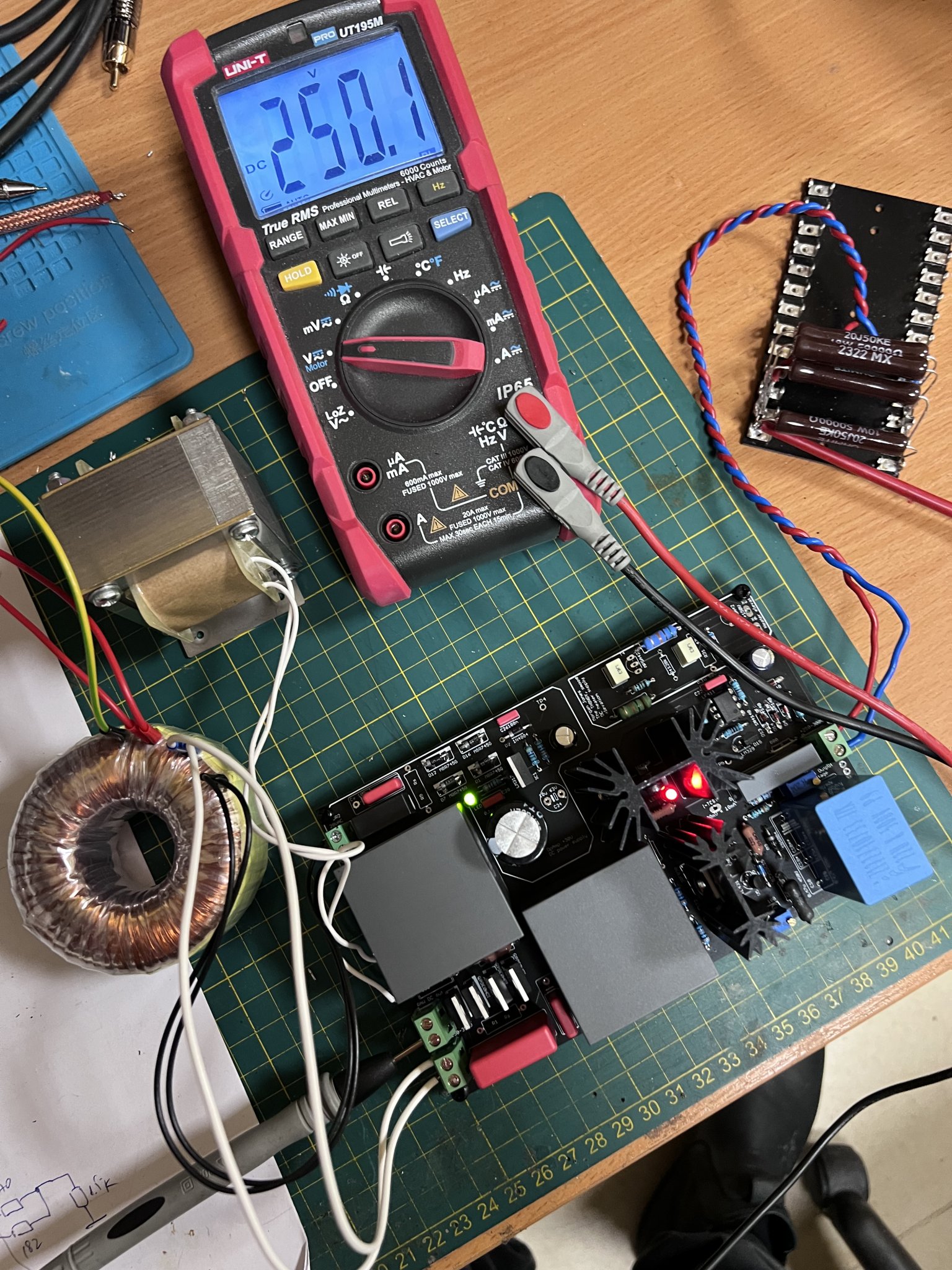

I found solution. Somehow I mixed MPSA29 pins differently that it should be. After changing them correct then no high frequency noise anymore. Sound also comes out. 🤣
Pin 6 - 224 V
Pin 1 - 144 V
Pin 3 - 2.35 V
Do I need to lower pin 1 voltage and how would be best to do that?
Pin 6 - 224 V
Pin 1 - 144 V
Pin 3 - 2.35 V

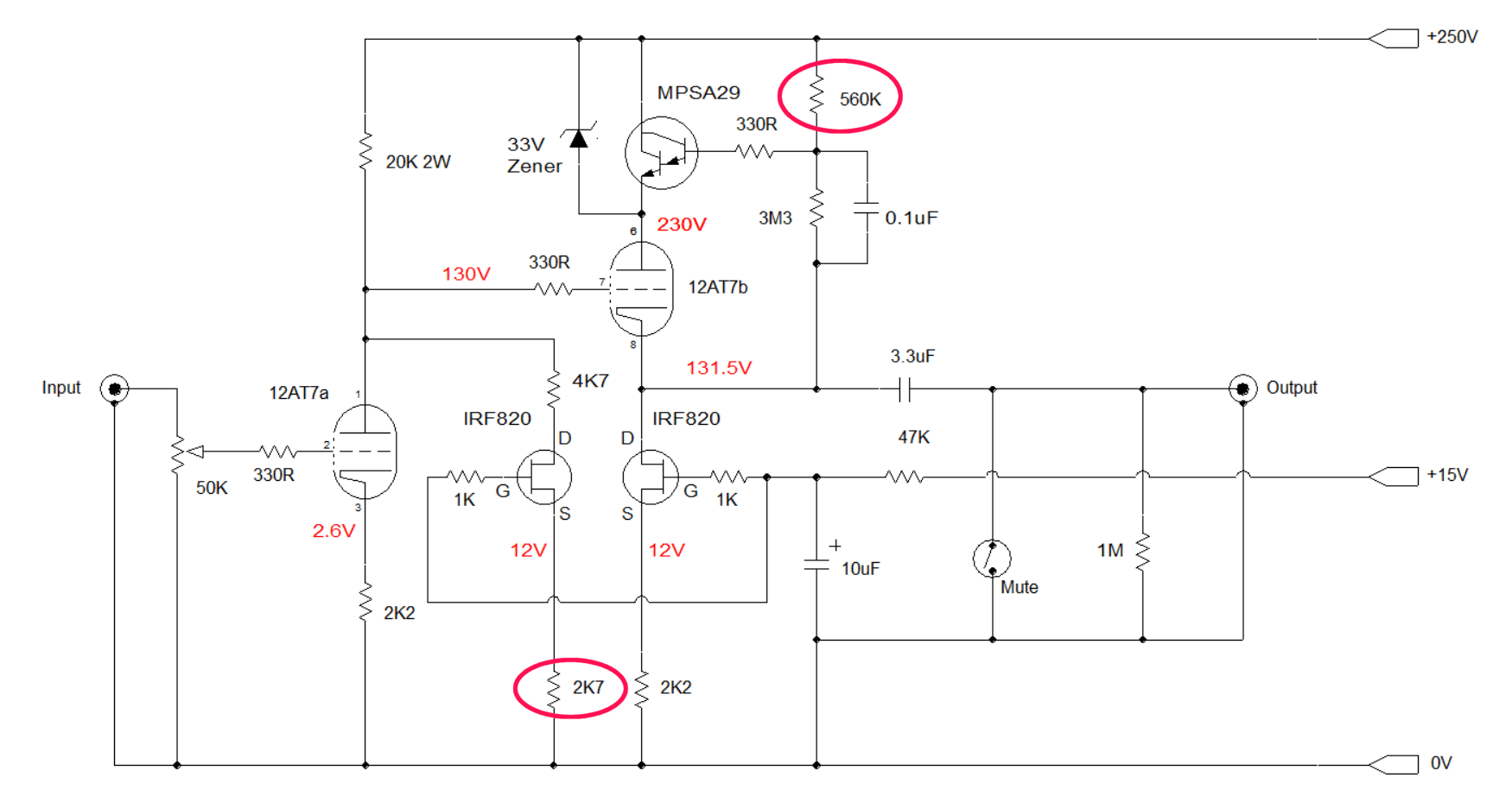

Sounds like good progress.
I can see two things that needs to be adjusted, so that the circuit is well balanced.
It all depends on where your high voltage sits, is it +236V or +250V - let me know the correct voltage and then I should be able to give you specific advice.
OK then, what needs to be adjusted are these two resistors:
1) If you are getting 226V on Pin 6, then that is reasonable in the ballpark and close to 230V. You can tweak the 560K, likely 470K would also be OK. But I would leave it as is.
2) Adjust 2K7 to bring down the 144V on Pin1. Try replace 2K7 with 2K2 and let me know what voltage you end up with, something nearer 130V. I suspect it will then all be OK.
I have made changes.
Input voltage 253V (raised to get 130V on pin 1)
Pin 1 - 130V
Pin 6 - 228 V with 470k resistor
Pin 3 - 2.14 V
If the output voltage is close to 2 V then I kind a hear distortion specially in bass area. Could be HV regulator issue? I am using Allen Super Reg tp has voltage 0,15 V which should be 15mA?

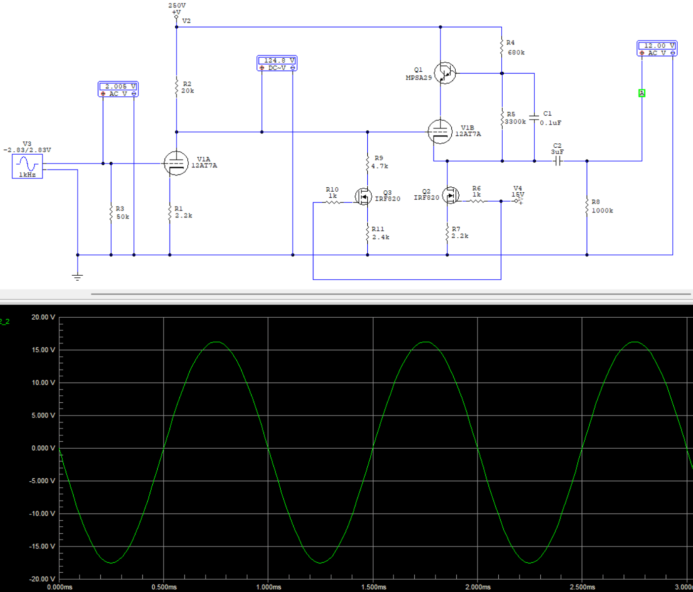

The 'scope' is on "A" which is the output and more that 30V peak-to-peak:
Here I increased R4 to 680K. Makes Pin 6 sit on +226V. You may need to gradually increase R4 to see if that improves the situation. Are you sure the MPSA29 has not been damaged. Do you have a True Volt AC meter? Or a scope AC coupled, check that the voltage swing on pin 6 is clean and symmetrical. Check Source voltages on both IRF820 (or whatever you used there) and around +12V on each?
It should be able to swing 12V RMS on the output with a full 2V RMS input. If not, there has to be something preventing it.

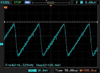

So, I build SuperRegulator with slightly modified CCS part, with LF411 OpAmp and with 22uF PP instead of electrolytic capacitor (in the picture blue one):Would there be any benefit not use any electrolytic capacitors but PP instead?
And that was not good idea! At the output I got very nice sawtooth shape signal and whistling sound at the phono output:
Changed PP capacitor back to 22uF 450V electrolytic and whistling sound disappeared. So, it is not always possible to follow the rule that the electrolytic capacitors are evil. The better low ESR PP in this case causes such type of oscillation.
Quite so. The SuperReg is sensitive to capacitors and the opamp used, something I have observed too. The higher ESR is likely the reason it became stable and not the same bandwidth as the PP covers, slowing things down. Maybe this is a case where you do what needs to be done to make it work. Keep an eye on stability and if it stays that way, then so be it.
