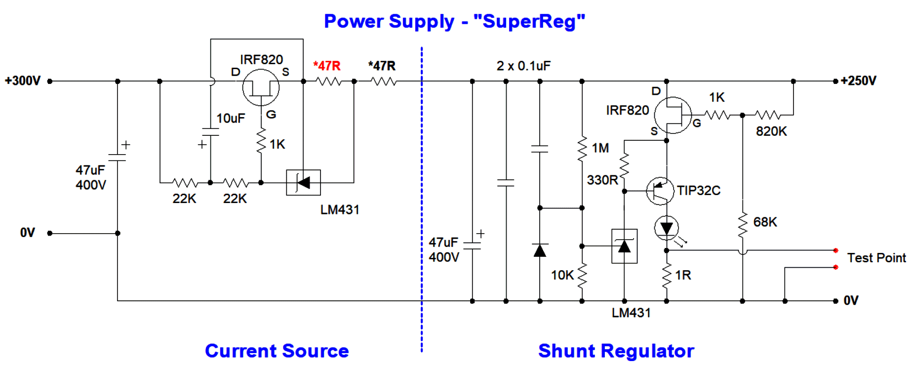

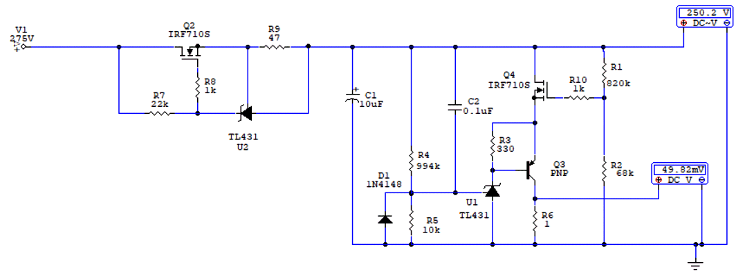

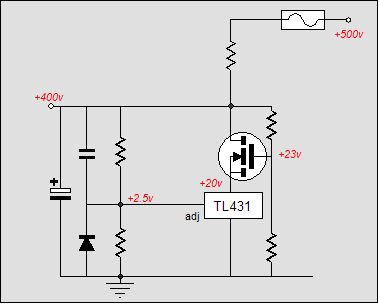

I have been eyeing a shunt reg based on using TL431 as a reference, below is borrowed from John Broskie's tubecad.com, but I have used many variations based on TL431, it's been very versatile to me:
Easy to set to 250V and then use a current source (can show what I would use), to make a simple but effective two-stage "SuperReg" and use about +300V or near it.

As far as that Broskie shunt reg. design, we think alike. I‘ve also been eyeing it. Broskie later published a slight variation of that circuit, attached below.

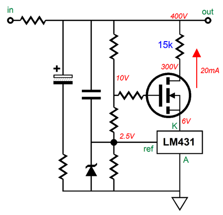

I have another project in mind that requires +100V and I changed values for +250V and it looks like below.
NOT YET BUILT - SUGGESTED ONLY:
A couple of explanations. The LM317L sets up 1mA and all the current goes through that LM431. This is better than using a resistor. It means that the added 1mA to the end result is also current sourced. The TIP32C redirects the current, the (red?) LED does mean that it is limited to 20mA in the shunt, but without the LED it can sink quite high currents, use appropriate heatsinks. The *47R needs to be adjust as per current required. Allow up to 30mA for the circuit and 20mA in the shunt.
I used 22K here instead of LM317L, but on the surface it does seem it might work. The 0.1uF I would use X2 class polypropylene. No values above are set in cement.
Any suggestions and critique is welcome.

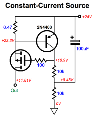

Thanks, Joe. Just for information purposes, here is a Broskie CCS circuit which is of similar complexity to his shunt-reg.

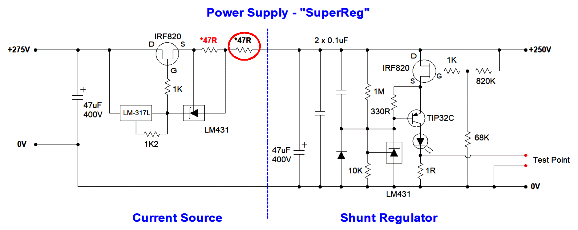

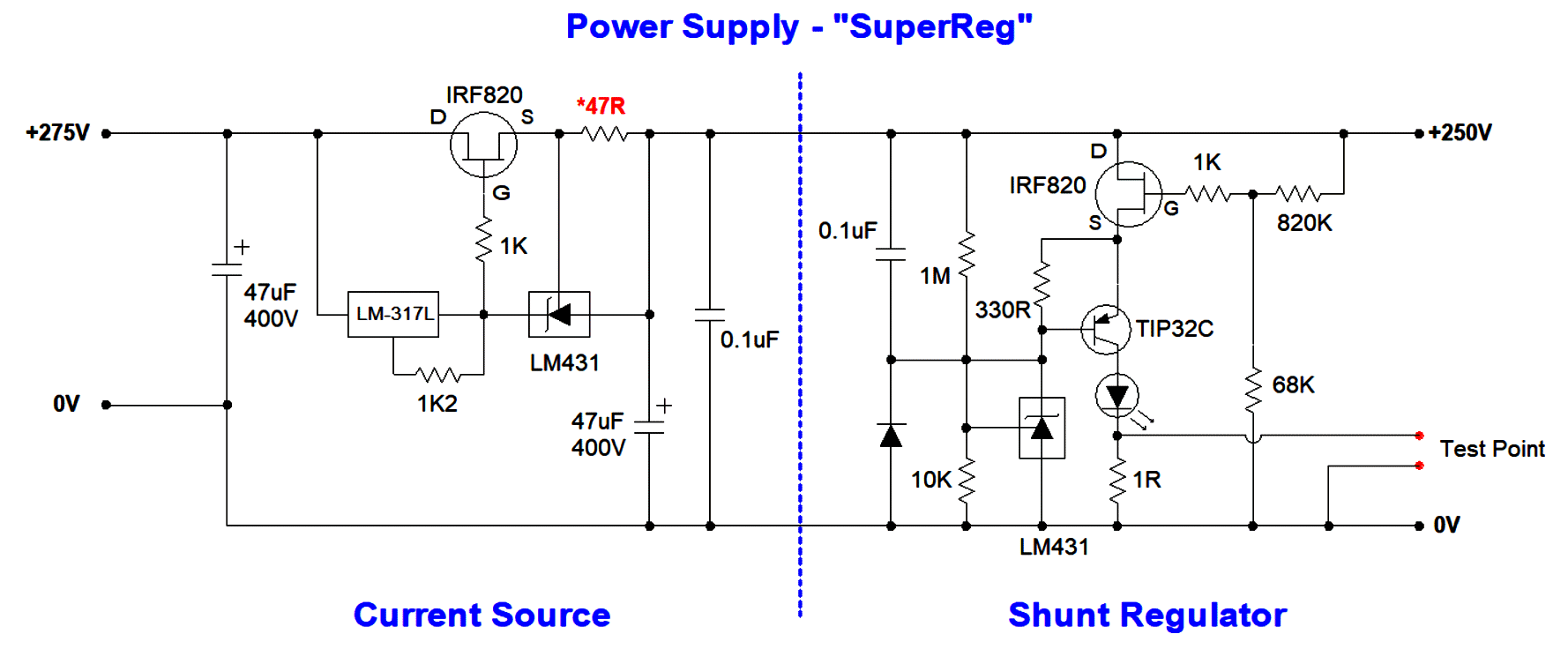

Joe, what did you make of Allen's "LM317 begone" modification for the SuperReg? This was in the same position where you have the TL431 in the CCS. I took the LM317 out of all four of the SuperRegs I built, but didn't check for oscillation before or after. Is there something intrinsic about the LM317 that makes it prone to instability, or is it just in this position?

Hi Alex
(Please note that the LM317L in the above schematic performs an entirely different function. It only handles 1mA going through the LM431. A resistor could be used here, such as 22K = 1mA approx.)
Oh boy, it is such a long time ago that I was discussing this with Allen and this only now you brought it back to me. Yes, getting rid of the LM317L and replacing it with a resistor as you did, that solved a potential stability problem. Yes, it is the position that the LM317L is in, you are right about that.
I felt that a different solution was required and I spotted something in the LM431 datasheet that gave me the idea of coming up with a better solution than just replacing LM317L with a resistor (a resistor makes the circuit a lot less tight DC wise).
So what you see above is my solution to the problem. In the original circuit, the LM317L saw all of the current going through the HT HexFet. I identified that as the culprit. Using an LM431, the current now goes through a resistor and it does not go through the LM431. An elegant solution.
There is another thing I would add to the above schematic and so have amended it below:
If you have 2.5V voltage drop across *47R (=50mA approx), then another series *47R will drop another 2.5V. This value is not critical, just make sure that it drops a few volts. Note also that it is on the Current Source side.
Please note, some aspects of the above circuit needs to be tested by actually building it.
I see, looks like an interesting variation to study.

Thanks, Joe. I see - the LM317 provides a constant current for the LM431, so stabilising the voltage reference, whereas Allen used it in series with the MOSFET to supply the gate voltage reference. I recall Emile Sprenger did something similar in his HPHV.
Alex
Yep. But I admit that using the LM317L to provide a constant 1mA to has a drawback, the voltage must be under the max 40V rating. That should not be a problem with +275V input and +250V shunt regulated. If larger voltages are present, then you will need to use a resistor, so if for example you have +300V, then you will need around 50K to give you 1mA. That 50K degrades the performance (maybe not by a lot). I seem to recall that Allen went with very high resistance values because there is no Gate current on the MosFet.
Do you have the schematic there that shows what you did when you got rid of the LM317L? Did you increase the resistor value(s))?
Right. I believe the stability issue when the LM317L is related to the MosFet as they both see the same current. MosFets have capacitances issues. But my solution using the LM431 solves that. Alas, I am sure that Allen would have approved of this idea.

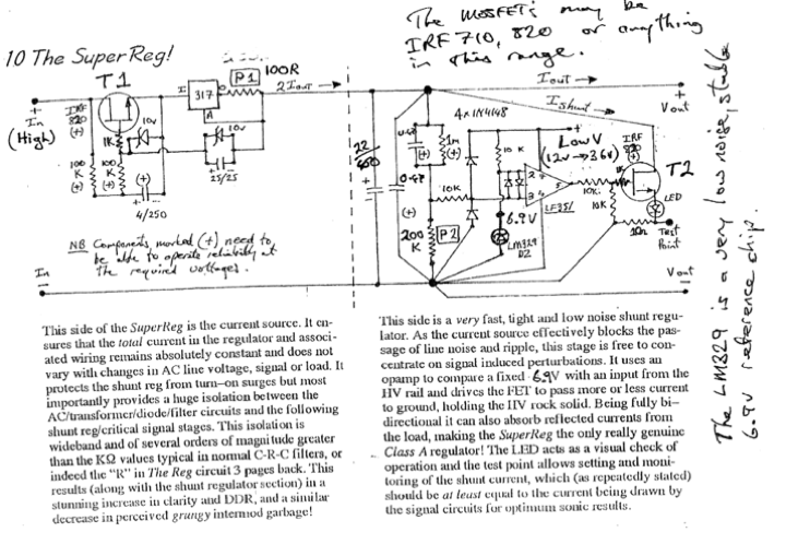

The Begone Mod consisted of measuring the voltage across the LM317, then replacing it, along with the 100R current sense resistor. with a resistor whose value would give the required current at that voltage.

Yes, and if we want to not use the LM317L and we have something like +300V input, then we can't use it anyway, so in that case go something like this:
NOTE: NOBODY NOTICED THE ERROR IN THE SHUNT REG - IT WAS CORRECTED THIS TIME.

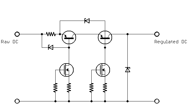

Here’s a interesting simple BJT cascode CCS circuit which I don’t believe I’ve ever seen before. I stumbled across it in the below linked thread. The biasing FETs are depletion-mode, so they could be either JFETs or small depletion MOSFETs. Raw supply voltage will be rather limited with most JFETs, though. The Zener on the far right is just there as the shunt voltage regulating element. Obviously, it could be replaced with something a bit more sophisticated.
