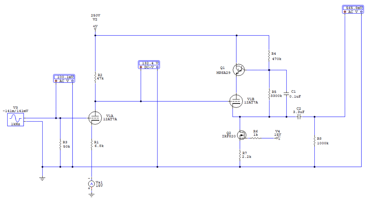

I have another project in mind that requires +100V and I changed values for +250V and it looks like below.
NOT YET BUILT - SUGGESTED ONLY:
A couple of explanations. The LM317L sets up 1mA and all the current goes through that LM431. This is better than using a resistor. It means that the added 1mA to the end result is also current sourced. The TIP32C redirects the current, the (red?) LED does mean that it is limited to 20mA in the shunt, but without the LED it can sink quite high currents, use appropriate heatsinks. The *47R needs to be adjust as per current required. Allow up to 30mA for the circuit and 20mA in the shunt.
I used 22K here instead of LM317L, but on the surface it does seem it might work. The 0.1uF I would use X2 class polypropylene. No values above are set in cement.
Any suggestions and critique is welcome.
Dear Mr Rasmussen, I'm delighted to see that Allen Wright continued to improve his FVP design. I received (eventually) his TPCB, and the FVP has given me some good ideas on how to build my own customized preamp. I'm particularly grateful for this update and possible improvement of the SuperReg, and the warning about the non-linear gate capacitance of the constant-voltage mosfet employed in the SLCF. I have had to forego the SLCF, as I wanted the line stage to drive headphones in stand-alone mode. As I'm still in design mode, all your suggestions are particularly valuable. Thanks also for your personal photos of your time with Allen.
