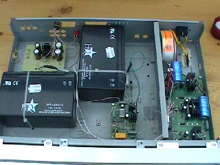

Battery power supply
Hi Sugarn,
I've done it! I've build a battery power supply with two 12V 7.2Ah batteries, automatic loader, over charge protector, general protector and automatic switch, and manual switch.
Both supplies are installed, so regulated supply +8V and -8V for the analog stages, and the unregulated 12V for the digital circuit.
It's in an identical case as the player but with a custom made face plate. This just came in this morning and is not yet installed. I'll have pictures posted later.
All caps in the regulated supply are BG's (Standard and N's). It's still running in, but innitial sound is already a big step forward, what a depth in sound stage. Previously I switched now and that from upsampling to non-upsampling because on some discs I found the sound to upfront to harsh, that's completely gone now. Really relaxed and analogue sounding player with plenty of sound stage and detail. Very smooth top end and pronounsed bass.
I can switch the supply to load by hand or it will automatically switch to load after putting the player into standby mode. It will also switch on again after the player awakes from standby.
I'll post pictures this weekend.
Anyway, thanks for your help, after you discription it was very easy to connect the battery supply.
Best regards,
Saffier
Hi Saffier,
Good to hear that you've successfully installed linear PSU and you're happy with the result.
I'm planning to try replacing opamp output stage with tube output stage. Maybe it will improve sound to more analog and more hi-end.
I'll post the result when I'm done.
