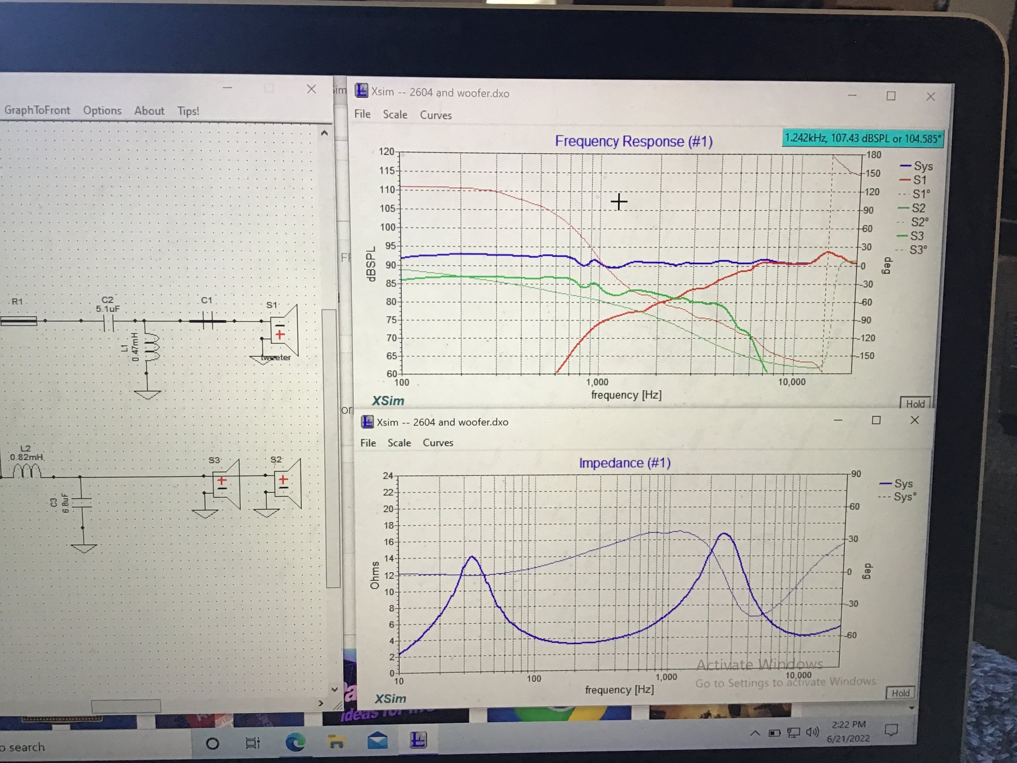

No, but it's a good exercise.is this what you guys kinda do when designing a crossover?
choose drivers and then ‘ play ‘ with XSIM with component values that are reasonable ?
No.and to have the Impedance smooth?
At this point see if you can get them even and complementary, like a LR filter. Enable phase for the separate ways and turn off system phase.is that a really bad design cause the rolloffs are really shallow?
Ok like this?No, but it's a good exercise.
No.
what do the phase dotted lines tell me for both the tweeter and drivers ?
thanks man. Pardon for all the questions
Think of it as kind of a timing relationship.
so ultimately how should they look on the graph?
as close to each other on the crossover point?
or as close to each other in general over all freq ?

i thought the resistor doesn’t count as an order
The electrical order of the filter should be distinguished from the acoustic one. It is usually acoustically higher for the tweeter because the driver has its own slope. The final result is important, ie the acoustic slope obtained by summing the filter slope and the driver slope. The same is the case with the phase, the filter phase and the driver phase are added together.

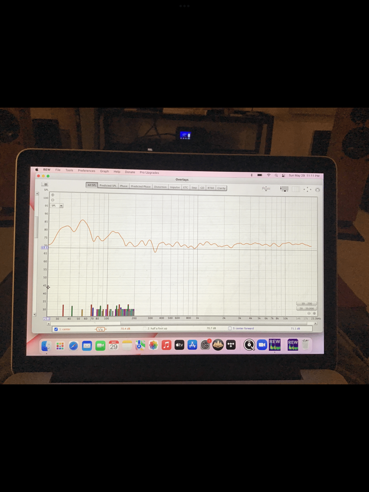

so obviously my speakers have a bit of a bbc dip most likely from now short they are
when the mic is placed lower the bbc dip goes away.
first pic is with the mic lower and the second is with the mic higher.
is there any way to compensate for that on the xo?
the one capacitor on the tweeter is 8uf
and on the woofer is 16uf
if I make them 10uf on the tweeter and 14uf on the woofer this will raise the dip a couple dbs I think. Off axis that is.
is this correct?
It's a matter of phase, we already discussed that topic when you published the first measurement. Try two things, raising the speaker on a stand or tilting the speaker a few degrees backwards.
yeah I’ve done both.
im assuming that’s the drawback of an MTM design on the vertical axis
thanks man

Any crossover setup will generate some form of vertical lobing. I'd have to sim the design to be able to predict the vertical polar response for this system. You could tilt the enclosures just a little bit backwards if the dip bothers you.so obviously my speakers have a bit of a bbc dip most likely from now short they are
is this correct?
