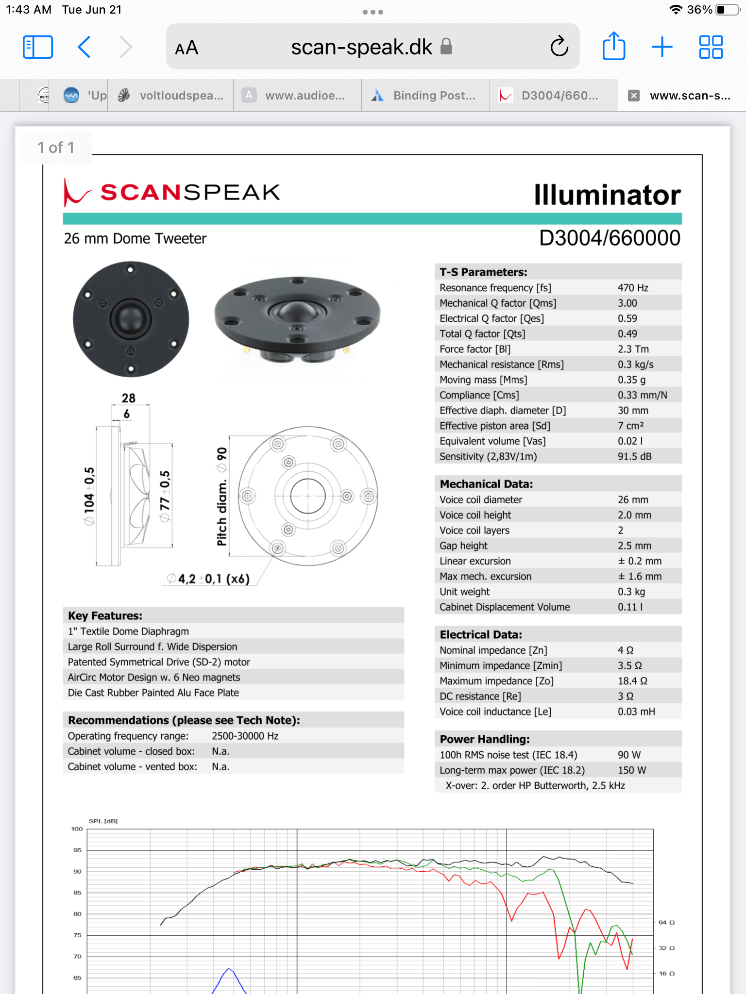

Why are you switching to wattage specification? 2.83 volts is a whole lot easier to compare apples to apples.Now I found, all sensitivity data are given for 2.83V / 1m. Since the drivers are 4ohm, that means -3dB for 1W / 1m. In that case the old driver is 89dB 1W 1m and the new one is 91.5 db 1W 1m. So I say try 1R5 first and if it's too harsh, go for 1R8 or 2R2 resistors. It also depends on those capacitors in front of the tweeter. In principle the better they are, the brighter they sound, although not in all cases.
it was the wrong tweeter anyway.
the tweeter I have now is 92db and the new one ( 3004/6600) is 91.5db.

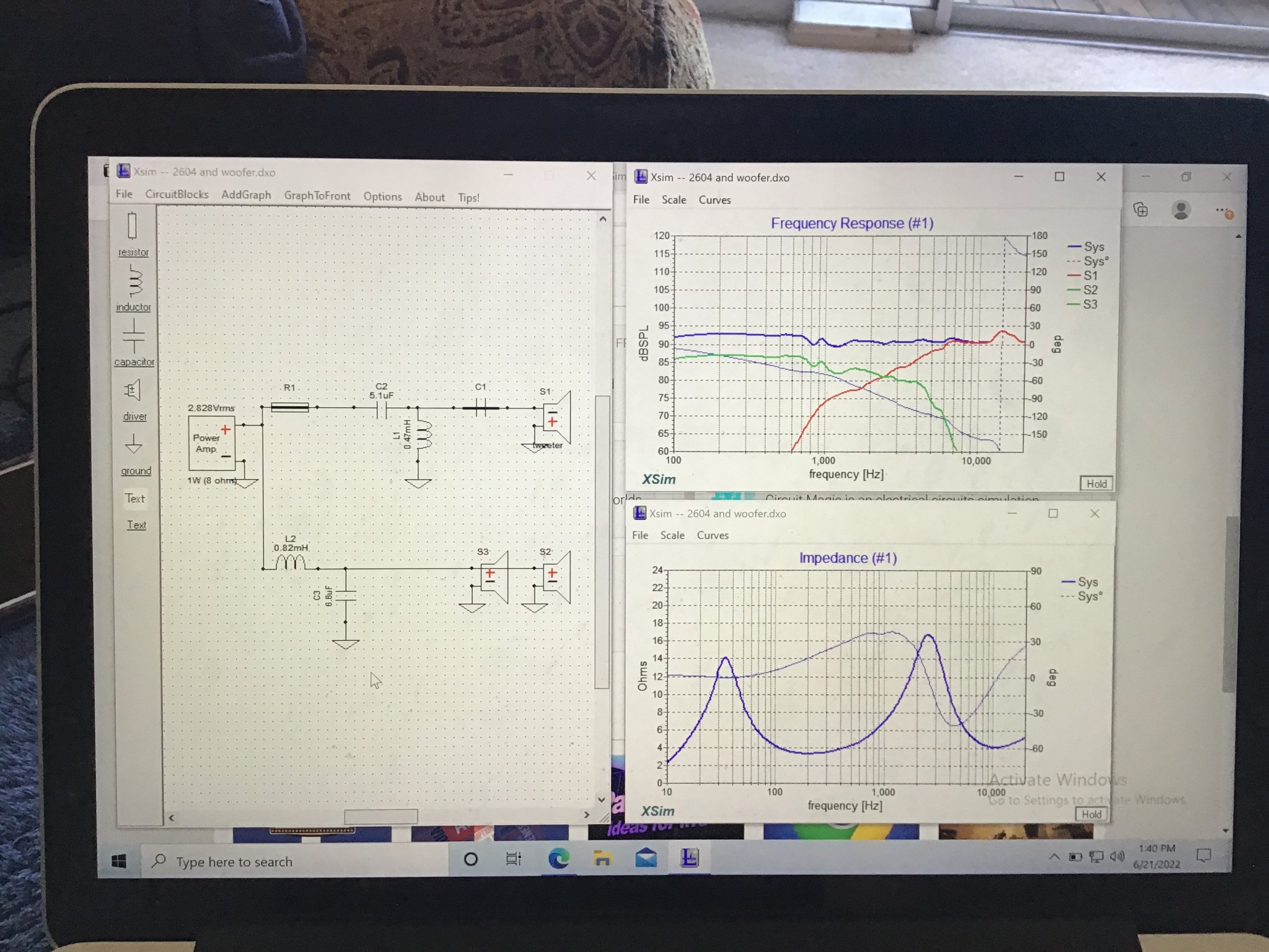

i did the simulation in XSIM and the resitor should be lowered from 1.5ohms to 1ohm to give a similar response.
of course I need to learn what xsim shows and what happens in the real world.
so, as a result I will put in the 1ohm resistor listen and take measurements to see if the highs blend smoothly with the rest of the freq at the xo point.
if the tweeter is playing higher or lower I need to adjust so they can be as seamless as possible.

the datasheet for that tweeter and actually my current tweeter recommend a 2nd order Butterworth high pass filter.
but Im pretty sure the filter in my xo is 3rd order.
is this correct from the pic attached of my tweeter circuit?
What you have looks 4th order.
i thought the resistor doesn’t count as an order
It doesn't. The tweeters natural rolloff does.
Consider.. that recommendation you read mainly is to protect from overexcursion.
thanks
so they recommend a -6db slope by saying 2nd order Butterworth?
mine has more of a 12db rolloff

The manufacturer recommends at least a second order filter, that's 12dB/oct and it makes your tweeter close to 4th order, which is 24dB/oct.
hey Allen,
is this what you guys kinda do when designing a crossover?
choose drivers and then ‘ play ‘ with XSIM with component values that are reasonable ?
oh and to have the Impedance smooth?
like the below?
or is that a really bad design cause the rolloffs are really shallow?
