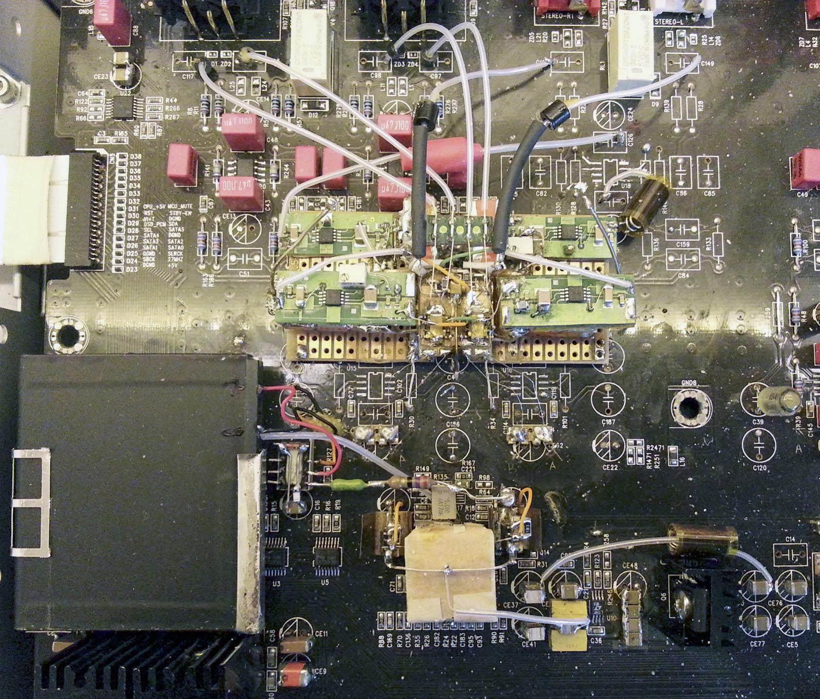

Now is done for 95: clocks, processor 25Mhz and 125Mhz DAC, are powered direct from batteries (each of 1,6A/h). Simple battery managing by relays and an simple too charging system (TP4056) is also in place. When player is off, the batteries are in charging mode. The switching PSU of the player is always on for 5v. Exactly what is need it to charge my batteries.
The 125Mhz SAW oscillator for ESS9018 it take 30mA. I have run it this oscillator on battery since it were full charged (4,2v) and until the oscillator it stopped itself because to low power (approx 3,6v). No any modification in the quality of the sound out of the player!
It seems that this oscillator have an internal regulation system for its power. Even though this quite big variation for tension at its power pin (3,55v - 2,9v), I couldn't notice any change in the high quality of the sound. I used the player an normal number of hours ON, for more than a week without charging the battery.
Charging the battery regularly, when player off, it maintain the battery voltage variation for normal use in between 0.2v.
This system it works very fine and the oscillator it support well the power variations in those limits (specified also in data sheet).
The another oscillator for processor it use 6mA, and so, its power variation is more near to an almost constant level delivered by battery. Absolute no any problem too, with this 25Mhz oscillator, because the battery tension variation...
Those facts make me think that is not so important the very constant level of the power/tension when is used an voltage regulator to power such oscillators, but how much "quiet" it may be that regulator. Anyway, the battery is the most "quiet"...

a slow difference that happened over a week of time? thats never going to be easy to hear; but anyway clocks have pretty much constant power draw so it will just work till it doesnt. I dont think it will have a regulator...
so which was it? or you have a passive filter after the battery that lowers voltage?
BTW, you might try twisting the output wires... as they are, they are both receiving and transmitting noise due to parasitic inductance. but of course you will say you dont hear any noise, so it must not be happening. twisting balanced wires is a very basic requirement to allow the CMRR to work properly. you dont have a ground wire with the SE outputs? they will also act as antenna.
for someone that goes out of his way to replace everything with SMD parts, you dont seem to care much about inductance or loop area.
In first quoted phrase (4,2v - 3,6v) it is about battery voltage. The second one refer to the voltage at the power pin of the oscillator.
There is an resistor in between battery and oscillator Vcc (as you can see in the picture + a fuse) to lower the tension to the specified levels for oscillator, and limit the current to the max specified too.
I was enough surprised to observe that even the quite large Vcc tension variation at the SAW oscillator pin, I could definitely not register any change in the quality of the resulted sound... Or I can say that the SQ improvement it were obviously over all this tension level variation, until the oscillator stop it self because to low Vcc.
Charging the battery every time the player is off, reduce much the Vcc variation. Everything is fine so far! I plan to go deeper in this experiment (but using another board and hardware configuration), to find out what is actually going on.
There is right your observation about battery connection wires. But those are also short enough. In fact my worry is actually the large battery surface which it may capture better the noises as an antenna... But at last it is working all very well...
Of course, what you can see in the picture (battery powered) is not at all an professional designed circuitry. Is only experimental "construction". If I should design all this on an dedicated board, will for sure do not look like you see in the picture...
Else it is used the ground plane of the original design, and the battery -/GND is connected with an enough big section silver wire to the oscillator GND point. The rest of the wires there around, goes on the other side of the board and further to the charger(s). The relay separate all of.
No matter the lack of " professional design", the result is obviously: it sounds much better this way.

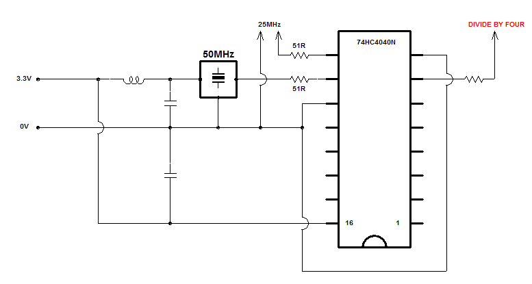

Yes, I know I should do it, and I just thought at that. I have bought actually the SAW 50Mhz oscillator. But... you know for sure that is not easy to work with that board... It were already an numbered times I have mounted/unmounted that board, and at least I got tired to do this... I just want to have that player mounted/working as is modded per today, to go further to the 105 model.
I have an quite good specified 25Mhz Fox oscillator there, so I think it will be to try an 50Mhz SAW another time...
I think to try/change that 25Mhz oscillator after I will get the 54Mhz one. They said will ship my SAWs 54Mhz batch in April.
So the plan is actually change out both oscillators which it clock the main processor. Then I hope I will be finish with 95 model...
no i'm not talking about them, i'm talking about your IV output wiring connecting to the XLR and RCA outputs, its quite literally a large antenna and without twisting the wires, you not only lose or significantly degrade the CMRR that is the whole point of having a balanced system, but they become a big receiver and transmitter of noise and its not small, it will make quite a nice pure silver antenna connected to your most critical analogue stage, it will pick up any RF the clocks put out and transmit its own, the RCA especially. twist the +/- dac XLR output wires and give the RCA a ground all the way and connect at both ends, not just from one end for a short portion before the ferrite. youve made the loop area of the outputs about as large as you could possibly do, it should be as small as you can possibly do.
Well...I know how you think, and I agree with the theory which is based your above comment on. But...
There is about few cm wires to connect the DAC to the RCA. There is about very low impedance output from the opamps... Induced HF noises in those few cm output wires, and then further through cables to the amplifier???!!! How high level it should have those "noises"? Volts?! What it happen with those noises further? Get in to the amplifier and it will be amplified?! I never experienced an audio power amplifier which is capable to amplify in radio spectre. Did you? So, that supposed volts HF noises will be amplified to tens of volts further by an audio power amplifier??!!! All this it sounds like "mad science", don`t you think?
Now about facts: I measured what is coming out from that RCAs. I have there 32mV which are residual HF noises from the DAC chip. Those noises are in few Mhz spectre and are right at the opamps outputs 680mV (I have no any filter in between I/V and output buffer). I succeed it to reduce (no filter) this HF noises to that 32mV on RCA point for an usefuly audio signal of max 13-15Vpp.
Further, my RCA cables are not twisted at all, and even "worse", not even shielded... Can you imagine? At least are not very long either. Only 30cm silver wires which get right in to the (one stage) power amplifier. I experimented a lot in this cable field, and I found that this way is best. My cable have now approx 20pF. Do you know what happen when is to shield a such cable or twist it?. You get at once more than 100pF on a quite short of such. I do not know if you can hear the difference between an signal through an 100 -200pf cable and an 20 - 30pF one, but I can. I can even assure you that is quite big in the favour of the low capacity one. I couldn`t find yet the theory to explain you why...
XLR connections are made, but I do not use it yet that output...
As you said before, you mean that I have a huge gain in my whole system. Maybe... but I think is just right how it is, to give me that performances I want to have from it. So, how you see in the picture, with those very degraded CMRR, huge ground loops, not even shielded connection cables, huge system gain, etc., I have absolutely no any noises out of that system, and it is sounds just exceptional. My improvements over years on this system it were step by step, on every component of it. It were corrected every fault or imperfections, and how it sounds now is the best I could get. I can only tell you that I`m quite demanding in this field...
