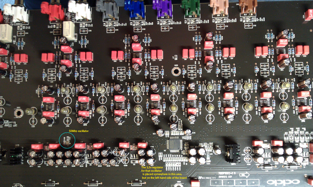

Do not worry about that 125Mhz. So how it is placed and soldered there, is the best way possible. Much, much better than on the original PCB placement. Its output is at only 2mm far from the input pin of ES9018 and is soldered directly on that pin. The decoupling of that oscillator is made under it directly on the chip tabs, between the V+ and GND. This is not to be seen on that picture. The GND of that oscillator is only 3mm far from the GND clock pin of ESS9018. The power of that oscillator (its own ultra low noise regulator) is few mm far from the its power pin (same GND).
You know something? If you should have a little knowledge about this Oppo player, how this audio board were designed by the Oppo high qualified specialists, you should remark by your self that the original 54Mhz clock oscillator used for ESS9018 were placed in original design at more than 80mm far from the target chips and it feed with clock signal both ESS9018 chips (placed at the middle distance between those DAC chips - see picture). The power and GND of that original oscillator is at almost the same distance far from that oscillator it self. There is a really mess made by Oppo`s electronic designers (engineers). But is a very nice looking board, symmetrical placement of the components, and so on ... Isn`t funny this? And this is is not the only one design fault in this high end player...
What I said earlier about "connaisseurs" is not just by chance... Unfortunately.

Hi Cortis, I know absolutely nothing about this Oppo as our DAC sounds better than the original outputs I never bothered to check the innards.
Don't feel bad about my comments. I just like electronics to function good, also look good and to have good soldering joints.
It makes me wonder why the design choices you describe were made by the Oppo engineers ?!? This player just asks for modifications. I now see you placed the XO very close to the ES9018.
