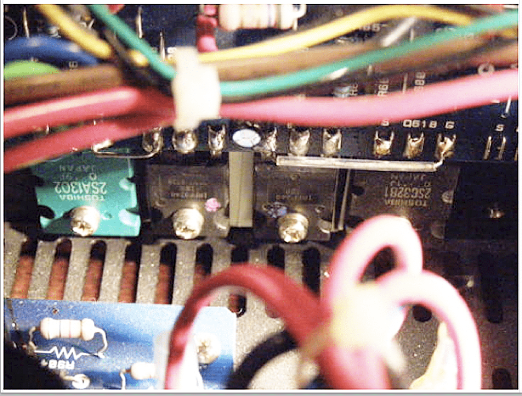

Also my thoughts, but wasn't shure: I assumed either there is something very sophisticated which I don't know or simply nonsense.I do not believe that connecting them together in parallel (MOSFET and BJT), and placing them in a circuit (as shown) -> is possible... at all.... ...wouldn't work correctly without changing the way MOSFETs / BJTs are driven....
Reduction of resistance. The device contributes to the output impedance.
Hmmm... now what?The TIPC isn't connected to the output line (there's no blob).

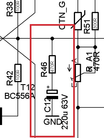

Just wondering, Would be any benefit in using higher value capacitors in an amplifier's driver stage? currently there are 220uF in the circuit, would be any benefit in replacing it with , let's say 1000uF capacitors?
I'm referring to the marked capacitors in the attached schematic.

Thank you for mentioning it.C12 also sets the low freq corner. If you increase it a lot, you'll get a lower LF corner which may cause very low frequency movement of the speaker and possibly LF oscillations aka motorboating.

Isn't the amplifier's LF corner 1.54Hz? please correct me if I'm wrong.

The way to calculate is first decide on the lower cutoff in your freq response, then calculate the cap value for that Fc against the resistor in series with it.

Way back, I saw this apparently done in a mod on an ebay offering and asked about it but didn't even get any speculation:I do not believe that connecting them together in parallel (MOSFET and BJT), and placing them in a circuit (as shown) -> is possible... at all.
https://www.diyaudio.com/community/threads/some-questions-on-an-adcom-5400.254229/#post-4085948

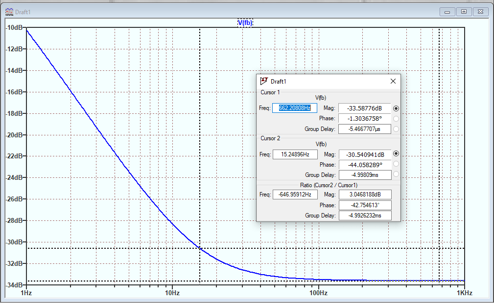

22uF for a 15Hz lower 3dB point is much more sensible.
The mind shudders with talk of an upgrade to 1000uF ...
See attached graph with 22uF showing a -3dB point of about 15Hz. (Assuming series R of 22k, hard to read on the pic).

Just want to add: this is already excessive, any rumble or LF junk will gobble up power and may damage the woofers. No idea who decides these nonsense cap values.

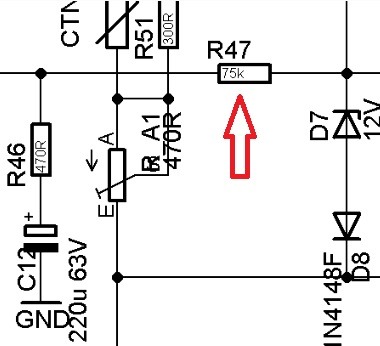

R46 is connected in series to C12, it's value is 470 ohm.
I was referring to the FB series R, they are often in the range of 22k, but I can't read it.
That determines the mid-band gain together with R46, as shown in the sim circuit I posted.
Jan
Jan
Are you reffering to the marked one?I was referring to the FB series R, they are often in the range of 22k, but I can't read it.
Jan
Just confirming🙂Of course, is there another feedback series R somewhere?
Jan
Well, it's 75K ohm.
