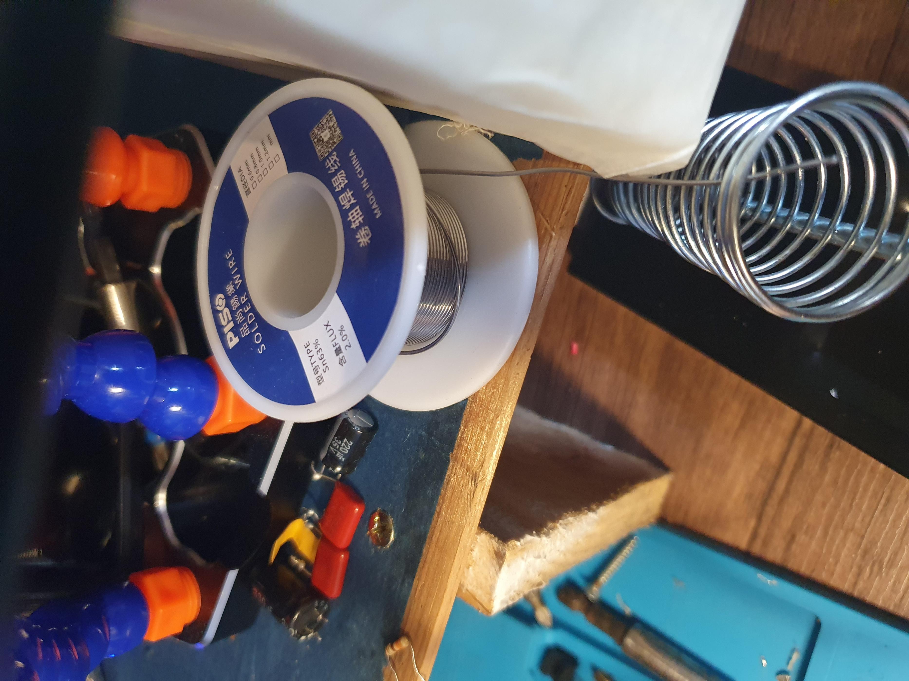

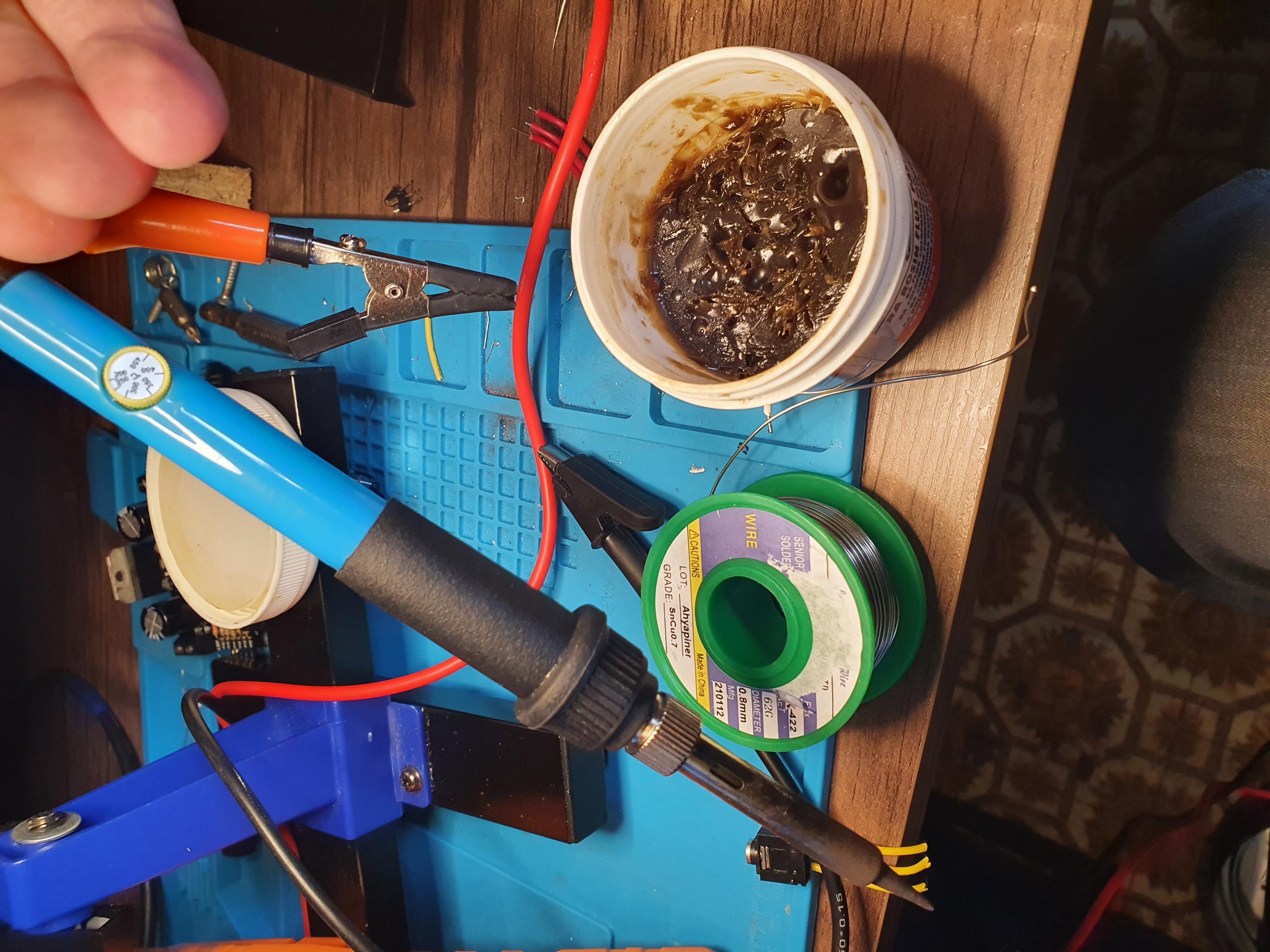

What type and brand of solder and where did you purchase it?
I suggest that you don't turn the iron to unreasonable temperatures. Set it to the right temperature. If it is not soldering a little wire and a little 1/4W resistor then find out what is wrong with the solder or what is wrong with what is being soldered.
I have not had good luck with Ebay/AliExpress/etc "brands" of lead free solder. (Your green roll of solder.)
I suggest a reputable name brand solder.
For now a new tip, the right temperature and the blue roll of solder (tin-lead) should solder wires and resistors without problems.
