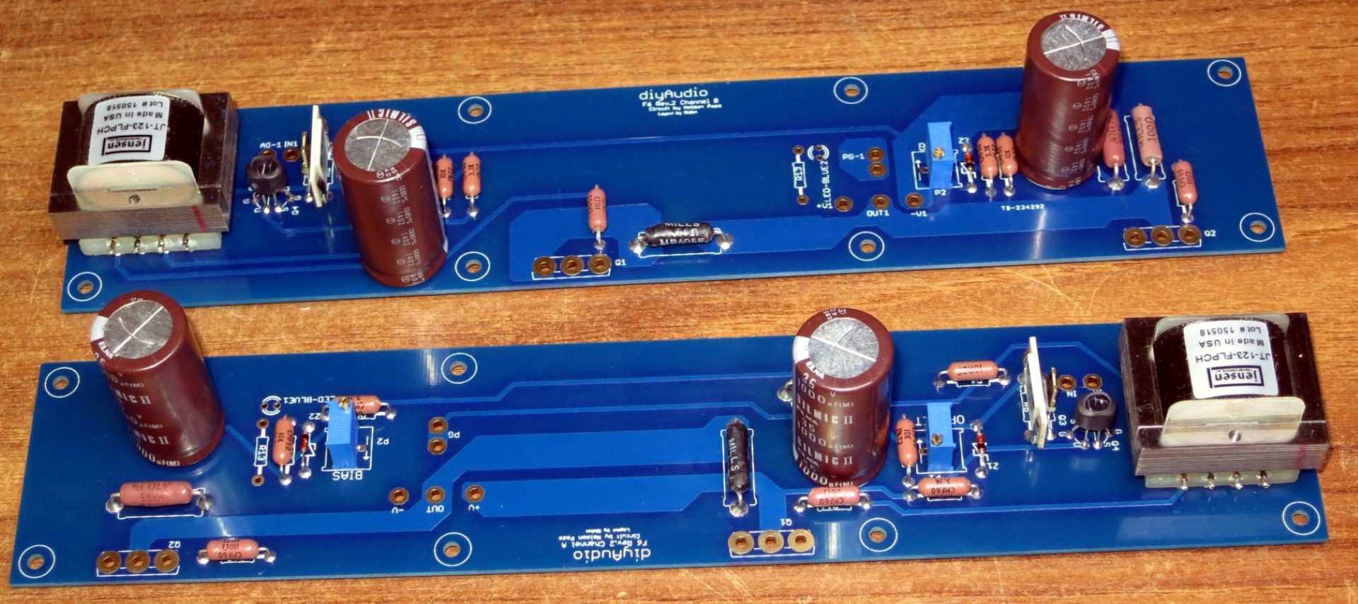

The Last of the components arrived yesterday and have been fitted

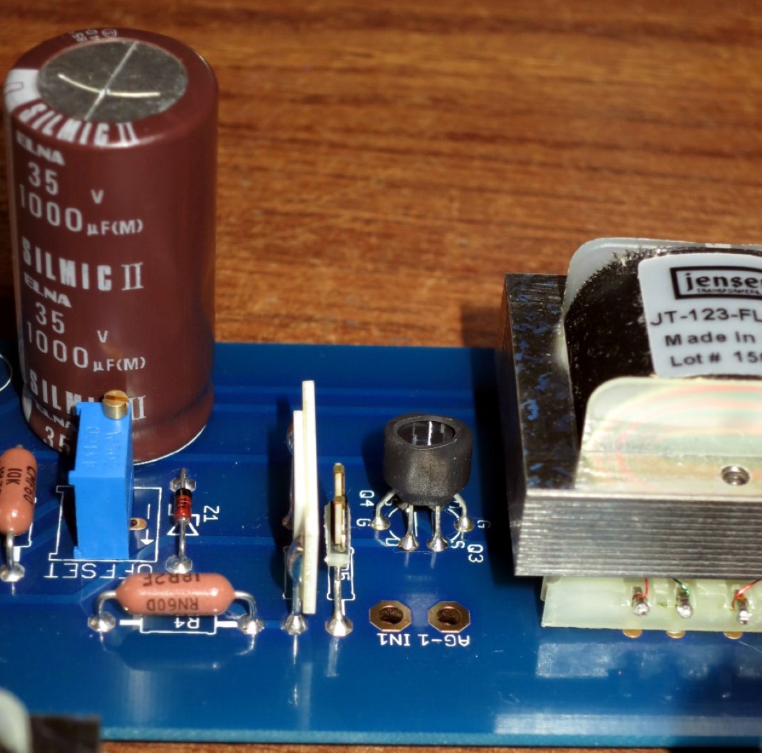

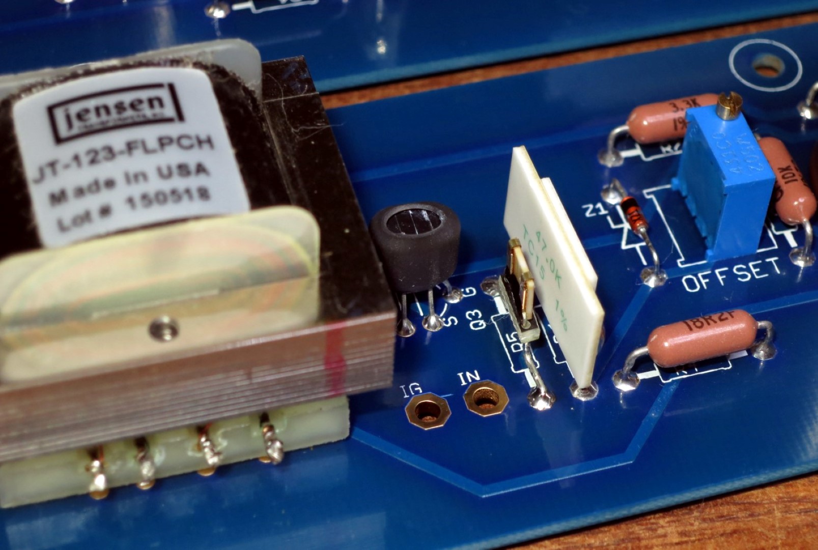

We used Caddocks for the input shunt resistors and Vishay Z foils for the input series resistor.
Chose this combo of resistor brands because that's what was available at time of ordering
Photos will show

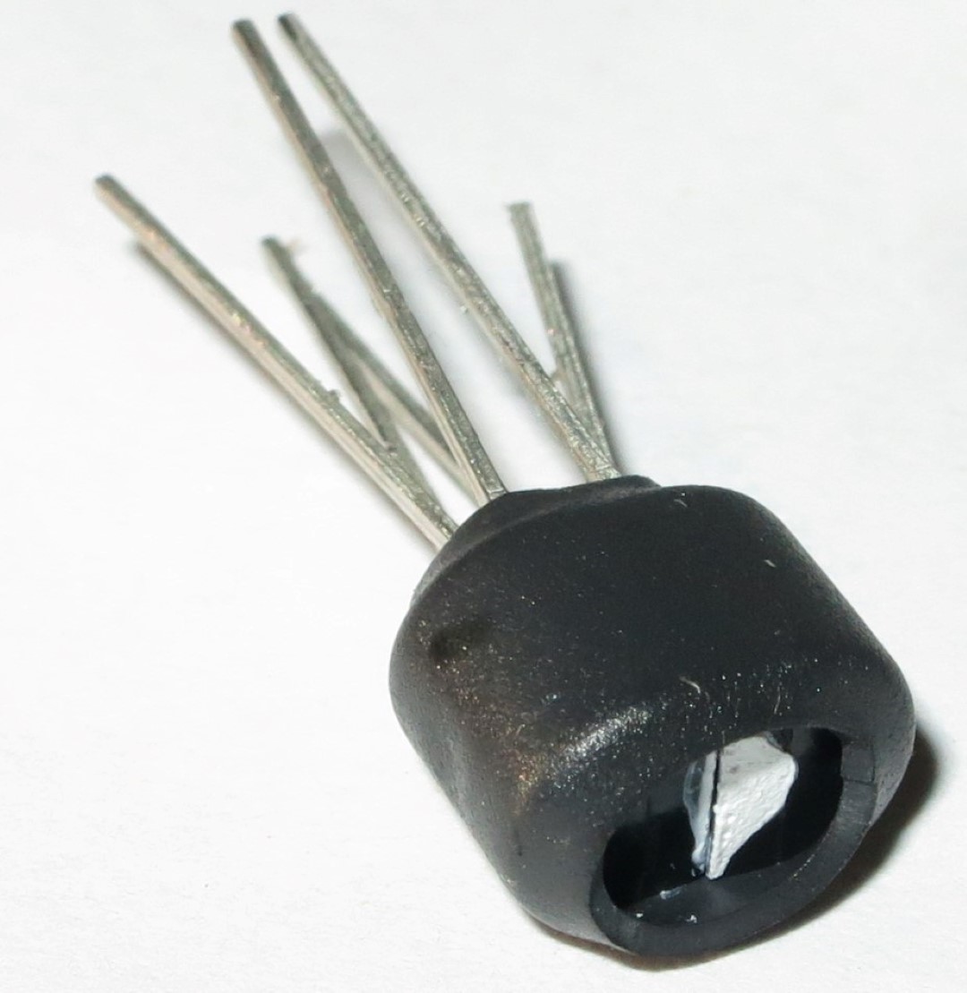

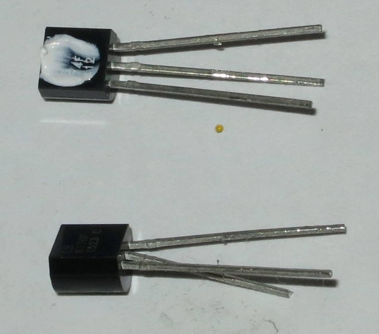

Smear of heat-sink grease on the input jfets before being coupled with
heat-shrink
Also the finished assembly of the PGBs.

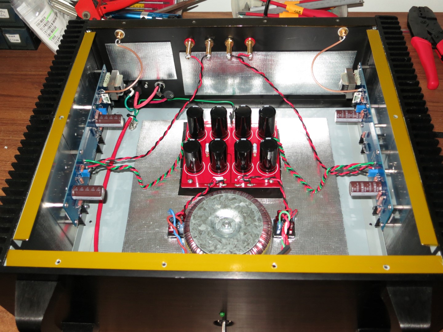

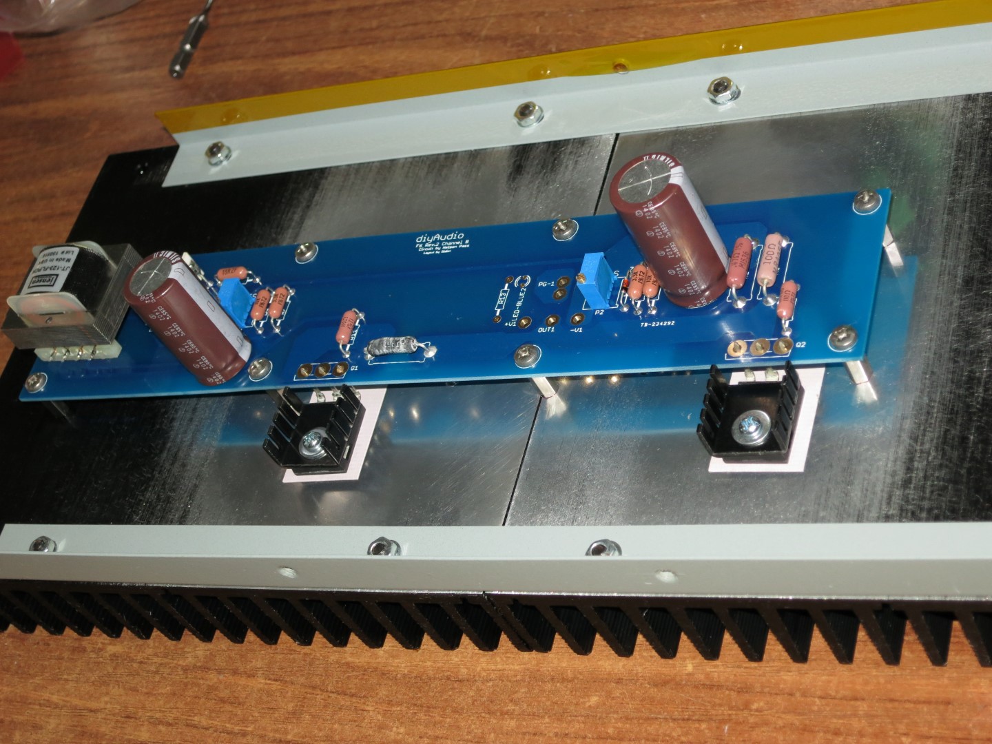

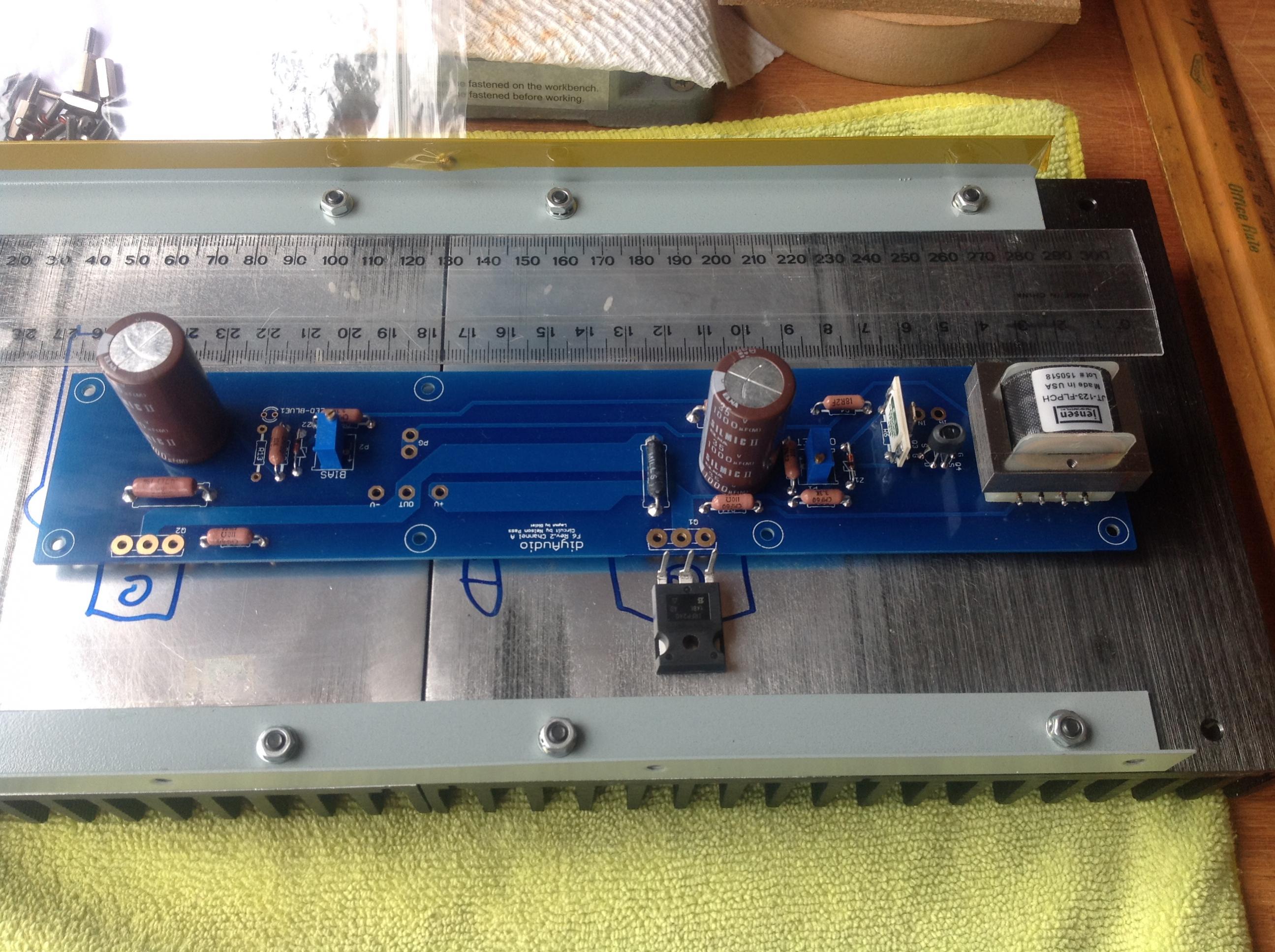

The next update on this thread for DIYers that a following

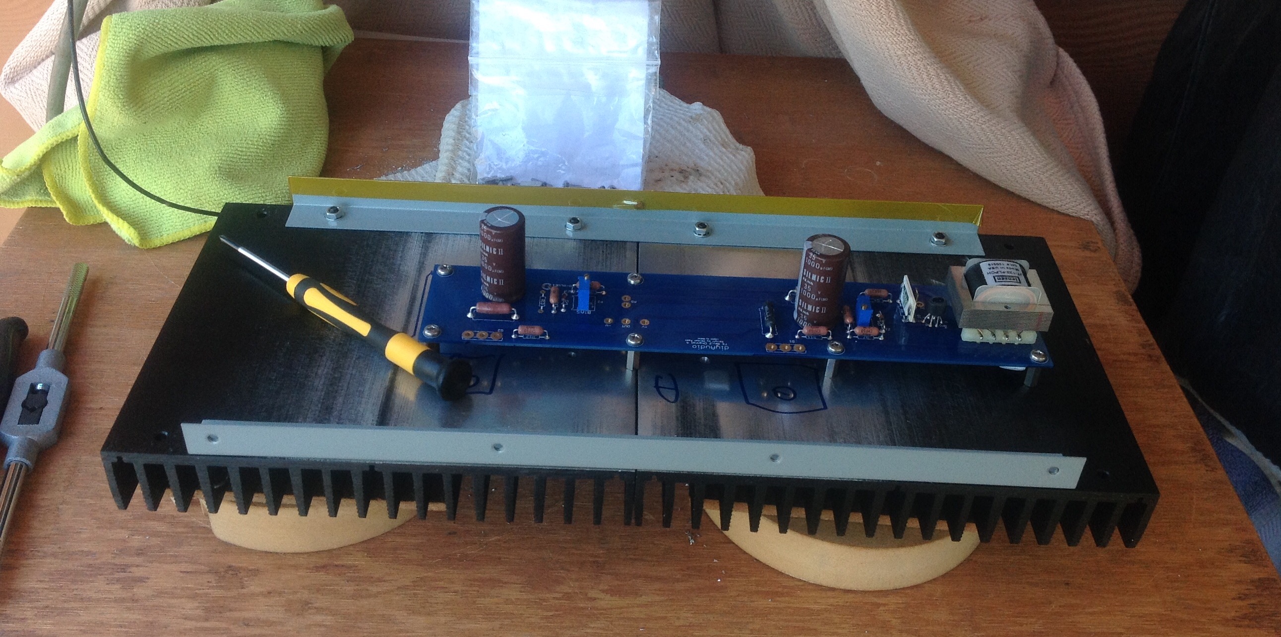

Previously I noted that the PCBs are complete with only the transistors to be done after possiioning and attaching the boards to the heat sink
For accuracy I used a hand drill press unit, I actually screwed the press unit onto a timber base for rigidity and levelled off the heat sink before driling the holes in
Then all holes were thread tapped with M3 X 0.5 pitch
I have elected to use Stainless Steel standoffs over brass
Mock up assembly was next
Afterwards all components were cleaned and fitted securely
Next update will be of the new wiring, removal of the soft start unit and tweaks inside the case

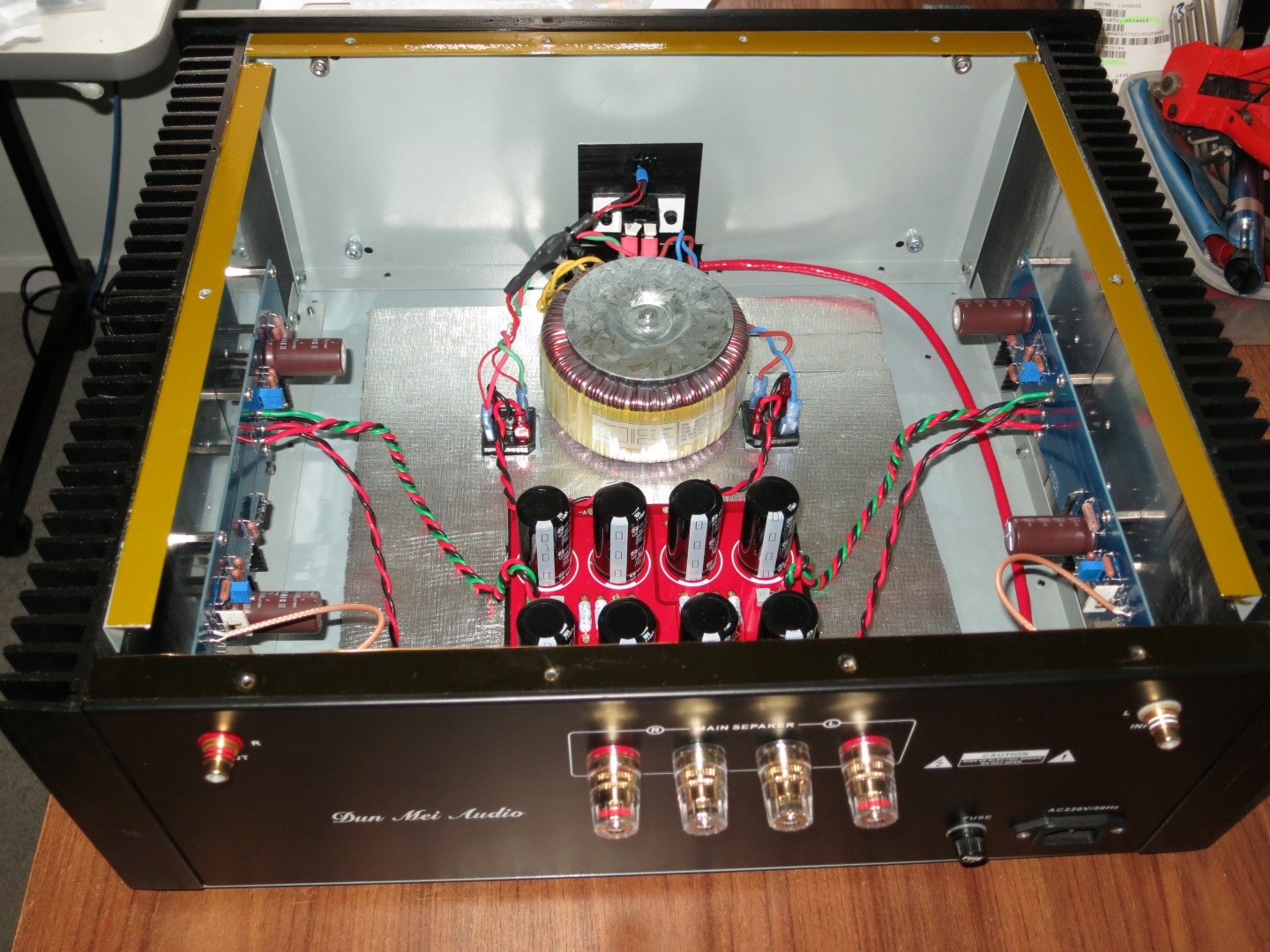

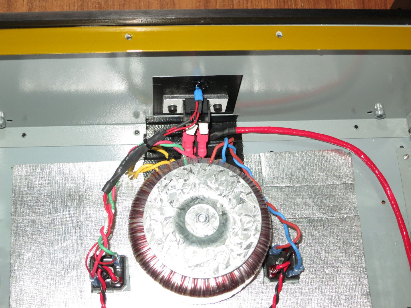

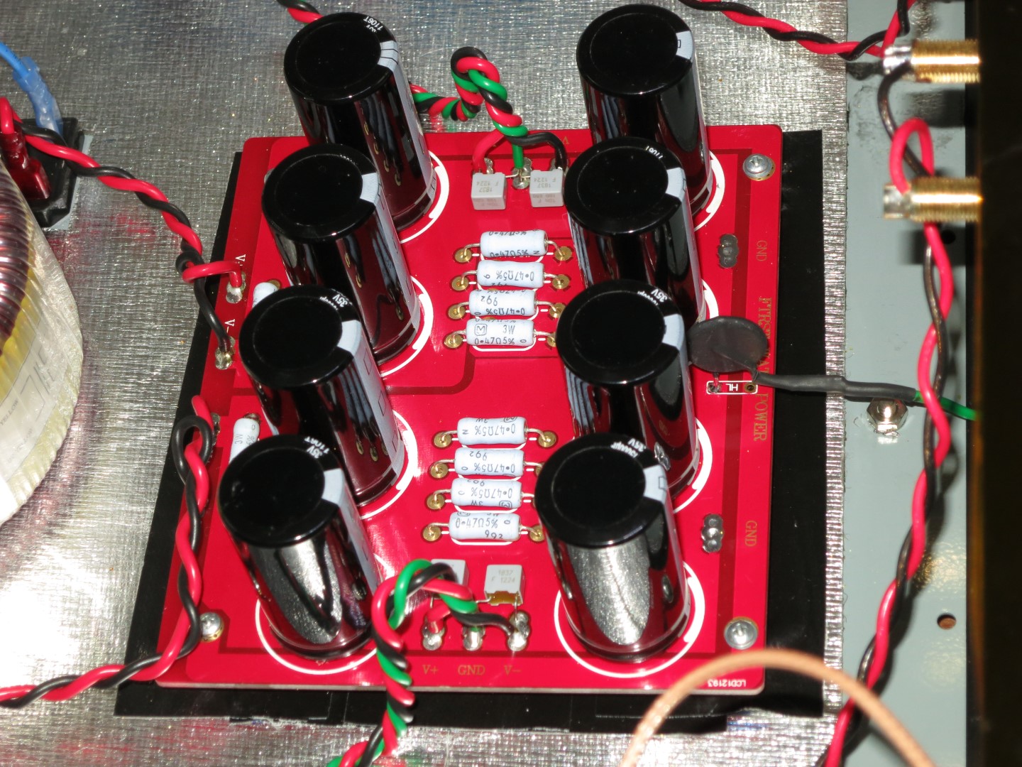

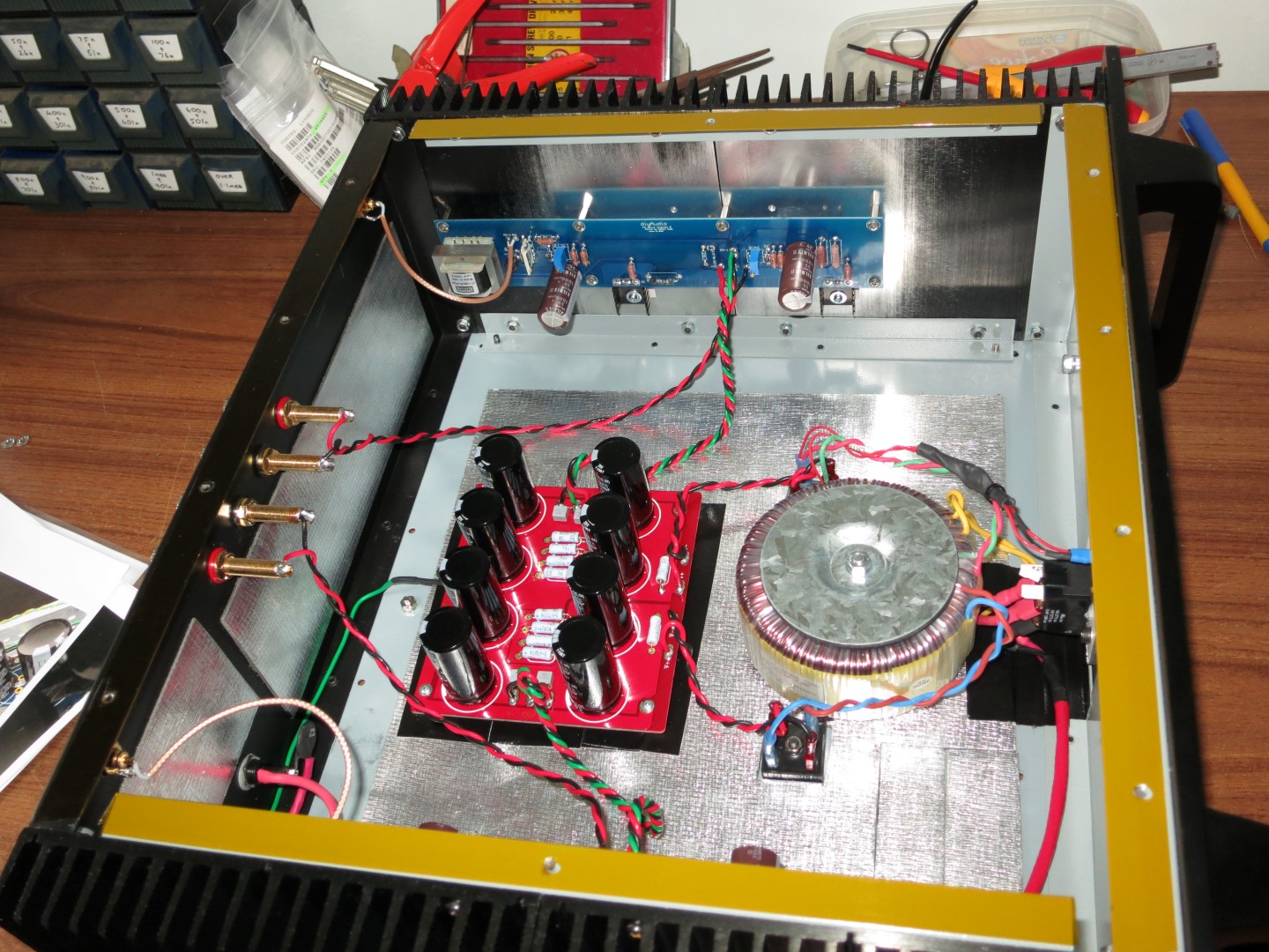

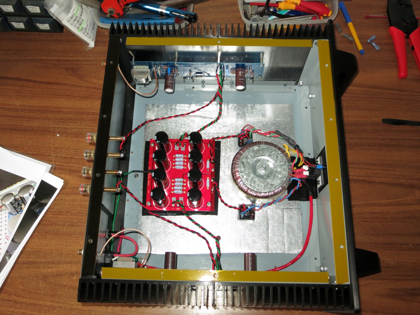

Sorry for the delay

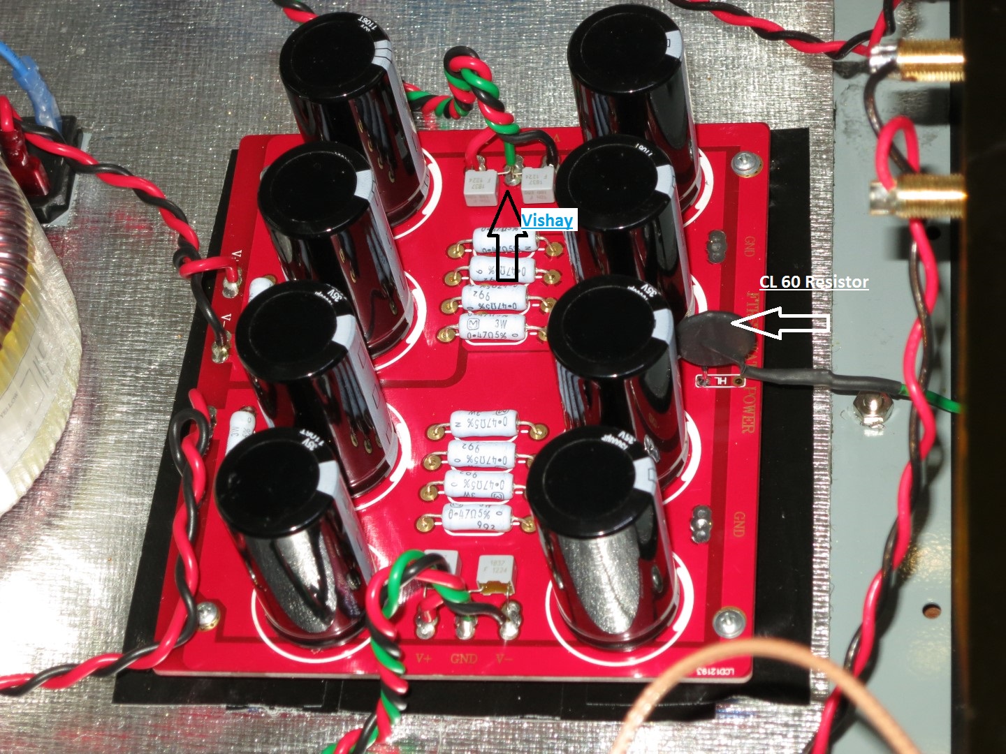

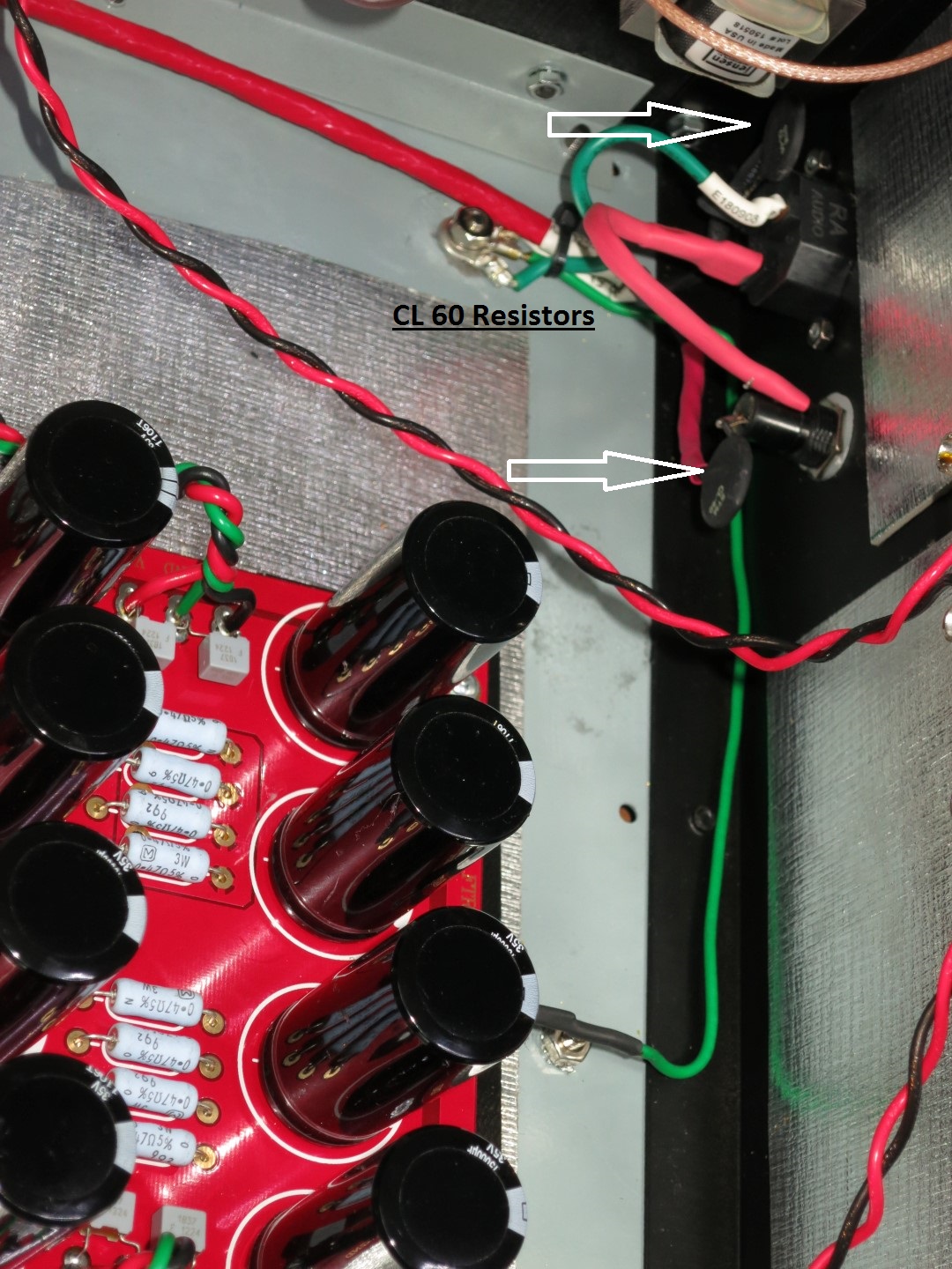

In these photos you will see that the soft start module has been removed and a new power supply wire fitted
The soft start replacement system with the CL60 Resistors

All new wiring is neat and tidy in its most simplistic way
Next installment will be measurements and listening reports

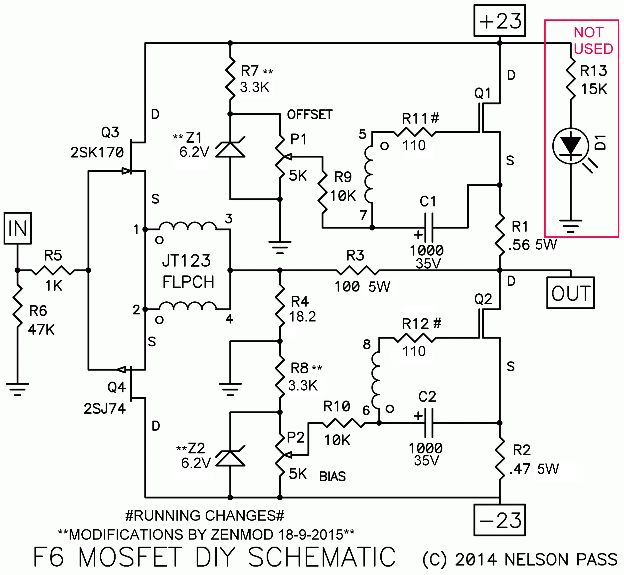

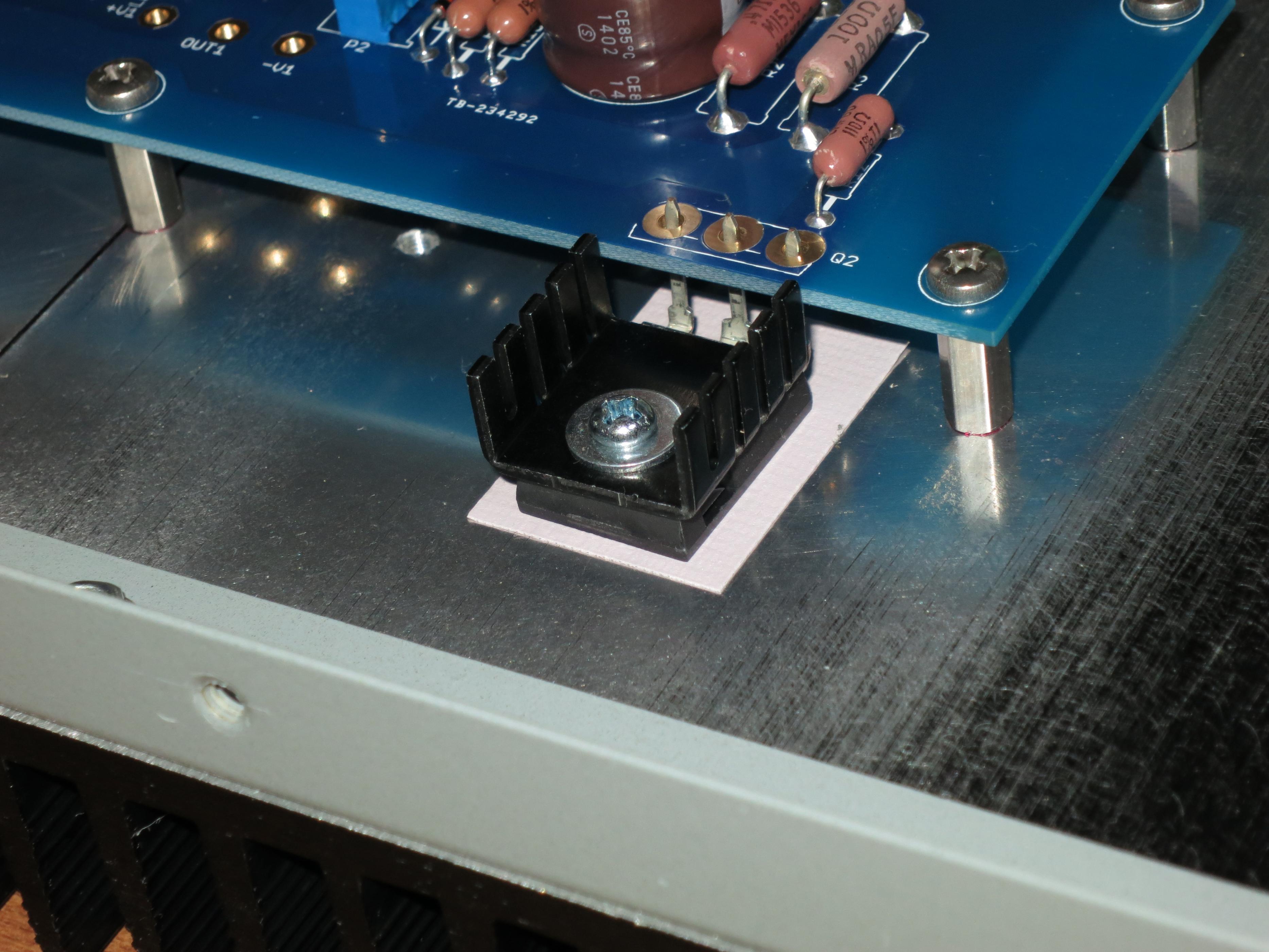

Bios and adjustments
At first we got no readings but we soon worked it out start turning the micro thread zenners
At first setting both channels have stabilized at damn near identical measurements.
bias left 497mv
bias right 496mv
Offset left and right under 1mv.
heatsink temp left 47.4
heatsink temp right 46.7
The right heatsink faces the door and there's a tiny bit of air movement.
So we guess that accounts for the marginal temp difference between channels.
ambient temp 27.7
temp delta left +19.7
temp delta right +19.0
Glad to be rid of that old soft start because it used to have a little buzz.
Now its beautiful silence
