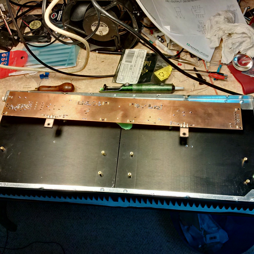

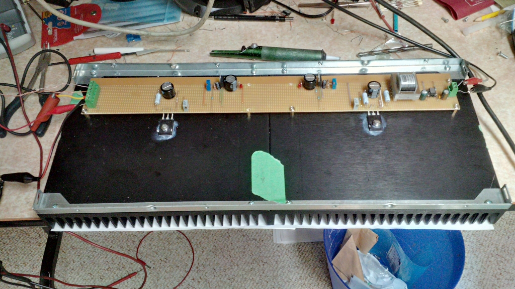

Since I have used the HA5002 high speed buffer as the front end of my F6 I included a regulated +- 20 Volt supply and simply took a resistor divider to generate the bias voltage for the Crees.
Have not done listening tests yet to compare the two but will report back soon.
Seeing Zenmod's post of the resistor change to 3.3K ohms make sense.
