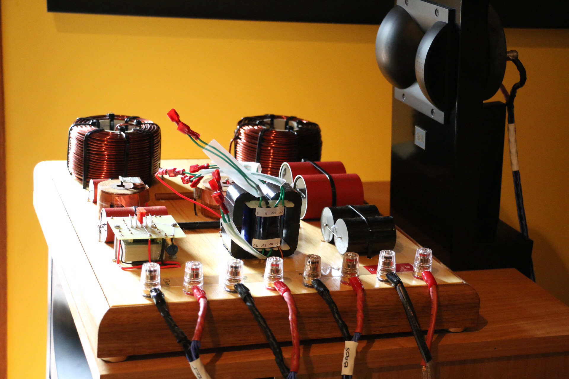

The attenuator system that I employ on my horm speakers are quite good and offer me a great tweak range no matter what amp I use ( see photo )
And I use 3 🙂

Impressive crossover. I have never heard an F5 so I cannot say for sure but I believe you will have more detail for sure with a better soundstage.

Hi Fullrange, does your autoformer in the crossover attenuates just the super treble or the "midrange plus super treble- horns"?

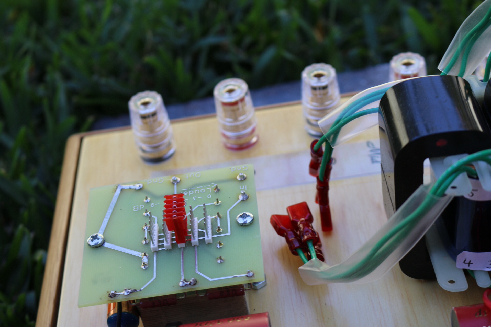

Hi Stefan
The crossovers have two seperate attenuators
One for the tweeter this one is a PCB based attenuator db steps are 0, 3, 5, 7, 9
One for the midrange this one is a double wound auto former with 15 wire taps X 1 db steps
Cheers

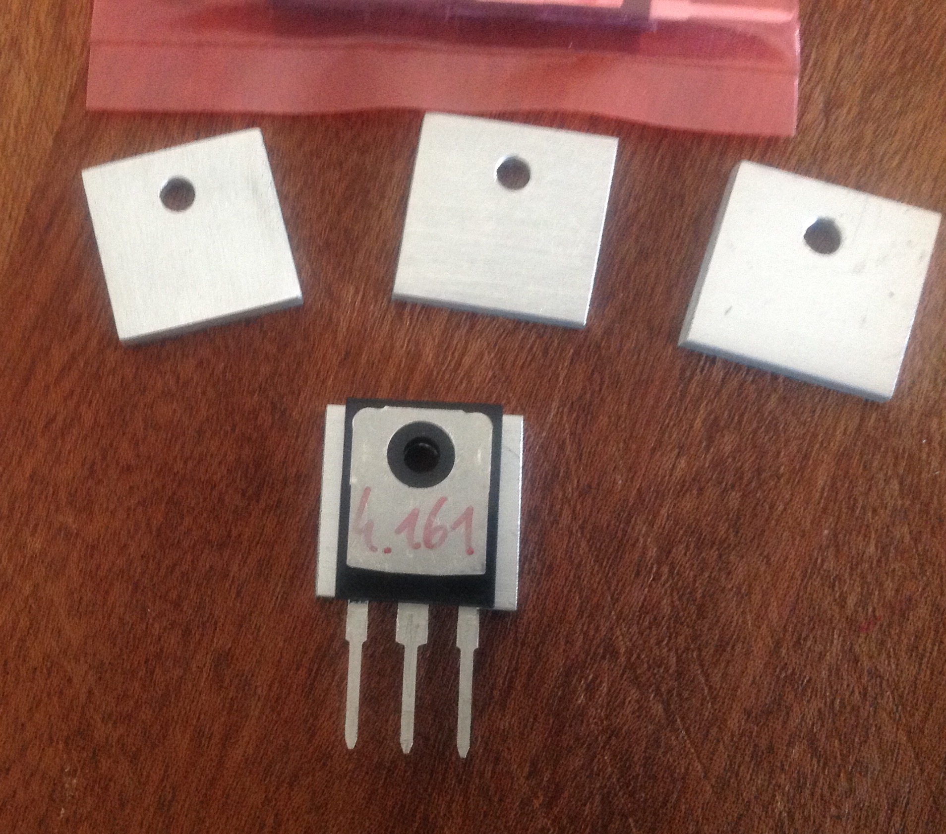

While I await delivery I got my hands busy and I made a set of 4 transistor washers
Material is 2 mm alloy
Shape is square and made to overlap the transistor
A small steel washer will also be used under the cap screw as well when the time comes to fit them to the heatsink

I like using these instead. Serve as a heatsink as well. 😛

Did not know such a product existed thanks for the recommendation
