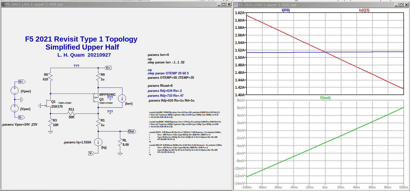

Yes, it was accidental that I had the source resistor in that example. Here is a similar simulation with both the source resistor gone AND the Q3 drain resistor gone. Wacko circuit self regulates no matter what. But, the idle current sensitivity to small parameter changes gets bad as those resistors get smaller.

X is different beast

The larger the value of R1, the more stable the bias.
I used 1.2R.
Patrick
1.2R is large in series with an output driver and a speaker load. Feedback will keep the output correct, but significant voltage headroom will be lost. Consider a 4R load with 1.2R in series. The speaker will only receive a maximum of 77% (4R/(5.2R) the possible voltage swing as with R1 removed.
As far as the amp is concerned, the effective load is (R9//R10) + RL.
If RL is 8R, then it is less than 10%.
I would be happy to have 0.6R more Zout and 6dB less H2.

You are correct for an 8R load. I forgot that the upper and lower parts combine to cut the additional resistance in half.
I guess it is a matter of personal taste whether reducing H2 is that important.
