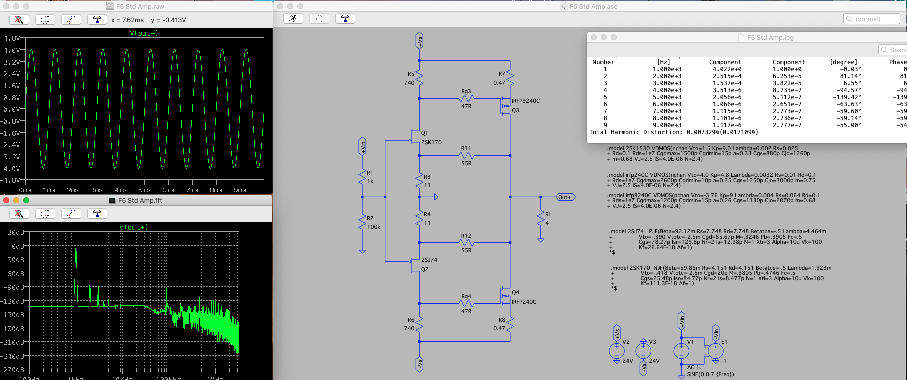

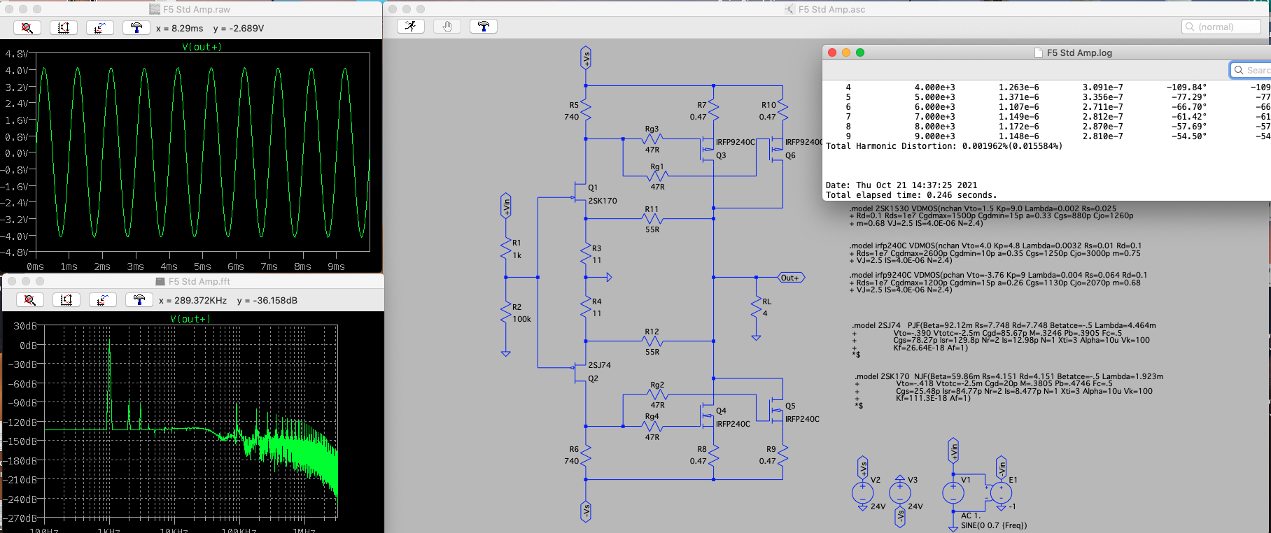

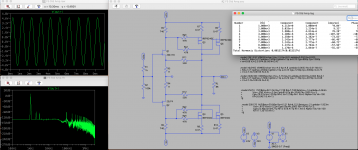

Spice sheds not much light on the sound difference ......
Hm, when I double the outputs every pair has 1.25A so 2.5A total for the amp.
OLG gets about 6dB higher for doubled in Spice compared to standard. Is this a value to be expected?
if you double Iq, xconductance is really twice previous (same being in function of Iq per device)
if you stay at same sum Iq, xconductance is decreased for each because Iq per each is decreased
how much - either measurements or calc from graphs readout
though, no ready available graphs for so low current range, except if someone published specific ones (no from manufacturers)
