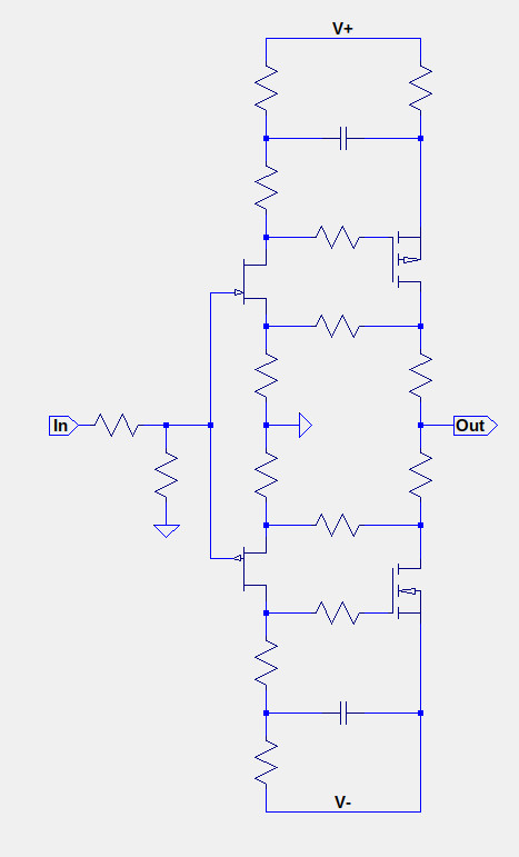

In post #32, the resistors on the drains of the output FETs were intentionally introduced to provide negative feedback of the bias current instead of using optocouplers. I haven't worked out the resistor ratios needed to achieve thermal stability,
Of course, the two circuits (posts #32 and #39) can be combined:

I still want to eliminate source resistor degeneration of the output FETs. After all, the F5-Turbo was an approach in that direction. It is easy to do and thermally stable.

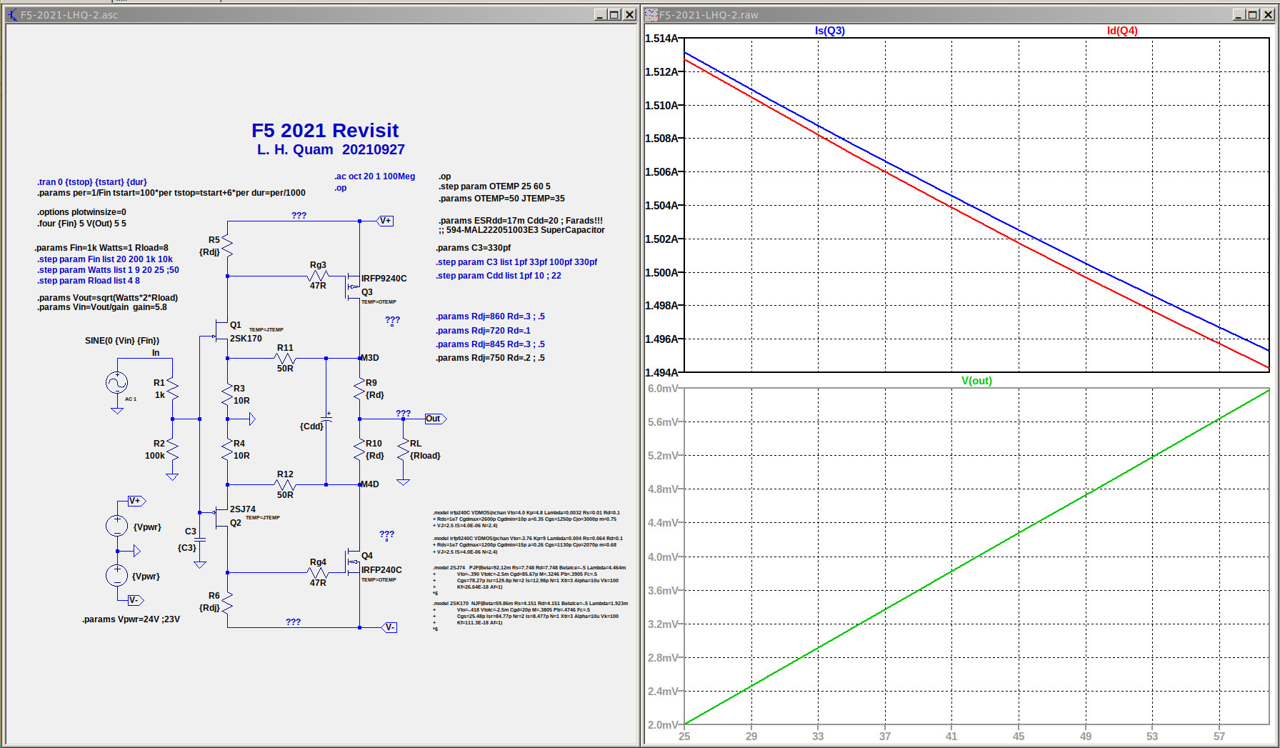

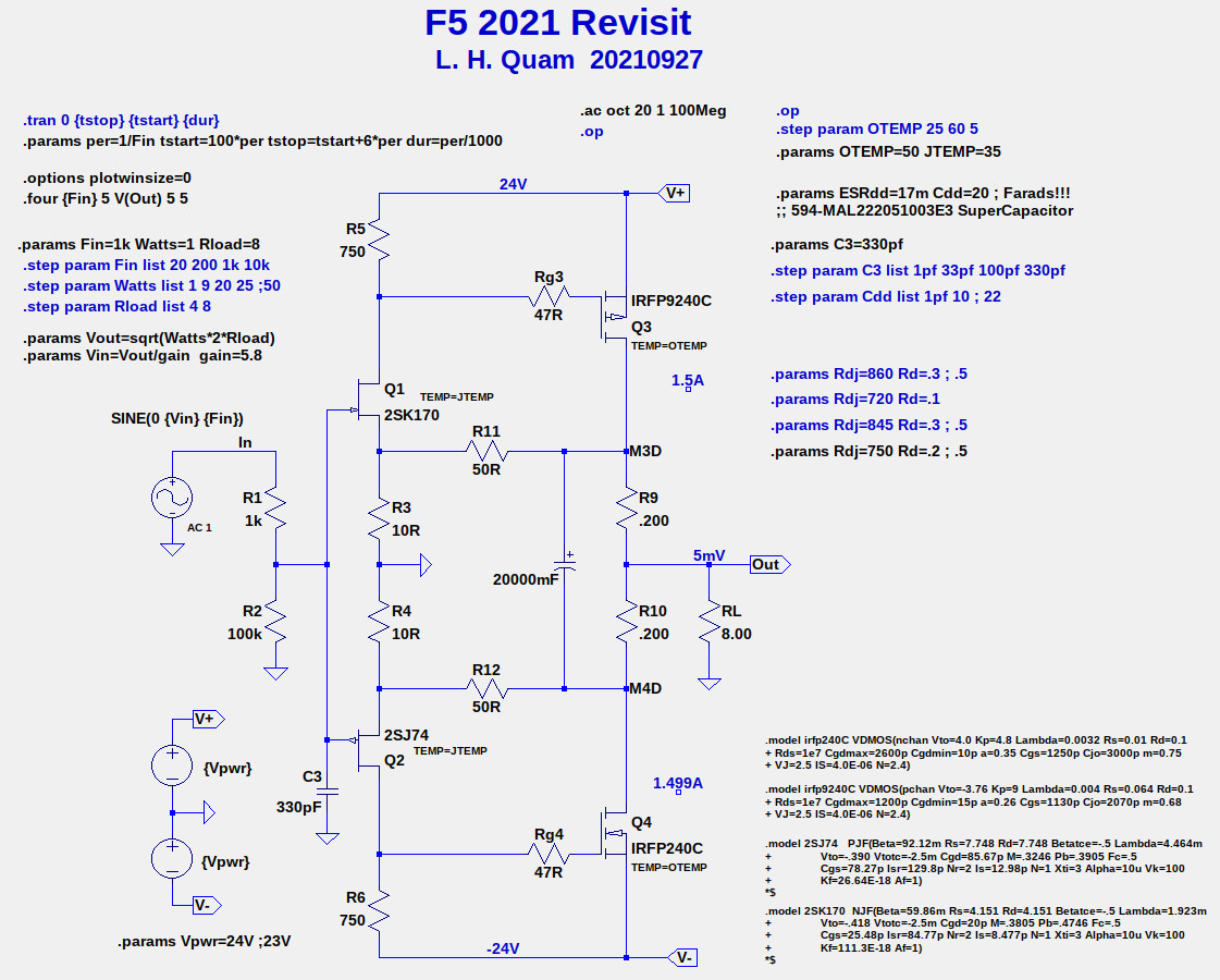

Here is a circuit based on the topology of post #32.
The first image shows a set of very good component values.
The second image show a temperature sweep from 25C to 60C of the output FETs, and the FET idle currents and the output voltage offset.
Attached is a standalone LTSpice .asc file for the circuit with parameterized values.
The inclusion of a 20Farad supercapacitor between the output FET drains makes a huge difference in the distortion levels. I do not know if the supercapacitor frequency response over the audio range is good enough or not. I am sure this will be controversial.

I am not sure I trust the Spice temperature model for the IRFP240/IREF9240 output FETs used in my simulations. Everything is to good to believe.
I will try the topolopy with some different FETs with believable temperature models.

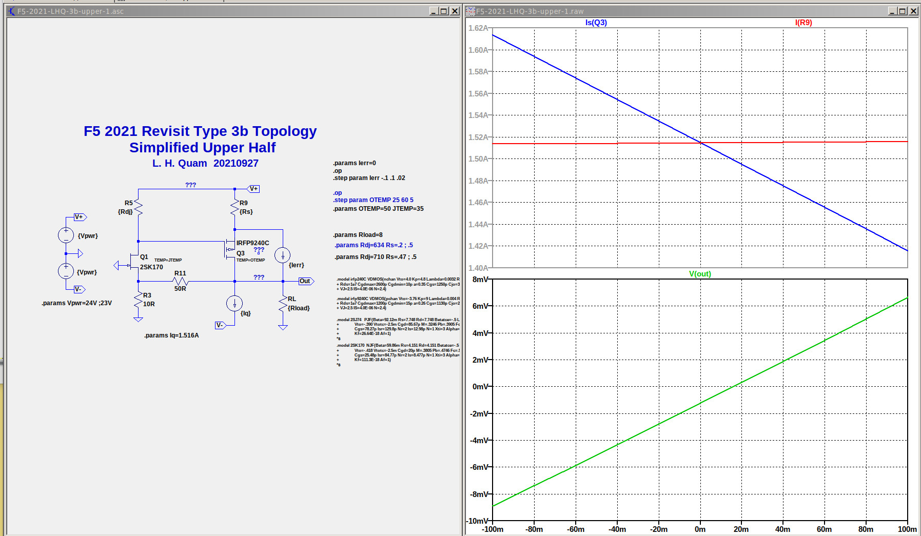

I have checked differently that the bias control works.
I just added a 0.1A current in parallel with Q3, and checked the current through R9,10.
They remain largely unchanged.
So the bias is self regulating, even with such abrupt change in bias.
I am pretty sure it also works in practice.

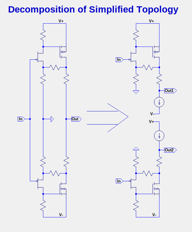

I need to do serious math modeling of the circuit. The F5 topology has a special property that makes it possible to model the two halves independently, since the only connections are the input, output, and ground. This cuts the math equations roughly in half.
But the output to load is still joint.
It is a transconductance amp in open loop.
So the output is load dependent, and output voltage is sum of two currents x Load impedance.
Distortion on one half will affect the other half.
So you cannot just divide the load into two parallel halves.
And the even harmonics NFB by R9,10 only works when you recombine them into one.

I was primarily interested in understanding the idle state with the input at ground. I will try a simulation to see how 1/2 will behave.
