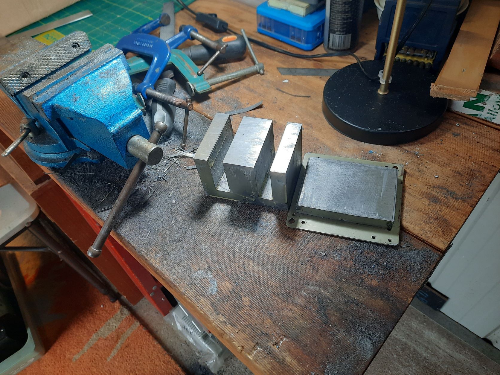

As long as you are already dealing with welded I and E sections, you could strap two E sections together with twin bobbins. This allows symmetrical windings for P-P OTs and also lowers leakage L. Long winding layers make the leakage paths long and thin, so the flux prefers to stay in the high mu steel. (since the leakage path is not shorter) If you don't need twice the size OT, then split one E section in two.
For twin bobbins and P-P you want to put primary winding halves on each bobbin so each winding section is effectively full length.

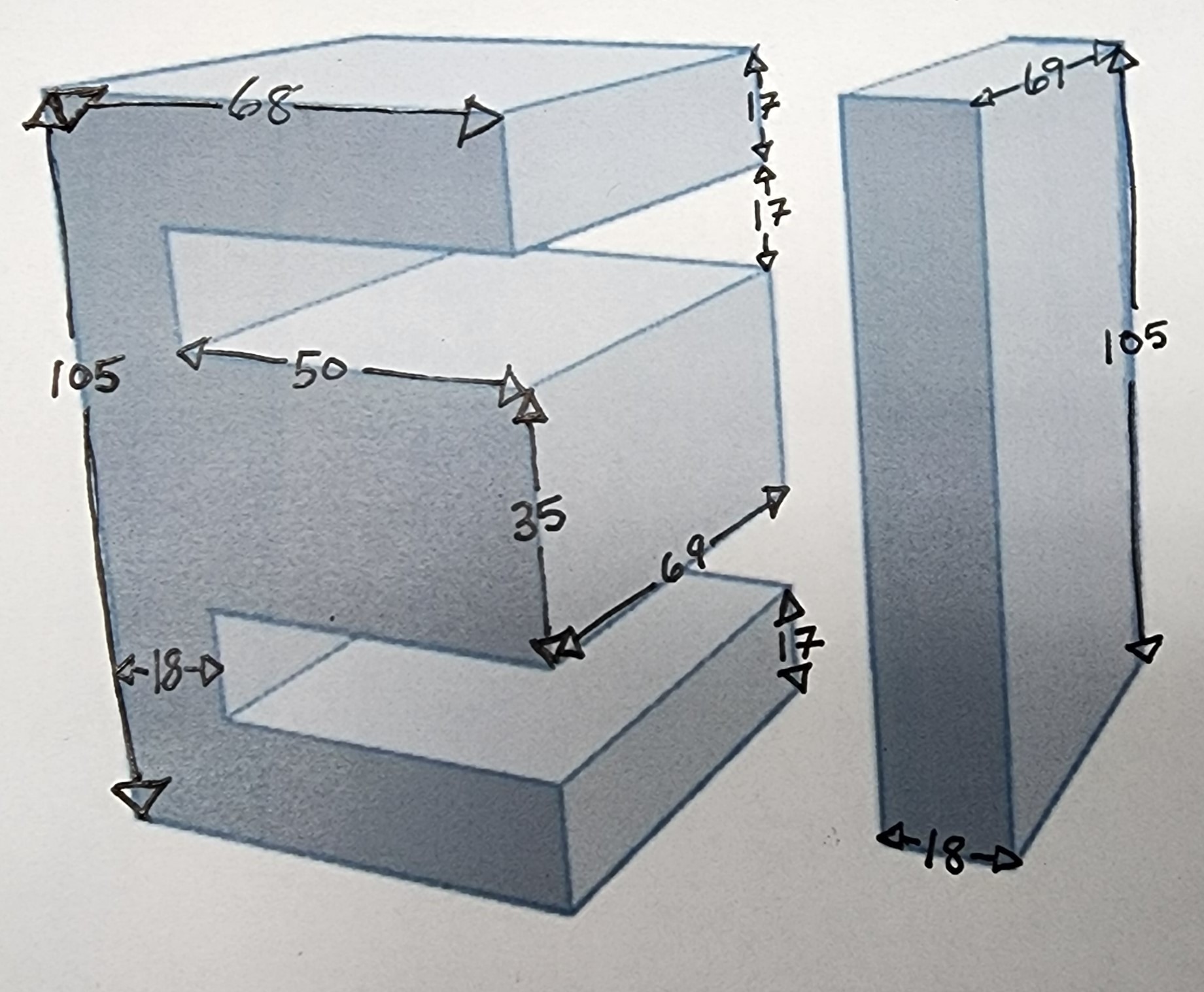

I rounded all dimensions to the nearest mm. This is the full block of iron. On the half-height, the only change is that the 69mm dimension becomes 34mm. The impedance ratio that I'm going for here is 2400:24, but I'd like to be able to make different ones as well. Can you point me to a resource or calculator that can teach me how to do this? I tried searching for the Crowhurst papers, but most of what I found were broken links.

A 24R secondary load?
Well, by rough estimation this core can be used at least for a 300B OPT. I could try to go even far and sketch a GM70 OPT. Are you sure you want to drive headphones?

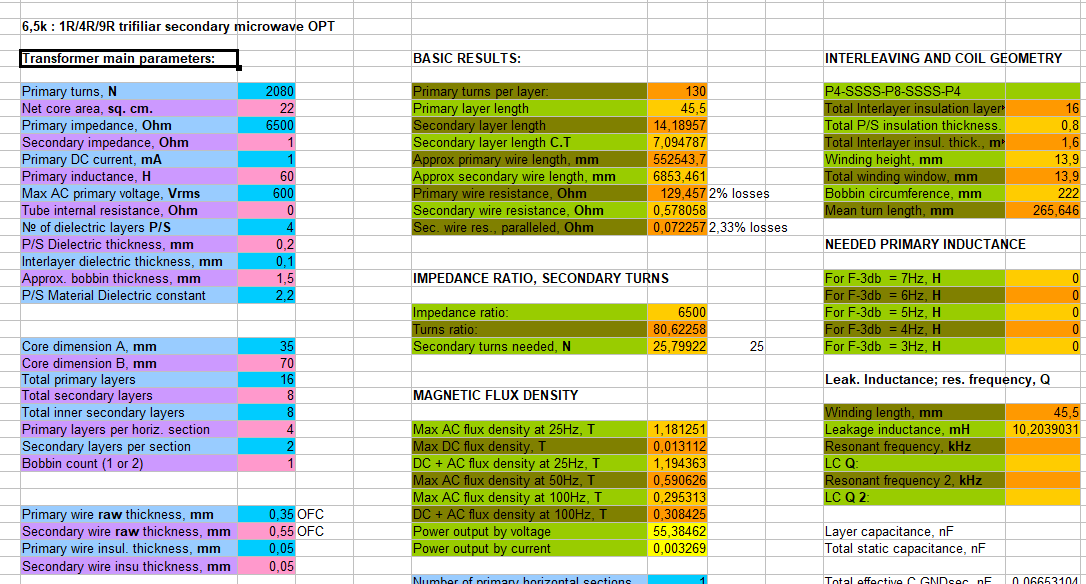

At first sight, you can get ~55W of output power if we assume the saturation begins at 1.2T. I have no knowledge on these cores.
You will get a calculated leakage inductance of 10mH with 4 primary and secondary interfaces and an acceptable interleaving for that is P4-SSSS-P8-SSSS-P4.
In this example I took into consideration trifiliar secondary windings, each third representing a 1R secondary impedance. That allows for 1R, 4R and 9R output impedances and even higher if you decide to split secondary packages. For a single 8R it will be simpler of course, but a different wire gauge.
Primary inductance will depend on your permeability, which you have to find out on your own.
I allowed ~3mm for windings bowing.
If you're ok with such design I will continue with the interleaving scheme.

Wow, yes. That should work just fine for me. You seem to very much know what you're doing. Thank you for your contribution on this.

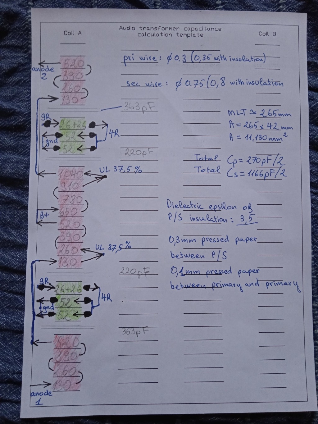

Here you go with a first scrap.
Calculated winding window height is 15,4mm, which is on the dangerous side - you might to be careful with bowing or clamp press the coil before inserting it into the core. Bobbin thickness of 1.5mm is taken into consideration.
The secondaries permit a 4R and 9R commutation. If you need only 8R, you can replace the secondaries with 3x2 paralleled layers of 73 turns 0.6mm wire.

Thank you for doing that. I hope I can get it to fit on the core. It'll be a couple of weeks before I can get it done. Takes a day to wind one of the previous ones, and I'm only available to work on them on the weekends. I'm also going to redesign the bobbin to get a bit more room. The most recent one is 3mm thick.
