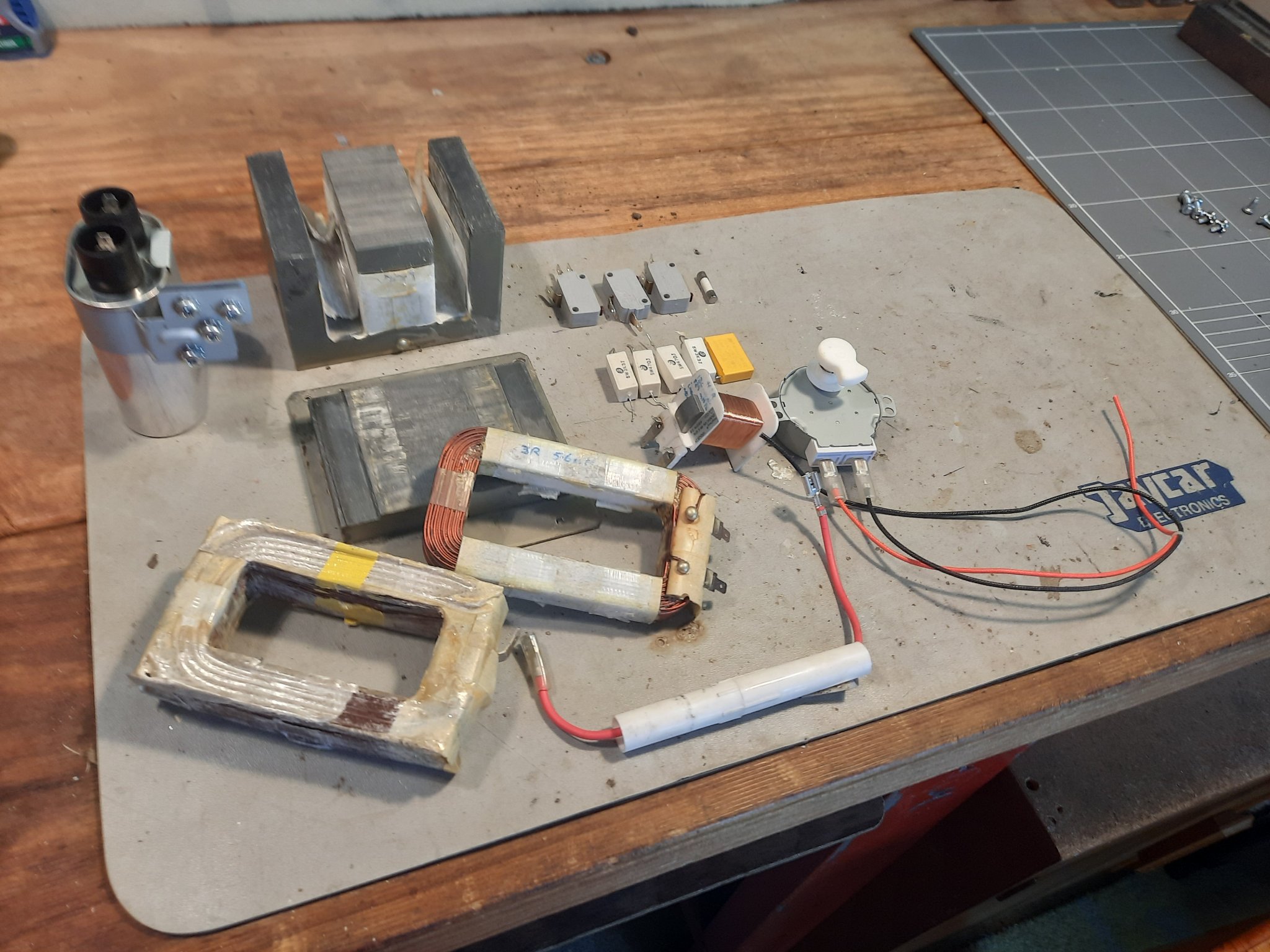

Lots of variation from one microwave oven to the next - but here's a typical salvage haul:
  • transformer iron;
  • two windings (all copper in this case);
  • the winding from the fan motor (a low current choke);
  • assorted power resistors and an X2 cap;
  • one big cap (these measure well up to 20kHz);
  • a high voltage fuse holder;
  • three good switches; and
  • one low-speed AC synchronous motor (for the platter).
The iron will become a power supply filter choke. 🙂 If I find a pair of transformers of similar dimensions, I will be tempted to wind some output transformers. What's not to like?!?

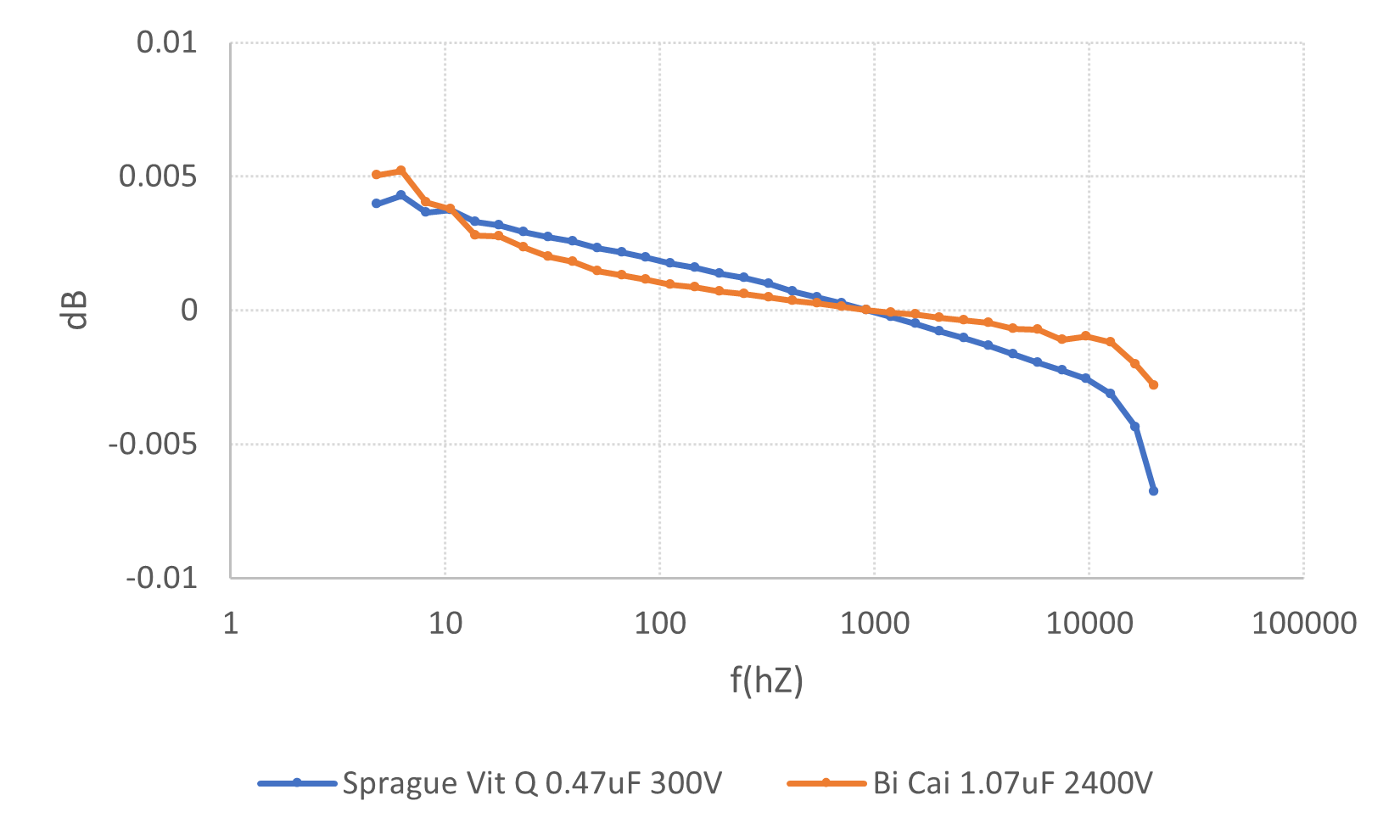

Maybe - though they measure OK at audio frequencies, big internal resistor included. Attached is a plot showing deviation of measured capacitance (in dB) from the measured capacitance at 1kHz. Compared are a 0.47uF 300V Sprague Vitamin Q and a (typical) high voltage cap retrieved from a microwave (branded Bi Cai, 1.07uF 2400V).

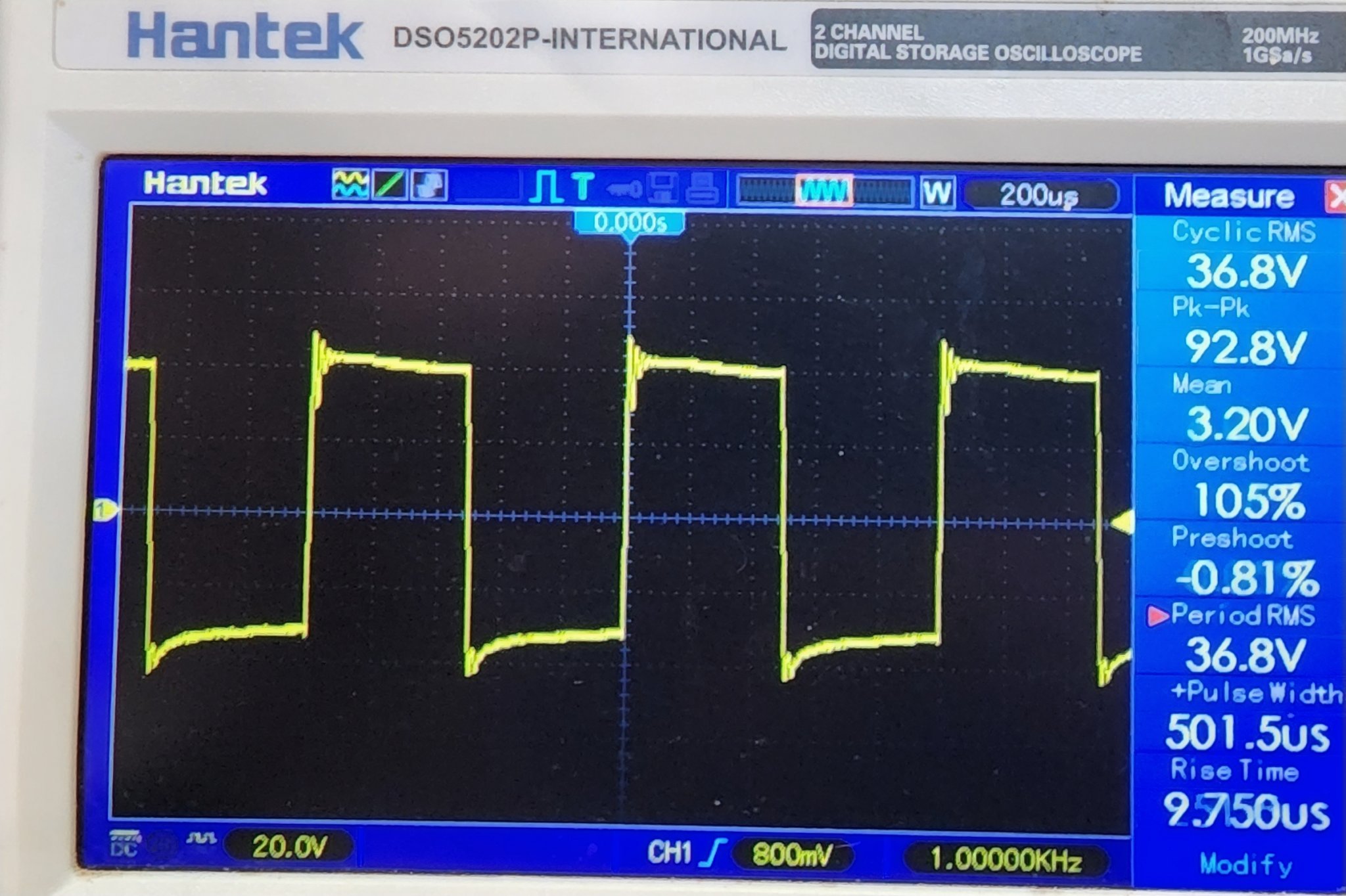

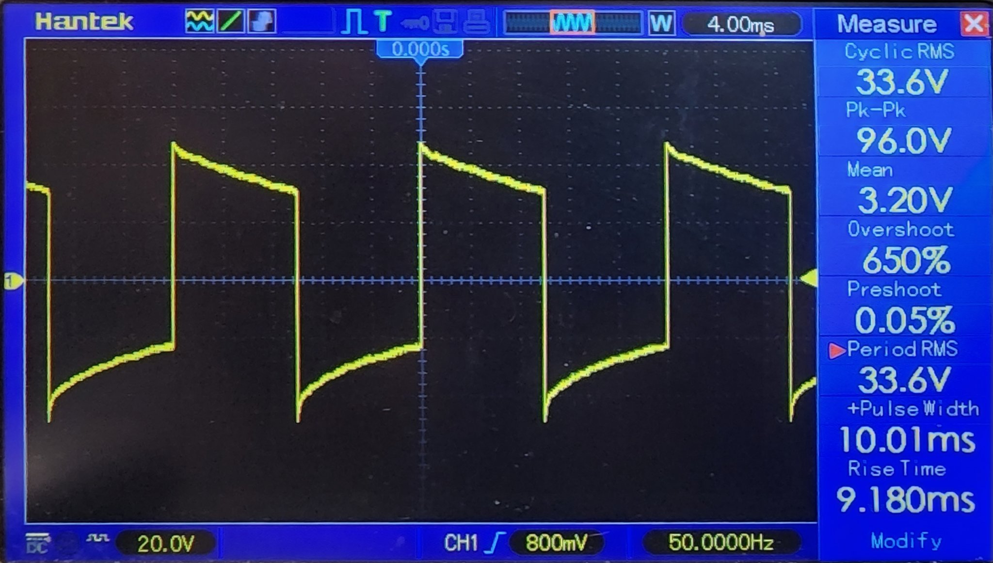

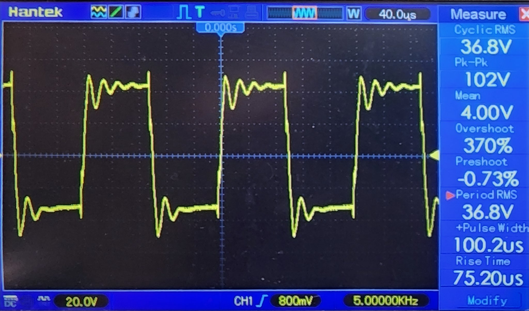

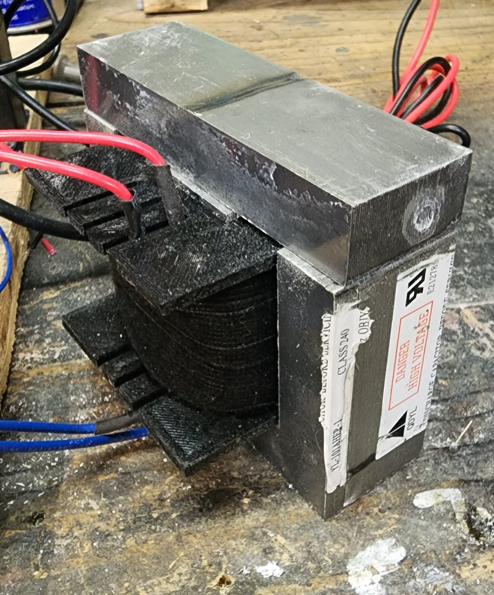

I took a couple of your suggestions and wound another transformer. This one uses the same iron as before, but the stack is 50% of the height as the previous version. I also changed the turns ratio to 2000:200. I kept the same 400-50 turns primary to secondary interleaving scheme. Definitely a different performance profile here. There's some ringing early on, and it's very apparent by 5 kHz. The square wave isn't rounded off anymore though. I still haven't got any feedback applied here. Any thoughts on what's up? It still sounds good to me. Not shrill by any means, but a little more crisp on the high end.
I have a vacuum chamber, and would like to at some point start potting the bobbins. Anyone have experience on what compounds to use? Wouldn't regular paraffin wax do the trick? I figured I could just put the bobbin in a can of melted wax, pull a vacuum to draw the air out of the windings and then pull the bobbin out to drip and cool. I would think that it would stabilize everything and help out with isolation. So many products these days are wicked expensive, and I don't mind old school if it works.
I'm also planning on winding a full piece of iron with as much #28 as I can cram onto it at some point and then measuring the inductance. Should be interesting.

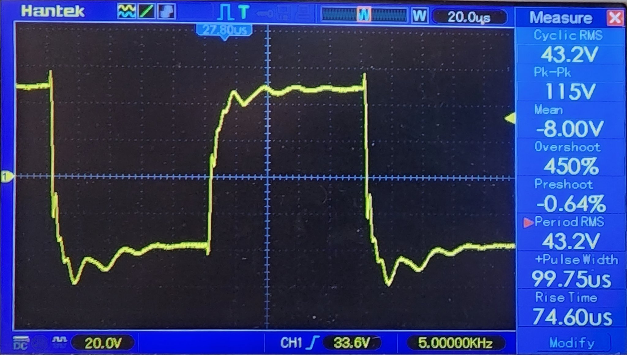

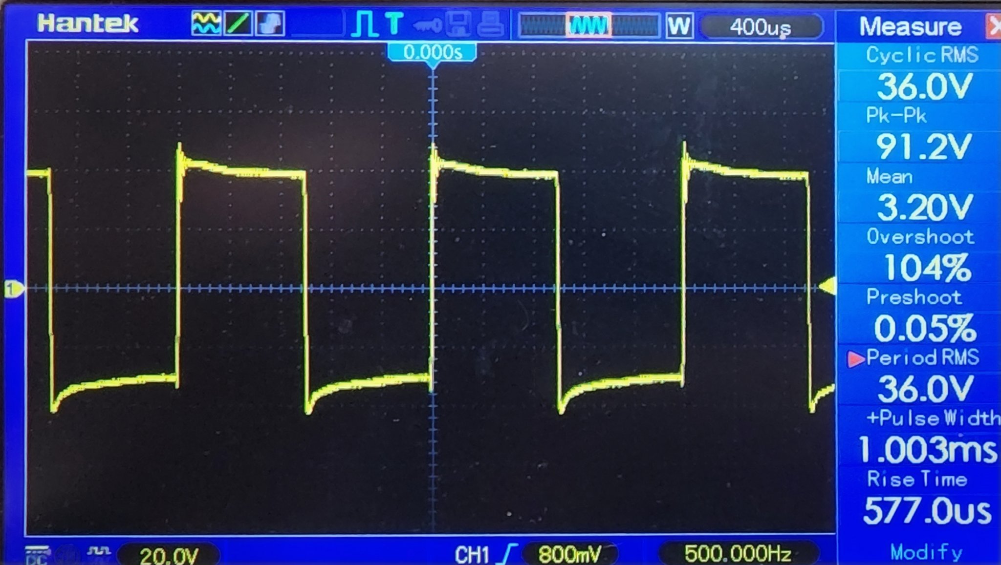

I noticed that swapping the leads on the secondary produced a different waveform still. Any suggestions on what I should try to help prevent the secondary from ringing on future iterations? Any instruction that I've found is in relation to stopping a factory secondary from ringing.. i.e. Snubber circuits, etc. Nothing about winding mistakes/ preventative techniques.
Damping or snubbing the ringing can be used, certainly. But better approach is shifting the ringing frequency upwards, out of the audio band. For this purpose, self capacitance and leakage inductance should be reduced.
For lower self-capacitance, you can use "heavy" magnet wire, layer sectioning, and insulation between layers. For lower leakage inductance, interleaving.
Okay. I saw the 4:1 interleaving ratio recommended somewhere else here on diyAudio, so that's why I've been going with that. Does the actual ratio particularly matter so long as you're interleaving? i.e. more interleaving = better? I read somewhere else too that Kapton tape can lead to excess capacitance. Still other places heavily recommend it. That's the problem with the internet. So much information, very little consistency. Either way, I'm planning on trying some different materials. I've seen mylar tape recommended, and I happen to have some glass fiber tape. Some people even say that they use paper masking tape. Not so sure about that one per se, but there it is anyway. Maybe it'd be better with wax impregnation. Then I've also seen rosin recommended for potting transformers. That would definitely be old school.
The main reason is insurance. There's the possibility that there's a loose turn or two in there since I hand-wound them. I did my best, but I'm not perfect. Potting would lock everything into place and make sure nothing wiggles around and breaks, wears off insulation, etc. I'm not as concerned about OPTs as I am power transformers though to be honest. I'd just feel better having that extra step isolating me from the mains. The only insulating material that I'm using for now is Kapton tape. That may change in the future though.
This one is completely understandable and I agree with you.
As for the ringing waveform, remember the waveform shape is part of the circuit. Before you start designing for a better waveform if this is your aim, you need to define the working conditions of the transformer first.
Interleaving reduces leakage inductance by a square factor. This is demonstrated in Crowhurst papers. Remember the more your primary turns are, the more you need to interleave to keep the same leakage inductance value.
There are two types of resonances. The peak and the dip. The first is easier to fix, the dip is your worst enemy resonance. The dip usually occurs from series connected secondaries with different capacitances to primary layers. Paralleling secondaries acts as a shunt and shifts this resonance above. Rule of thumb - parallel secondaries that are physically far away and leave series secondaries that are close to each other and there is no or little capacitance difference between them.
Give me some info on the core, surface area, window dimensions and impedance ratio and I can give you a useful interleaving schematic.
