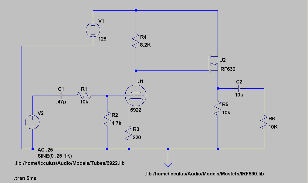

Maybe something more like this?
Operating points:
6922 tube
Va 72.8
Vk 1.5
IRF630
Vd 128
Vg 72.8
Vs 68.9

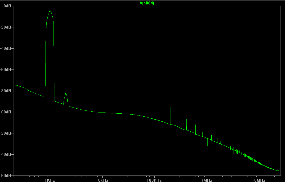

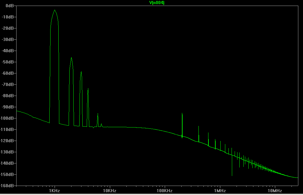

Here are some images from the simulations I did the other day.
@1kHz "NVD33ffta.png" is before modifications and "NVD33fftb.png" is after. Clearly much better results for the latter circuit.

Right FFT is much better in terms of distortion. Some enjoy a 'rich' sound, obtained from elevated second harmonic. A triode as cathode follower does not add to the harmonic spectrum (if soundly biassed). A triode can produce 2H if used as a voltage amplifier, that's what's meant in #3, especially when operated at the brink of grid current near 0V bias.

As stated before the simulation distortion results are not real world results and only should be used as a rough guide. With that being said the original circuit or at least on my simulation shows 2% THD, which in my opinion is what the original tweaker intended, end result is coloration of the audio and definitely not high fidelity. The current modified circuit shows only .02% THD in the simulation, so the audio is colored much less by distortion....or think of it as purer.

The tube--->mosfet circuit which has been recommended by several people on here imho would be worth a try. As far as distortion this will give you the h2 you want, my simulation shows .16% THD. This is the best of both worlds, you get some harmonic distortion but not a gross amount from the triode gain stage and you get a better output buffer with the common drain output stage....win win.
