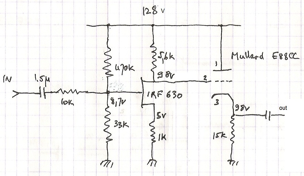

Here is the schematic of a DAC output stage sent to me by a friend who owns this DAC. The DAC was fully designed by the same guy who tweaked by cdp. The schematic is trustworthy except what is inside the redbox which is not important for our discussion.
It can be seen from this schematic that the grid voltage is slightly more positive than the cathode voltage. It would be insteresting to see the distortion figures of this schematic if you can simulate it but I think there would be no surprise.

I'm new to using tubes at low B+, but I'd worry about modelling programs being accurate in such a case. I'd build it up and look at it with a scope, and also with a spectrum analyzer if possible. I've read that low B+ means the plate resistance becomes higher, and yet the plate load resistors in actual low B+ circuits are quite a bit lower in value than is normal for high B+. That seems backwards to me, suggesting very high I.M. distortion.
Ye asks and ye shall receive. THD 3.93%

Thanks for the simulations, you did it very fast !! I wish I could be able do such simulations myself. Results are similar to the original schematic of my cdp right ?
If you are interested I can give my cdp to a friend and ask him to look at the output stage with a spectrum analyzer and post the results here. I already have the general idea with the simulations. I will try someday the tube/Mosfet topology with and without distortion but I know what will be the result 😀 You want good sound distort it 😀😀 (joking)

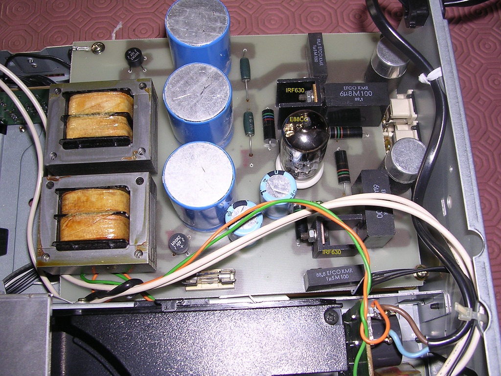

I did not expect that I can learn so much from a simple dust cleaning I should do it more oftenly. I am happy to learn why my tweaked cdp sounds "good" to me. I do not use it for classical music but for pop, rock, jazz, blues....you hear the play of the bass guitar very distinctly, percussions are very powefull.
