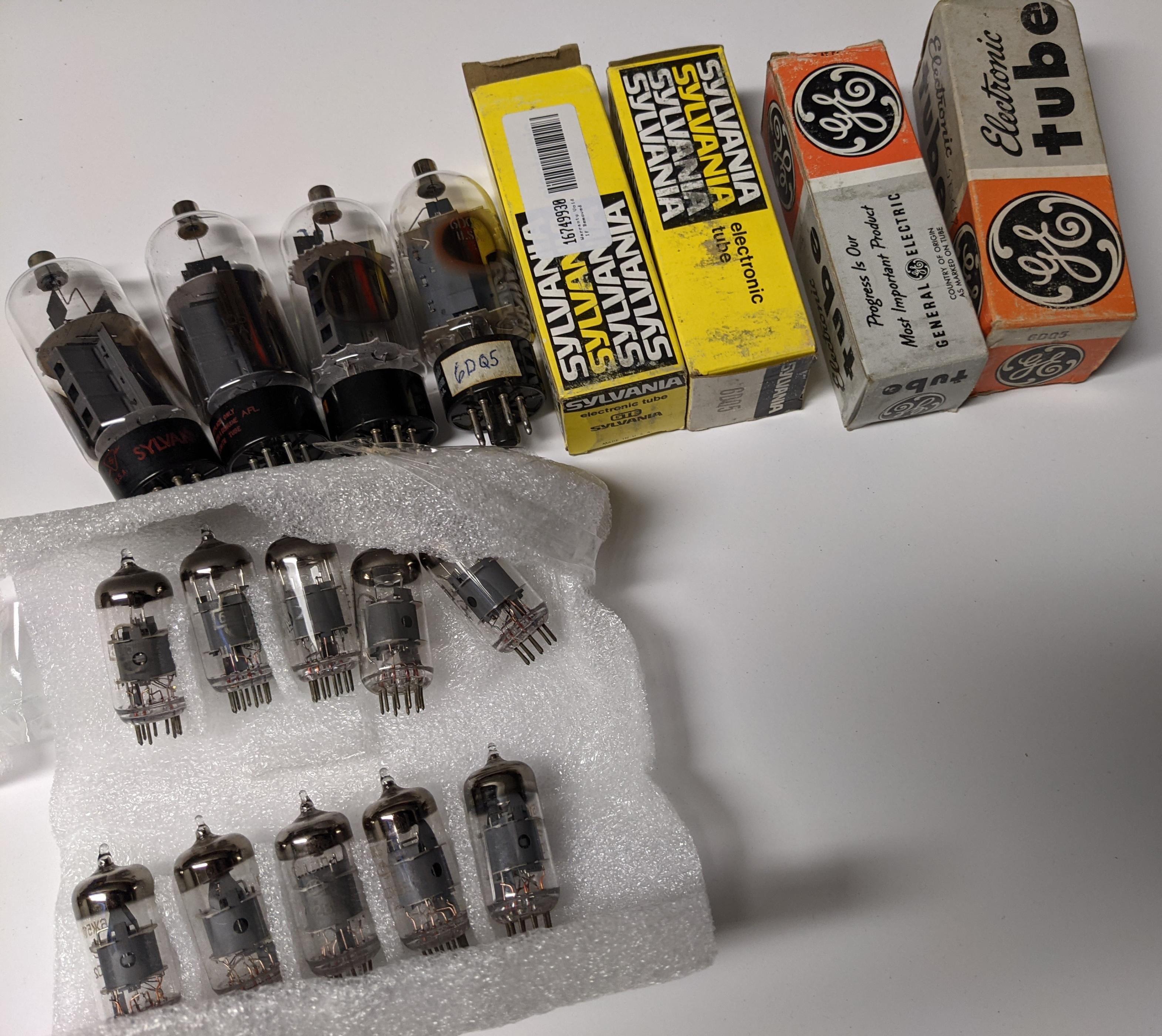

These showed up in the mail. 8 6DQ5 and 10 6J51P tubes for the UNSET build. Hopefully they will deliver the goods. The long lead item in all this for me will be the OPTs. What OPT specs should I be targeting with these tubes if I am looking to do a easy 12-15W build? Something like the Edcor CSXE25-5K or the Toroidy TTG-EL82SE?
