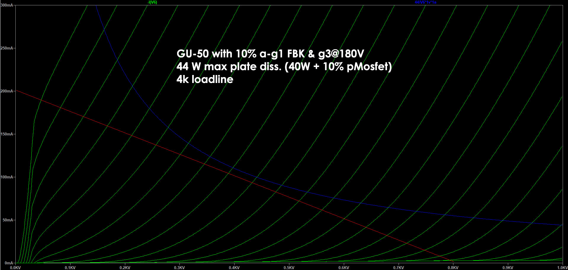

I would like to try GU-50 on one of the two boards, so I've simulated GU50 curves with 10% (120k+150k a to g1, 33k g1 to gnd) and g2 at 180V, added the 44W (40W plate +10% pMosfet) max dissipation curve and the 4k loadline. I'll also raise g3 to +15V circa to sharpen the knee of the pentode.
Would you set B+ around 420V and something less than 100 mA at idle?
That would mean biasing around -45V, so a total swing of 90 + 80 (circa) so 170Vpp to reach full power, that will be around 17 Wrms.
Is it preferred to run it at lower voltages with higher g2 voltages and lower Ra?
If you prefer to switch all technical questions to another thread, it's perfectly fine for me.

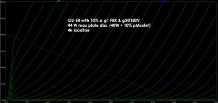

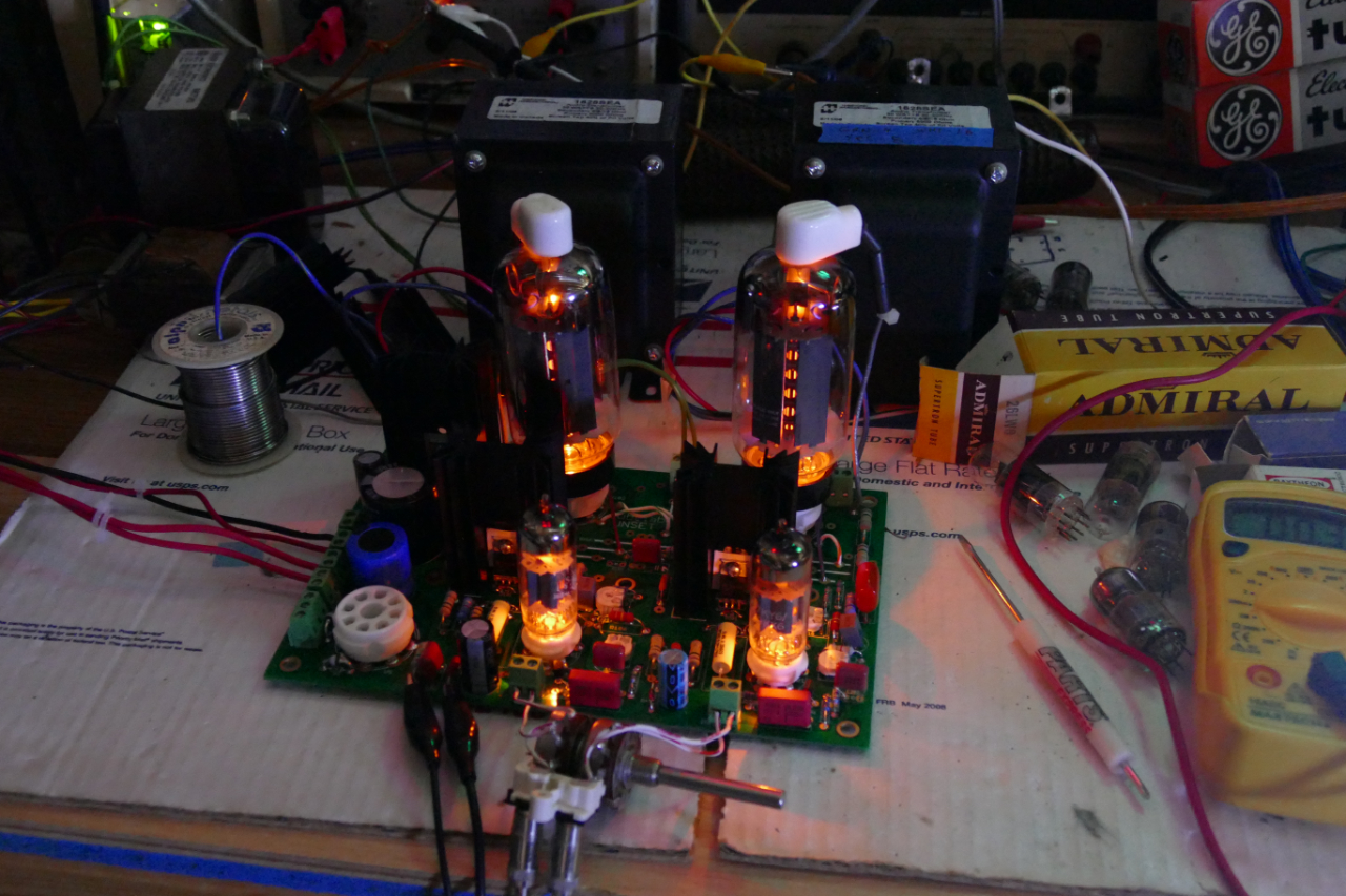

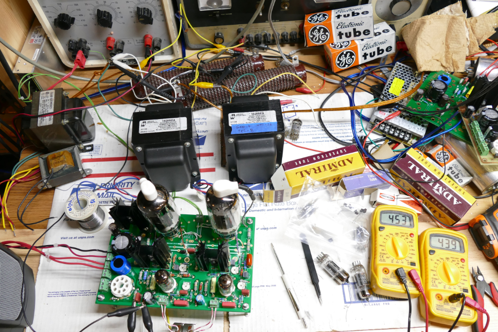

I have several UNSET boards in various states of build completion, but two that see most of my testing duties.
One is the second prototype still on a DIY PC board, called the brown board. It has been used for daily listening for months with a wide variety of music, volume levels, and at least 4 different sets of speakers. It has just worked, flawlessly.
The other is a newly constructed test board on the first of the new production PC boards. It is the green board. In a hurry to build it, I canabalized the original first prototype board for parts destroying it in the process. It has worked well....until a few days ago when I blew up a mosfet.....then another.....
My test setup is not exactly the neatest in the world, but it has worked for me on everything from tiny 4 watt guitar amps to an UNSET board driven to 250+ watts in push pull for the past 6 years.
In many tests I use a pine "breadboard" with a pair of my Universal Driver boards on it and swappable output tube boards, but here everything is just connected up on a cardboard box to avoid unnecessary benchtop wear. My particle board benchtop in Florida began to come apart after about 15 years and eventually failed after about 20. This one is covered in hardwood laminate flooring "samples" obtained from a defunct carpet shop.
There are two 500 watt 8 ohm resistors behind the OPT's. I bought them after a previous dummy load went open at 160+ watts setting an OPT on fire. You can see a mess of clip leads connecting the audio analyzer and scope to the resistors. Two sets of speaker wires (blue and gold) are also connected as needed with clip leads.
The inputs are wired directly to a dual 10K pot with RCA jacks soldered directly to it. Phones, iPad, CD and DVD players are connected with the appropriate interconnect cable, the audio generator is connected with clip leads.
Despite this mess I can measure THD's down into the 0.2% range on this board at low power levels, where the generator directly to the analyzer reads 0.1%. It's good enough for tube amps.
I have seen the green board blow up several times in the past 4 days. It can be just cranking some music and the slightest disturbance causes a mosfet to blow, often splitting the plastic. I even blew one of the cathode drive mosfets. These occur quickly without warning, so I have never been able to catch anything on a scope. I even had as many as 6 multimeters wired into the board trying to figure out what causes the failure. Each failure involved some action by me. I was near, or touching the board when it went bang. If I was across the room listening, it never blew. All testing was done using an external power supply for B+ to evaluate things at various B+ settings without swapping power transformers. I could run the board at the limit of my power supply (300 mA) and even bury the needle on it's current meter without blowing anything, then watch it blow at 200 mA total on 460 volts.
Could it be a loose connection? Why did my brown board never blow, even at 600 volts?
All but one failure involved just the screen supply mosfet. The BIG bang blew a screen supply fet AND a cathode drive fet. What's making the screen fet blow?
I was about to swap in my brown board when I decided to run the green board from an external screen grid power supply. I connected up my Knight Kit power supply to the screen grid of the output tubes, and cranked up the board. Everything appeared to be normal so I started playing with the plug on the phone. Both current meters pegged and the scope lit up with 40 volt P-P distorted sine waves at 44 KHz. The screen current was over 300 mA for two tubes, of course the fet blew. It was eating 100 watts or more. An open circuit caused no issue, but touching the input brought both a distorted 60 Hz buzz, some random high powered oscillation at 35 to 45 KHz, and a whole lot of tube current. That big Hammond OPT is nearly a dead short at those frequencies (OPT's are highly capacitive beyond their resonant notch).
My first thought was, "Why didn't I see this on my other board?" So, I decided to swap it into the setup. That's when it all became obvious.
If you look in the picture you will see a long black clip lead, one of three connected to an easy to get ground point on the front of the board, running around the left side of the board behind the roll of solder to the load resistors. It provides a ground connection for the OPT secondaries, the speakers, and all the test equipment connected to the amp output.
That clip lead was still attached to the brown board which was up on a shelf out of sight, and therefore missing from the test setup. Replacing the clip lead made all the evil mosfet eating oscillation go away. The amp has been tested at 520 volts with the bare input, me touching it, and even poking it at random metal objects with nothing more than clicks and buzzes (normal).
Now some more "normal" testing can resume.
