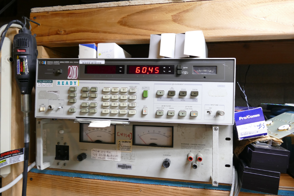

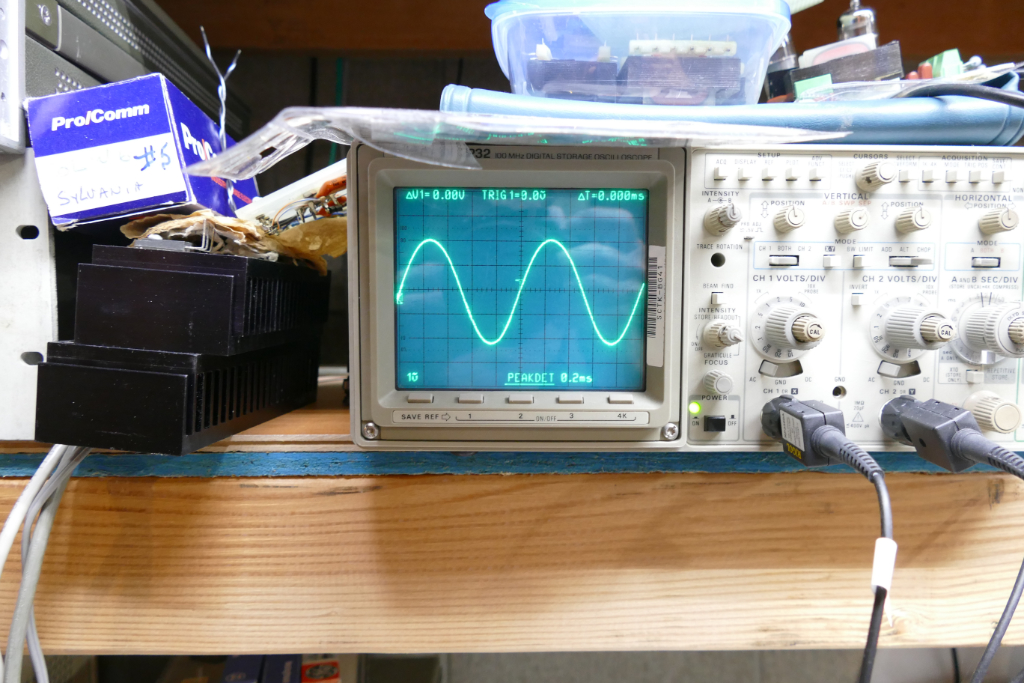

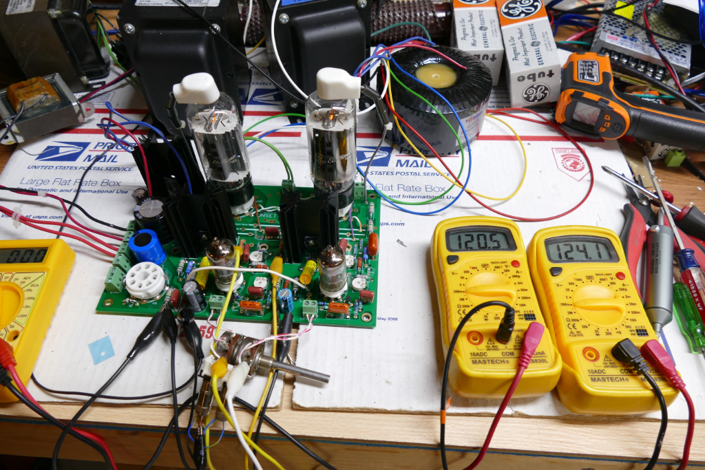

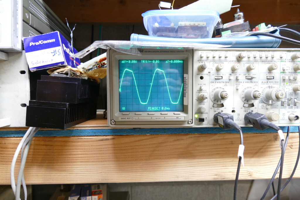

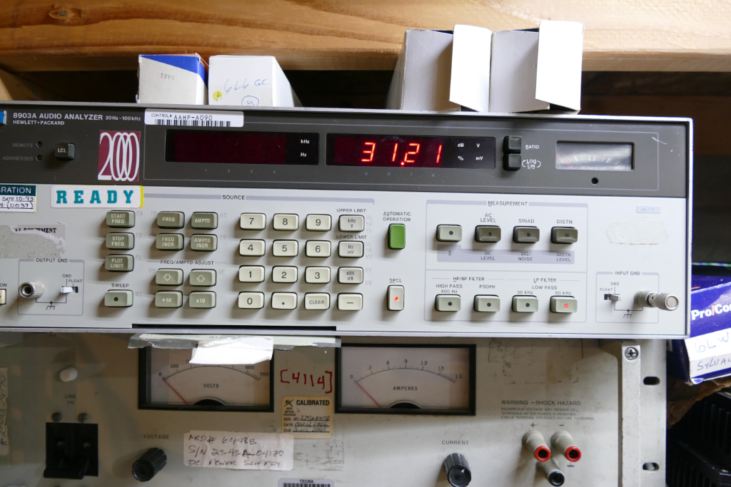

I did some testing tonight. Experiments in miswiring a 5K Hammond 1628SEA for 2.5K were disappointing. I hooked up a 1.5K Toroidy and ran both channels in PSE configuration from s single driver tube. I was exploring the power that this setup made when I just cranked the audio generator up full. The power meter read over 60 watts, busting my best for a SE tube amp. Granted it was a very ugly 60 watts. Things looked a bit better at 30 watts or so.

The dead board is working again. I have discovered a few minor issues that can be minimized with component value tweaks. There will need to be a board to fix a possible power up issue and fix up all the other little issues.
These boards can be used for amp builds, and I will make them available to early adopters at a reduced price once I have done some more testing and created a preliminary parts list.
This board is quite flexible and can be used with everything from 6V6's and 6W6's to big A$$ sweep tubes and both SE and P-P configurations, and possible PSE mono on a single board. All the possibilities make it like the Universal Driver board, one parts list does not fit all, but I'll try to make it fit most.
Those who want a PC board, with a complete parts list that you can just build and use may want to wait a bit. I plan on building a few of these things in both SE and high powered P-P configurations to make sure that there are no hidden problems.
Here is the schematic of the current UNSET board. All the funny stuff around the output tube is a jumper matrix allowing the use of any octal tube, or any tube with the use of off board sockets.
