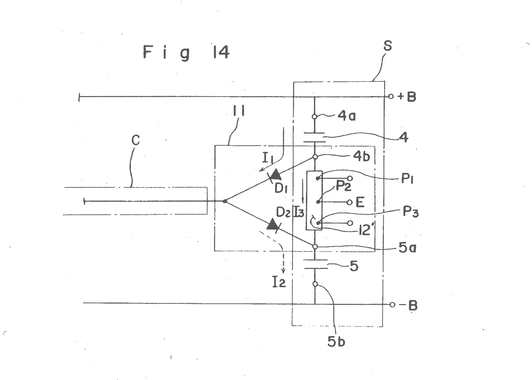

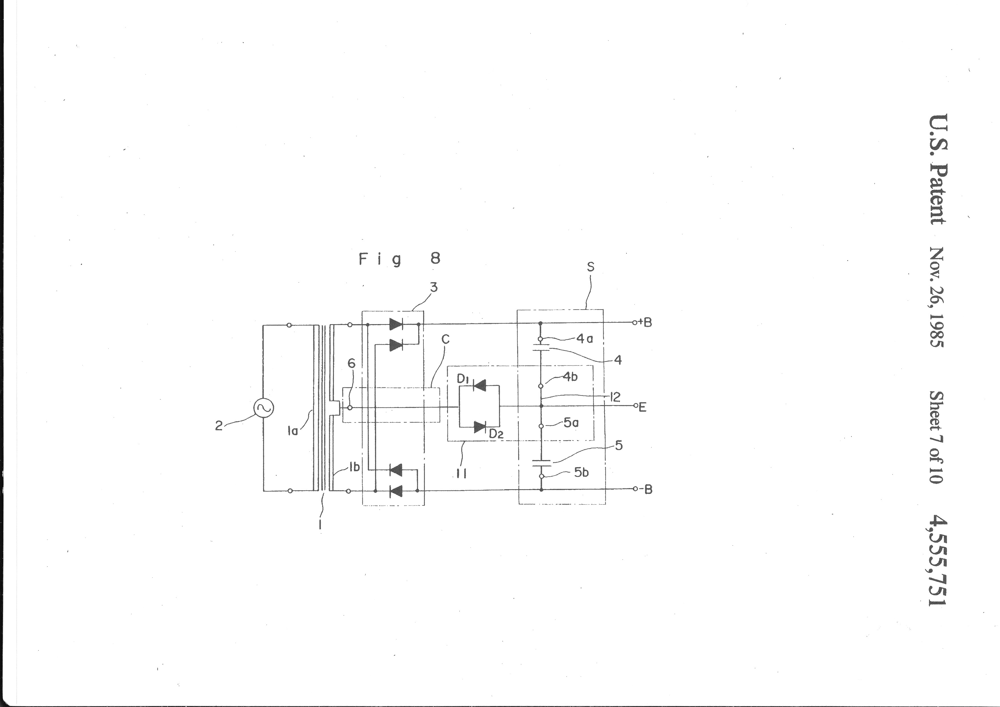

Researching for a similar dual PSU schematic I found a 1985 Patent by onkyo:
They invented a smoothing circuit between the transformer's center tab and the rail where the smoothing caps are tied together. This circuit is made from two antiparallel diodes D1 and D2 (aka D3 and D4 in luvdunhill's schematic).
Furthermore they suggest an improvement where the diodes are tied in a triangle.
I've never seen a schematic that include this simple device. Does it make sence? What type of diodes are the best for this job? Luvdunhill uses UF4007 - a good choice?

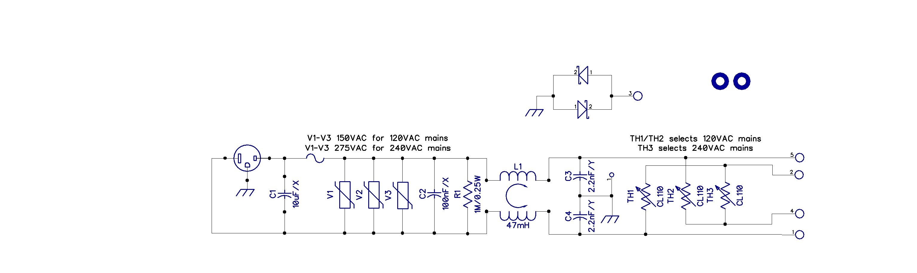

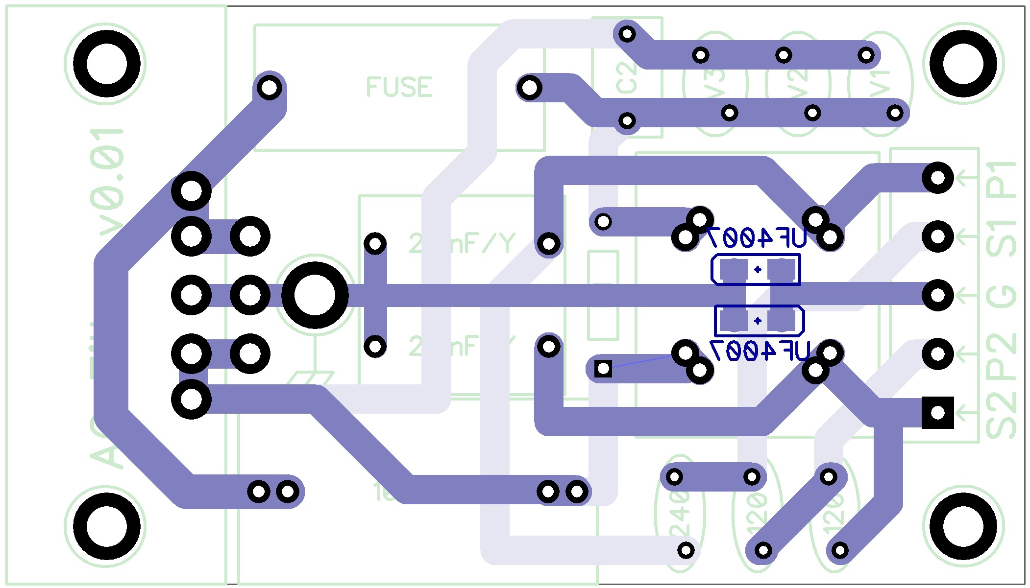

So, here's the AC input filter. Any suggestions? What about the location of the ground loop breaker (under the choke, and output "between" the transformer output)?
Thanks!
Lol - I hadn't seen the original thread - this is how just about all my projects go, in 5 month increments as time permits. 🙂 Looks like a useful PCB. I would probably be in if there is a GB.
In addition to L-N MOVs you might consider N-G and L-G MOVs to nail common mode spikes.

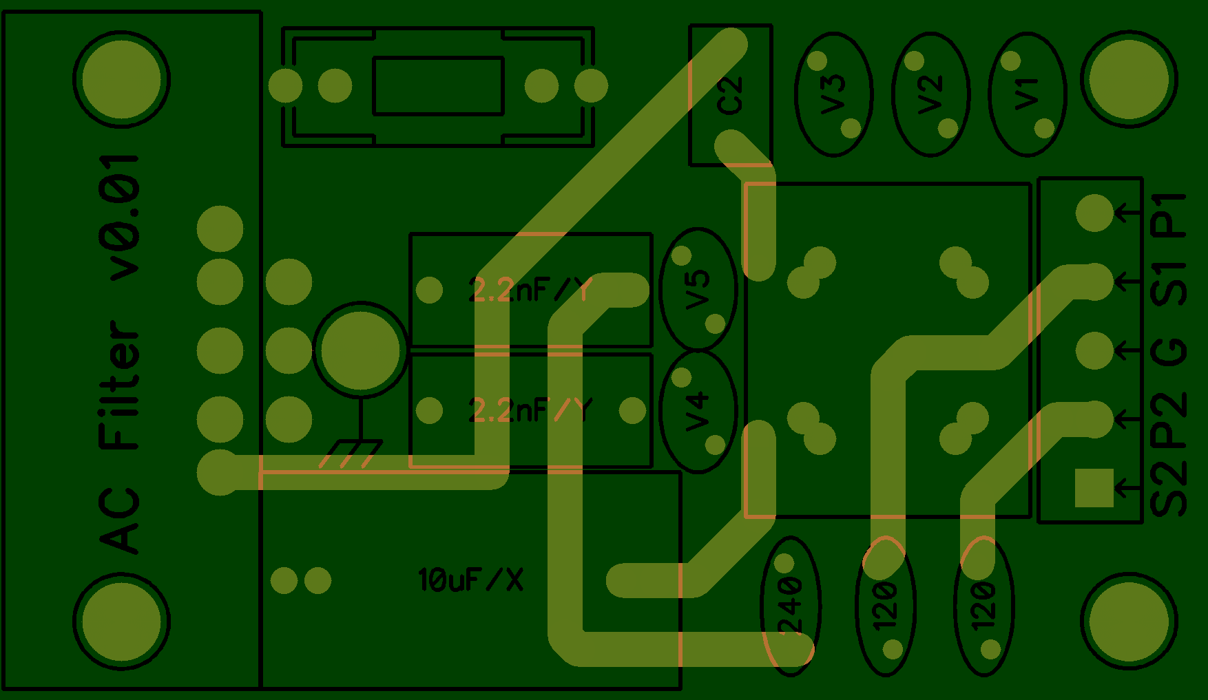

cool. I snuck them in after the fuse, to earth (not ground). Had to move R1 under the board, but it's not the end of the world... I'll probably make up a few at this point.
