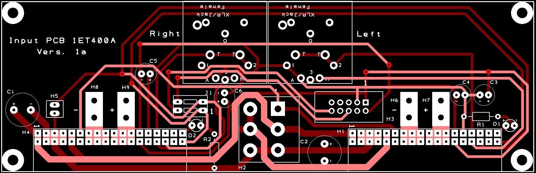

Universal PCB for Purifi 1ET400A amps
I have correct the faulty track. Give some components more space. And changed the holesize of the connectors to get a better fit. Updated the schematic as-build.And publish the gerber files.

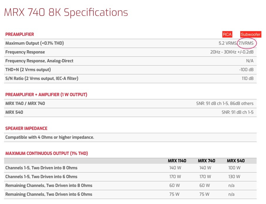

Hello Kofarm,
I allow myself to contact you because I came across your BUFFER for Purifi Audio.
I would like to know what was the Voltage of the XLR output gain of your Buffer?
I have an ANTHEM MRX 540 / 740 and the RCA voltage in PreOut is 5.2Vrms.
Would it be possible to adapt your Buffer to make the most of the RCA Voltage of my Home-Cinema Amplifier (if I don't have an XLR in Pre-Out)
Thanks in advance,
Vincenzo.

Hallo Vincenzo,
With a 5Vrms signal you almost do not need a buffer. You can adjust the buffers in this thread too get the gain(about 2 times) you need in combination with your preamp. Which buffer you like to build, the one with the tubes or the opamp Version?

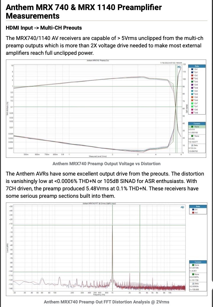

Hello, I would have liked to make Your Buffer OP AMP.
After research, and some questions to people, they told me that according to the Measurement Chart of my MRX540 / 740 Pre-Amplifier (posted above) the 3.2Vrms voltage is the best sound reproduction obtained in RCA-> XLR.
Do you still have Buffers available already assembled? If so, would it be possible for you to adapt your OPAMP buffers @ 3.2Vrms for me? I would be interested in buying them from you according to your offer.
Thanks,
Vincent.

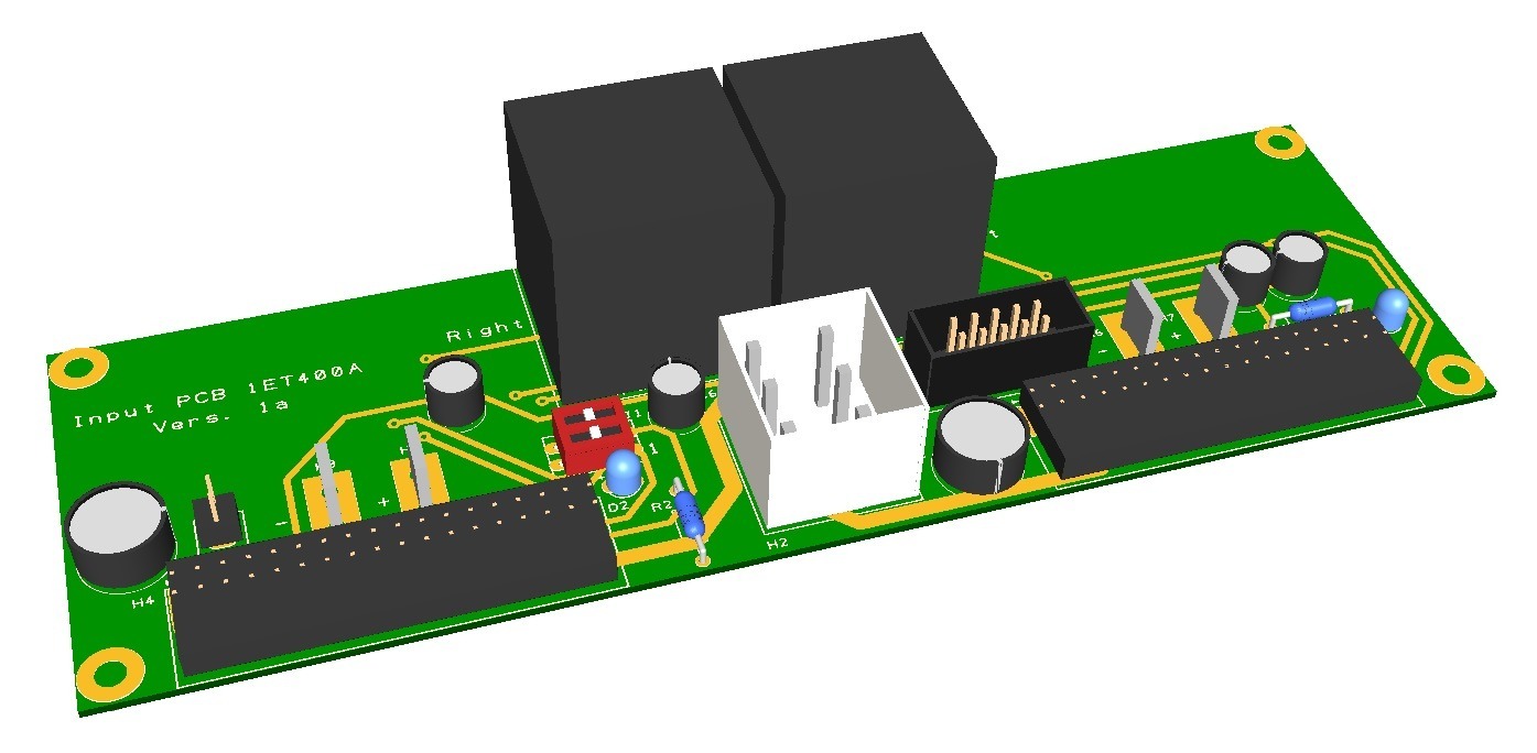

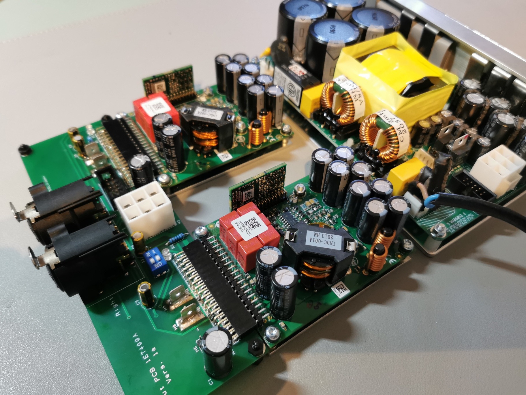

I also still using the unbuffered board.
See files below.
  • Gerber Input PCB 1et400a.zip
  • Input PCB 1et400a - Schematic.pdf

Today completed the new design. Shall order PCB this week.

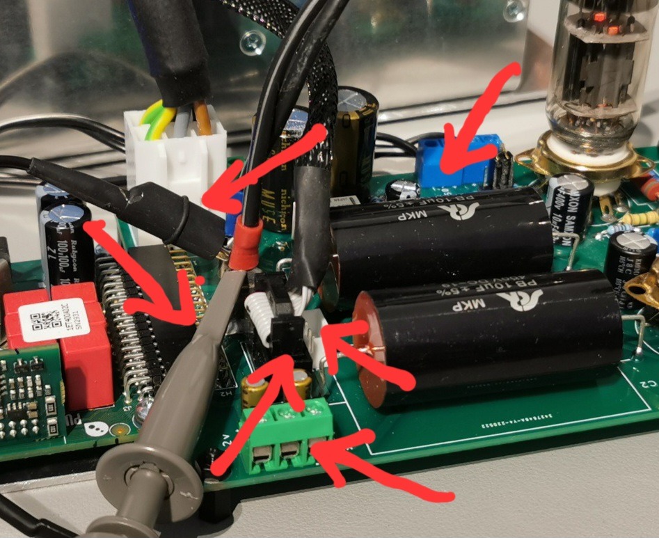

I'm starting shopping the parts needed to assemble your buffer.
I have some doubts regarding the various connectors, tubes supports etc,
where to find the smps 6pins white plugs, the 1et400a 36 pins barrettes and smps black connector (refer picture)
Are those OK?
XLR Jack https://a.aliexpress.com/_ExaBehL
Tube supports :
https://a.aliexpress.com/_Ewcd5Tj
or surface mount like you
https://a.aliexpress.com/_EGwKlf3
https://a.aliexpress.com/_EIbPiO5
Connectors https://a.aliexpress.com/_ExZu8N3
jst-xh2.5 https://a.aliexpress.com/_EGbkgJJ
Thanks again
