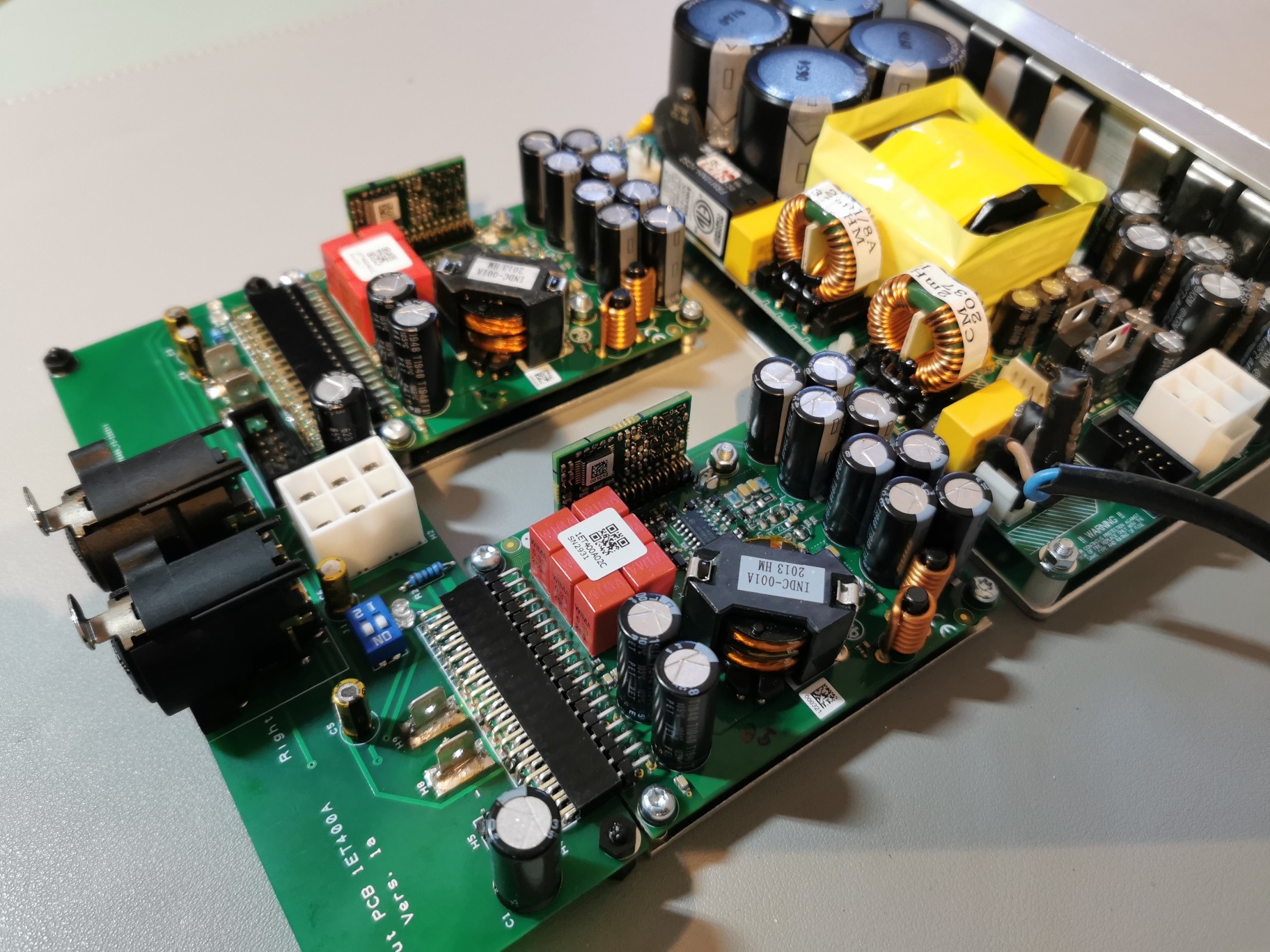

I have three PCB's for the unbuffered input board to share. Just for the shippingcost. If interested send me a PM.

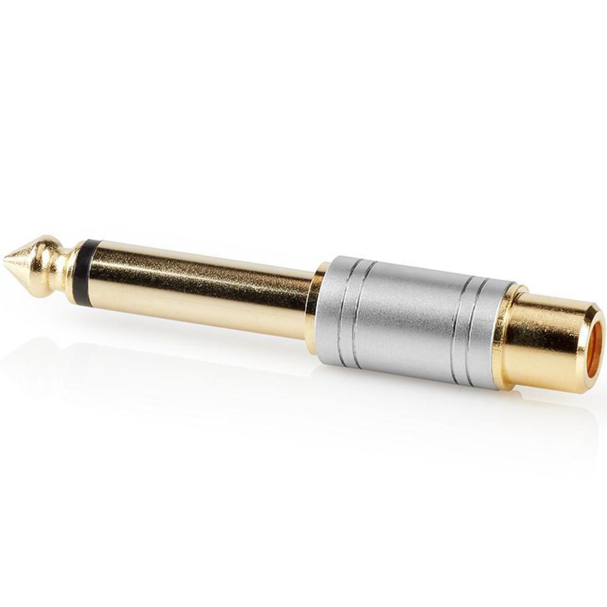

You can use jack to rca adapter when using the neutrik ncj6fah chasis part. Or connect shield to pin 1 and 3 and signal to pin 2.

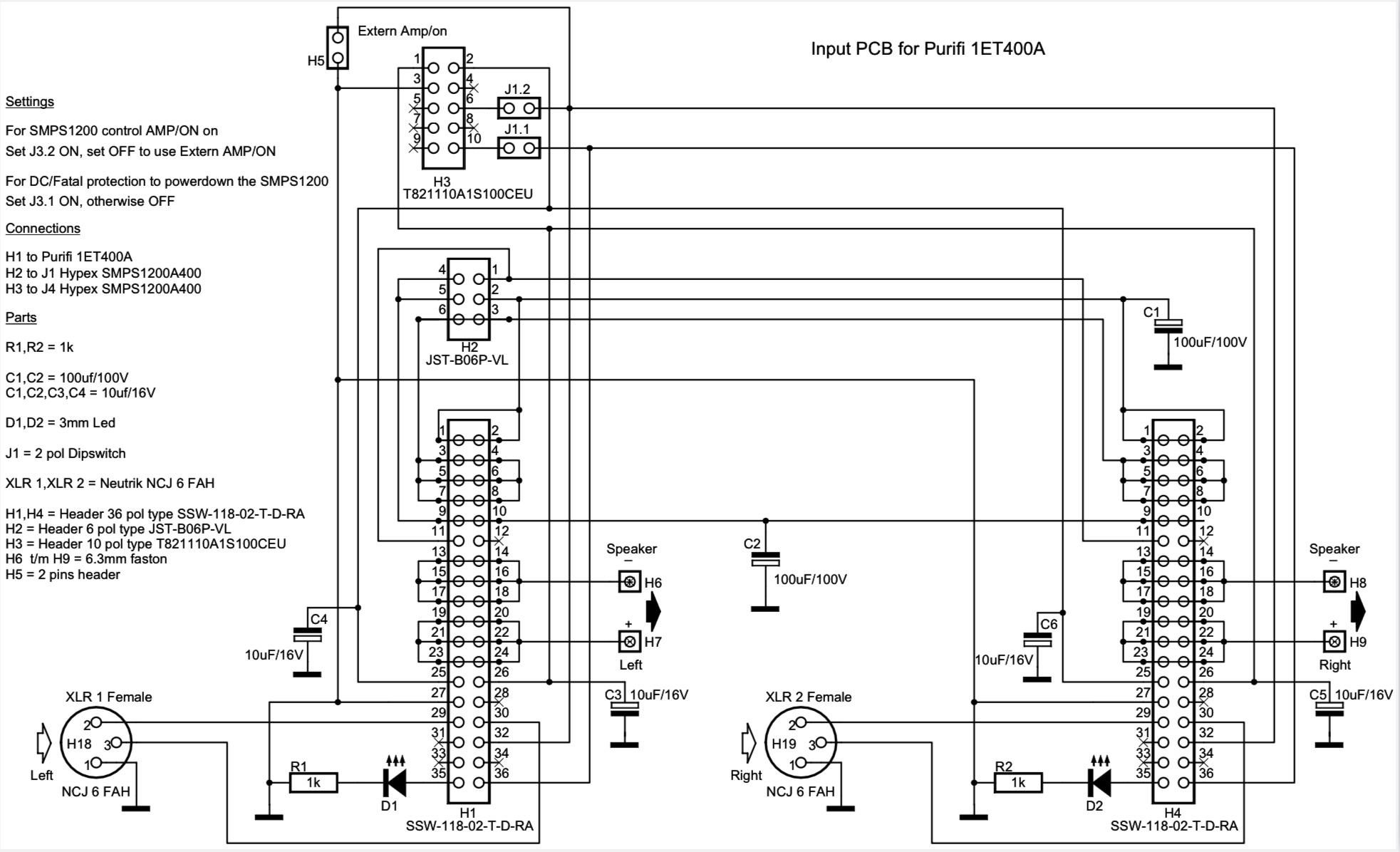

Question to you cognocienti. Purify says that you can use their front end with an unbalanced single ended (aka RCA) input - just connect XLR input pin 2 to RCA hot, and both XLR 3 and Gnd to RCA Gnd. We discussed above, but this is another issue.
If you do that, and run it through LTspice*, you'll see that the level at the non-inverting output of the buffer is about twice the amplitude of the inverting buf output.
Of course, the pk-pk amplitude is the same independent of the connection, provided the input level remains the same.
But. Let us assume that the actual Purify power amp consists of two modules, driven in antiphase and bridge-driving the speaker.
In the case of the RCA input, one module gets double the input level than the other which means that it will clip much earlier than the other.
The total output amplitude, unclipped, is thus much lower than when driven through the balanced XLR input.
Of course, if the Purify power stage is truly differential, it wouldn't matter. But I dunno ...
Thoughts?

Follow-up: Bruno quite adamantly chastised me for even suggesting the power modules would not have fully balanced inputs ...
Issue closed.

I think the balanced input of the 1et400a (and hypex modules) is converted to single ended. Then the classD magic happens. Also loudspeaker - out is referred to Vee, that you do not expect with a balanced output stage.
