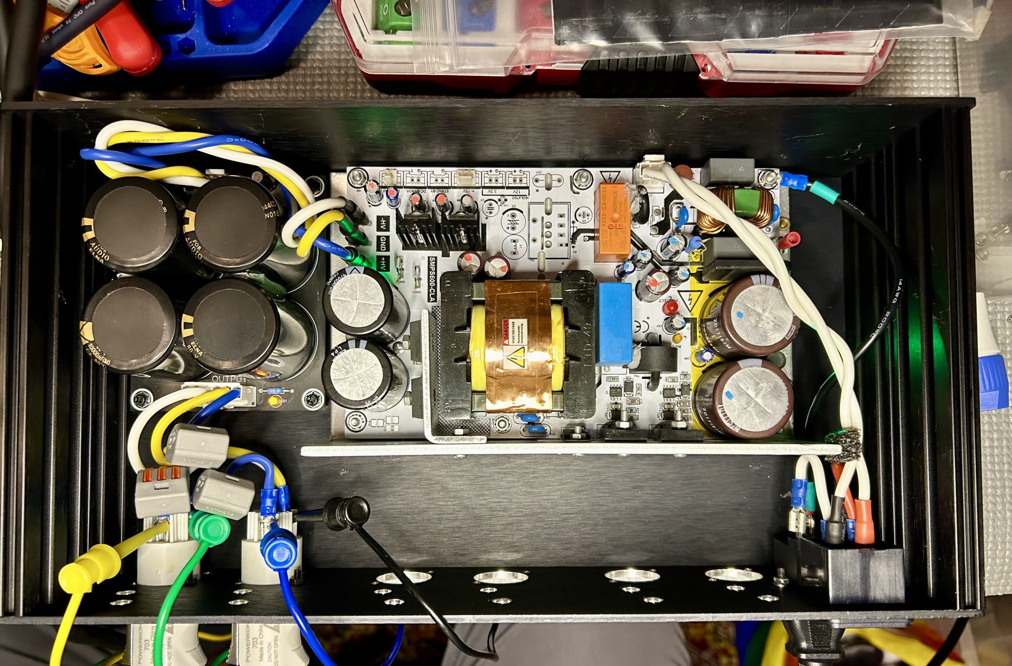

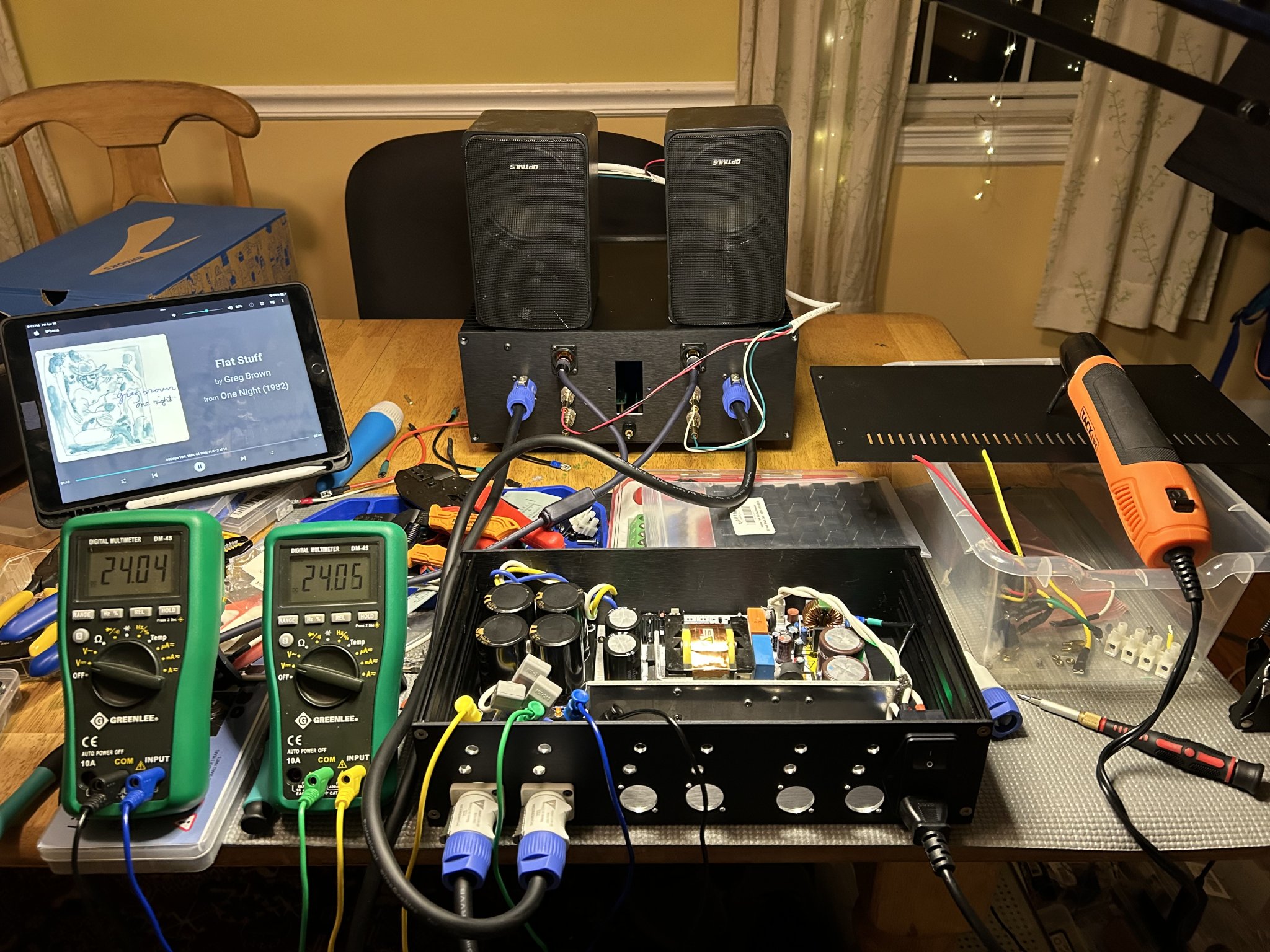

With some unused chassis parts, I now have an outboard +/- 24 VDC SMPS! Another mechanical-only project complete. :snail:
I‘ve had this MicroAudio SMPS idle for a while and have only used it recently to test new builds. Now it’s all closed up and safe* for more testing of builds or putting in an active system. There are additional 2 x 10 mF caps per output rail, using the MicroAudio cap bank I originally got with the SMPS. Powercon knockoff connectors and Wago-like splitters for two outputs. Still need to install a PE connector from PS chassis to amp chassis. First power on went fine, so it’s powering my 2SK1530 / 2SJ201 F5 and my test speakers.
Silent background and sounding beautiful. This pleases me. :yes:
