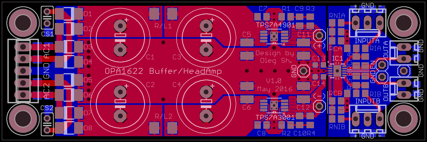

Updated PCB
Attached is the updated version of the PCB. It can now be used in balanced, inverting or non-inverting configuration depending on which parts are populated. The PCB size is 9x3 cm now. I dropped 0603 size so now the smallest SMD parts are 0805. The space around the OPA1622 is tightly packed but the board can still be soldered by hand, even the OPA1622 if heated from below through the via in thermal pad.
I hope I did not compromise the design by allowing too many options.
Any comments and suggestions are welcome!
Oleg

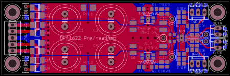

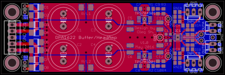

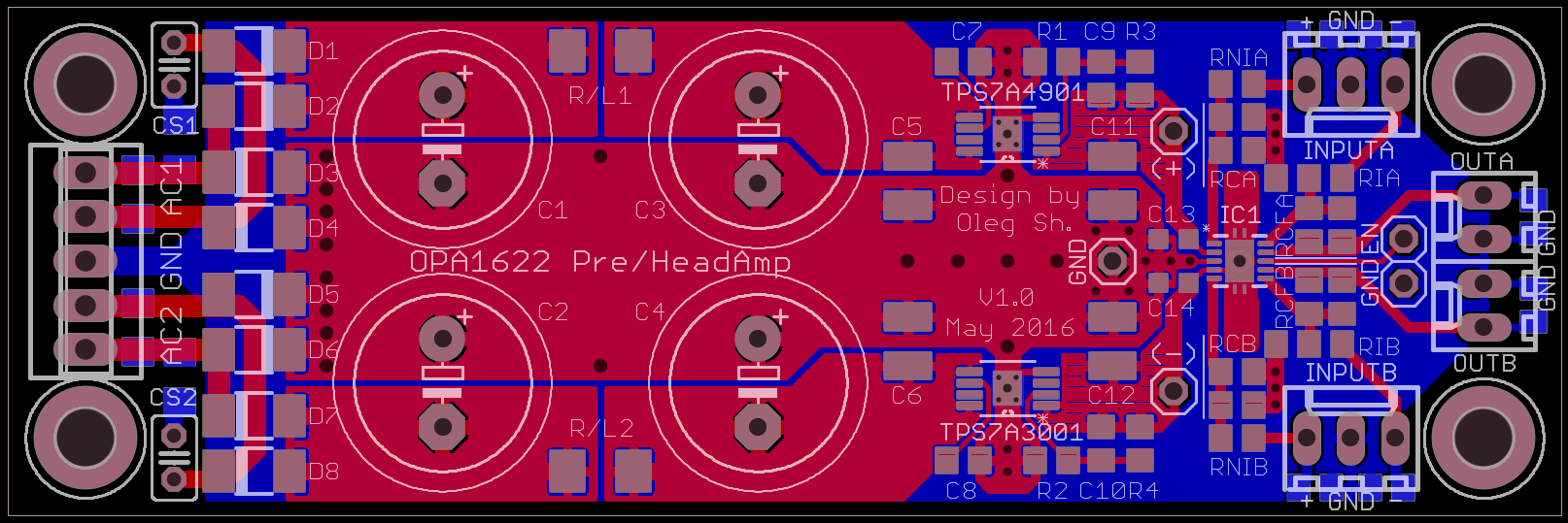

While preparing the boards for manufacturing I decided to once again look carefully at the design shown in the previous post. One thing that I can't make totally clear to myself is the connection between signal and power GND planes. At the moment it is done at the left side of the IC1 (OPA1622) by introducing two vertical cuts in the otherwise continuous GND plane to avoid supply return currents traveling under the non-inverting opamp inputs. The question is if such a GND separation is really necessary? Or it is better to use a continuous GND plane all over? Could someone help me to resolve this issue?
Oleg
I personally do continuous ground planes. Adding slots to force return currents onto a new pathway is basically just adding impedance to the ground return, and in my opinion that's never a good idea. If you're worried about the return pathway, you could change the connections to the output connectors so that the ground is now the pin closer to the centerline of the PCB
Hi John,
Thanks a lot for the hints! My concern about the return currents path is due to the increased currents in headphones amp application. If this would be an ordinary preamp with tiny currents involved it would not be a problem at all. So, I've taken your advice and removed the GND plane slots. I've also changed the output connections and placed GND pins close together near the center line of the PCB.
Oleg
