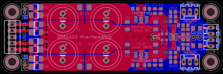

I don't know if you followed the OPA1622 thread but Patrick of Xen-Audio (EUVL) came up with an adapter PCB design here. Even if it is not the DIP-8 adapter it is better because it places all the decoupling and feedback components very close to the OPA1622 which is difficult to achieve on a smaller DIP-8 adapter.

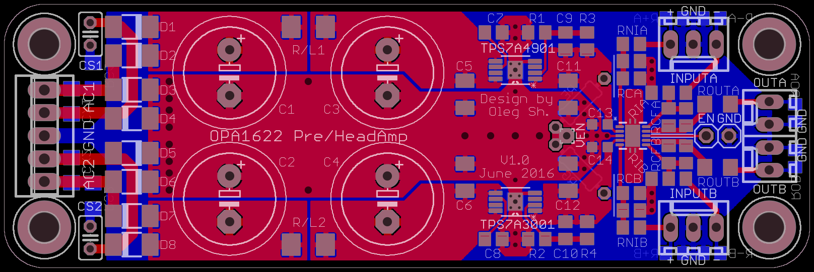

Slightly modified the design. Added output resistors pads... just in case🙂
I also have a question. I've made SMD pads for 10uF ceramic capacitors (C5, C6, C11, C12) recommended in the datasheet for the regs. I assumed 50V rating and X7R dielectric. Such capacitors usually come in 1210 package and are very thick. The question is, what is more important around the regs in my application, actual capacitor value or its size (parasitic inductance)? The regs are "Stable with Ceramic Capacitors ≥ 2.2 μF" as datasheet says, it also mentions X5R dielectric type as appropriate. What it does not specify is the actual capacitance which they need for stability. So, would it be OK to use 10uF 35V (or even 25V) X7R caps (they are available in smaller 1206 size) assuming that this board will not see more than 20 VDC at the regs input? The charts in the i-net show that X7R caps lose around half or even more of their capacitance if biased close to their rated voltage hence the question.

50% reduction in capacitance at rated voltage is the standard rule-of-thumb for power supply design. I would think that 10uF 35V X7R caps would be more than sufficient in the design. 25V seems too close to the proposed input voltage of 20V.
Thanks John!
I'll shrink the SMD pads to 1206 size. In the real line level application with the gain of 1 or 2 the regs input voltage can be around 12 VDC or less. In the unlikely case that someone needs it higher there are 10uF 35V rated caps in 1206 package.

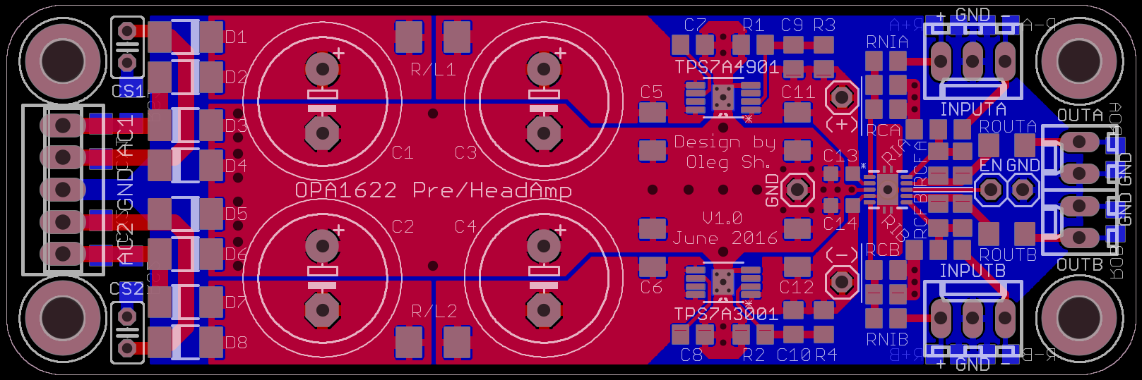

I've updated the design and I'm finally satisfied with the outcome. For a while I wasn't sure how to arrange the mute function without the use of external controller if the power goes down. I tried to route corresponding traces but I did not like the outcome. In the end I think it is best to implement the voltage divider between the V+, EN and GND pins on the underside of the PCB in such a way that it turns the OPA1622 ON/OFF if supply goes up/down.

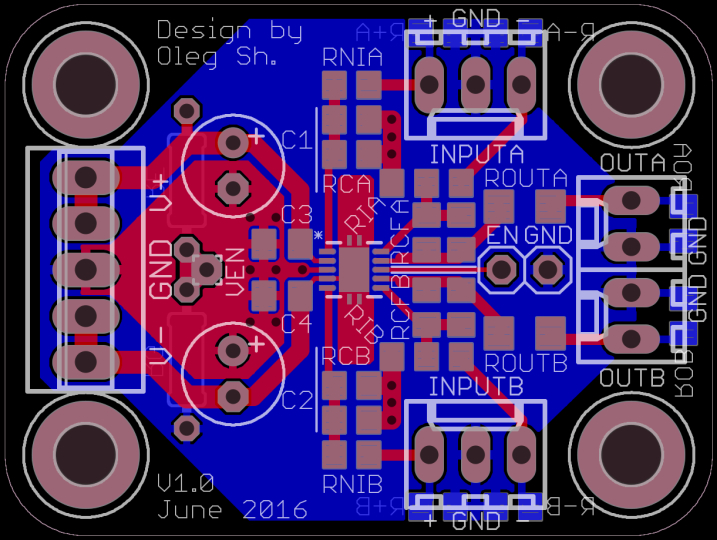

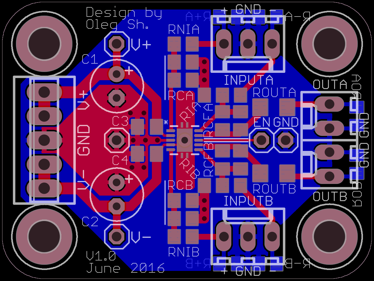

I have also made reduced version of the pre/head amp without the PSU part. This PCB is only 3x4 cm in size. I am going to order both designs with and without the PSU. Most probably I'll get a dozen of each design but I need only fraction of it. So I'm curious if there is interest in such PCBs from forum members?

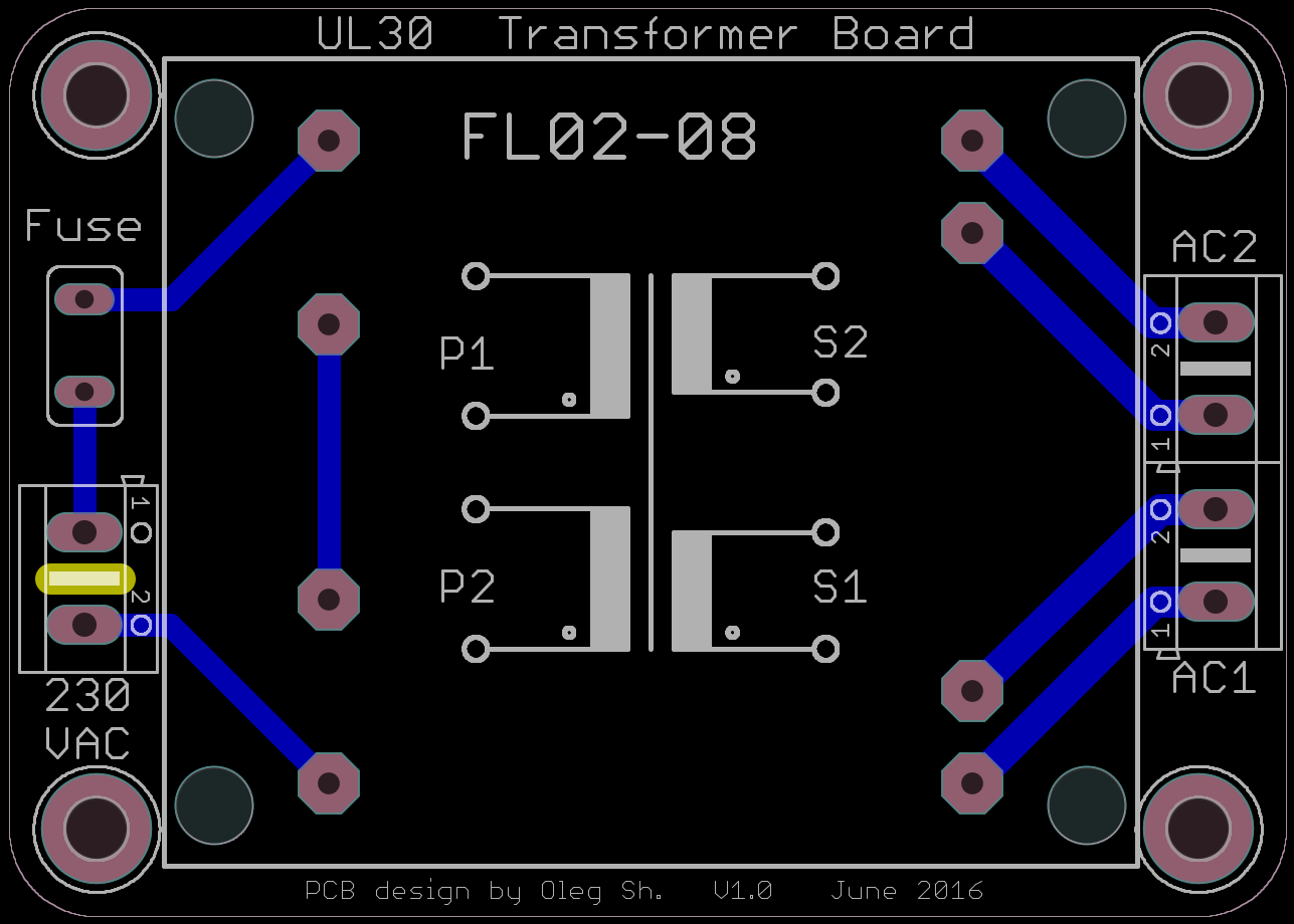

I am back with the question. I am currently looking for the transformer to use with the headamp. I;m aiming at 100mA max current draw from the regs which equals 50mA per channel max output. I guess it should be sufficient for my 32 Ohm headphones which I do not plan to run at ear splitting levels. So would it be fine to use a 3VA 2x6VAC block transformer in my case? It is good for up to 250mA current per secondary winding, is really small with the thickness of 17,6mm only and would fit in a small enclosure. Or it is better to overrate the transformer and go to the next size of 6VA? The problem I see is the enormous regulation of the smaller transformers of >50% at no load. This may create a lot of heat in the regs due to excessive voltage drop across them and the smaller transformer will run much hotter. Could someone comment what option is better?
Attached is the mains transformer PCB suitable for UI30 core 3 or 6 VA flat transformers. I plan to use it with my headamp. The board is configured for 230VAC mains only. The size of the PCB is 5x7 cm.

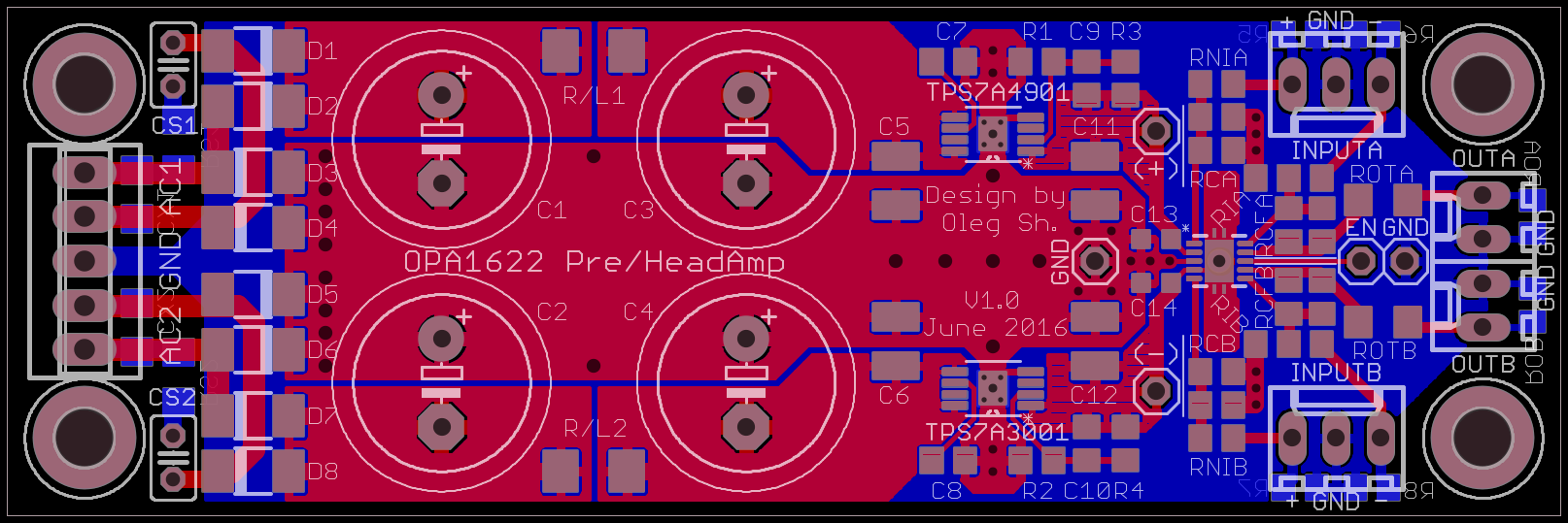

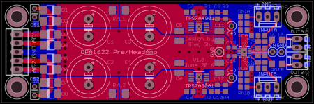

The "enable" pin did not let me sleep well 🙂 so I finally found a way to make the boards self-consistent. I introduced a voltage divider using two through hole resistors on the underside of the board. So now by selecting appropriate resistors and connecting VEN to EN by a wire jumper, the op-amp will turn ON(OFF) when the supply voltage goes up(down) above(below) given voltage threshold. Even with the VEN connected the output can still be muted by the external controller but one has to make sure that it can pull-down strong enough to override the VEN.
Also, to make sure that the "enable" jumper does not short VEN to V- under the op-amp I removed the solder pad under the chip. This makes it impossible to solder the thermal pad using regular soldering iron, but the hot air gun should have no problem with it.
