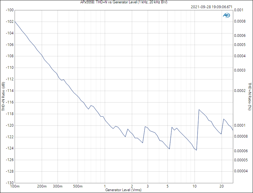

"Residual THD+N (22 kHz BW)
–117 dB + 1.0 µV
Typically <–120 dB (1 kHz, 2.0 V)"

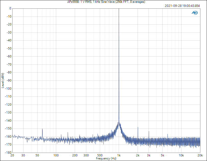

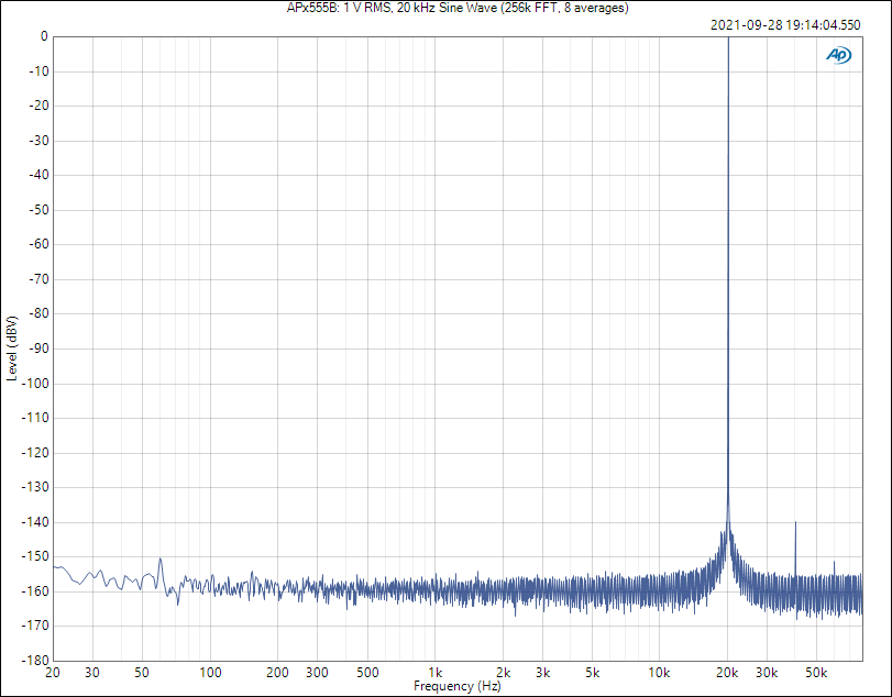

The THD (no +N) of my B-series APx555 measures about -148 dBc (1 kHz, 1 V). The 20 kHz THD comes in at -140 dBc (1 V).
The THD+N is about -119 dBc (1 V, 20 kHz BW).
Tom

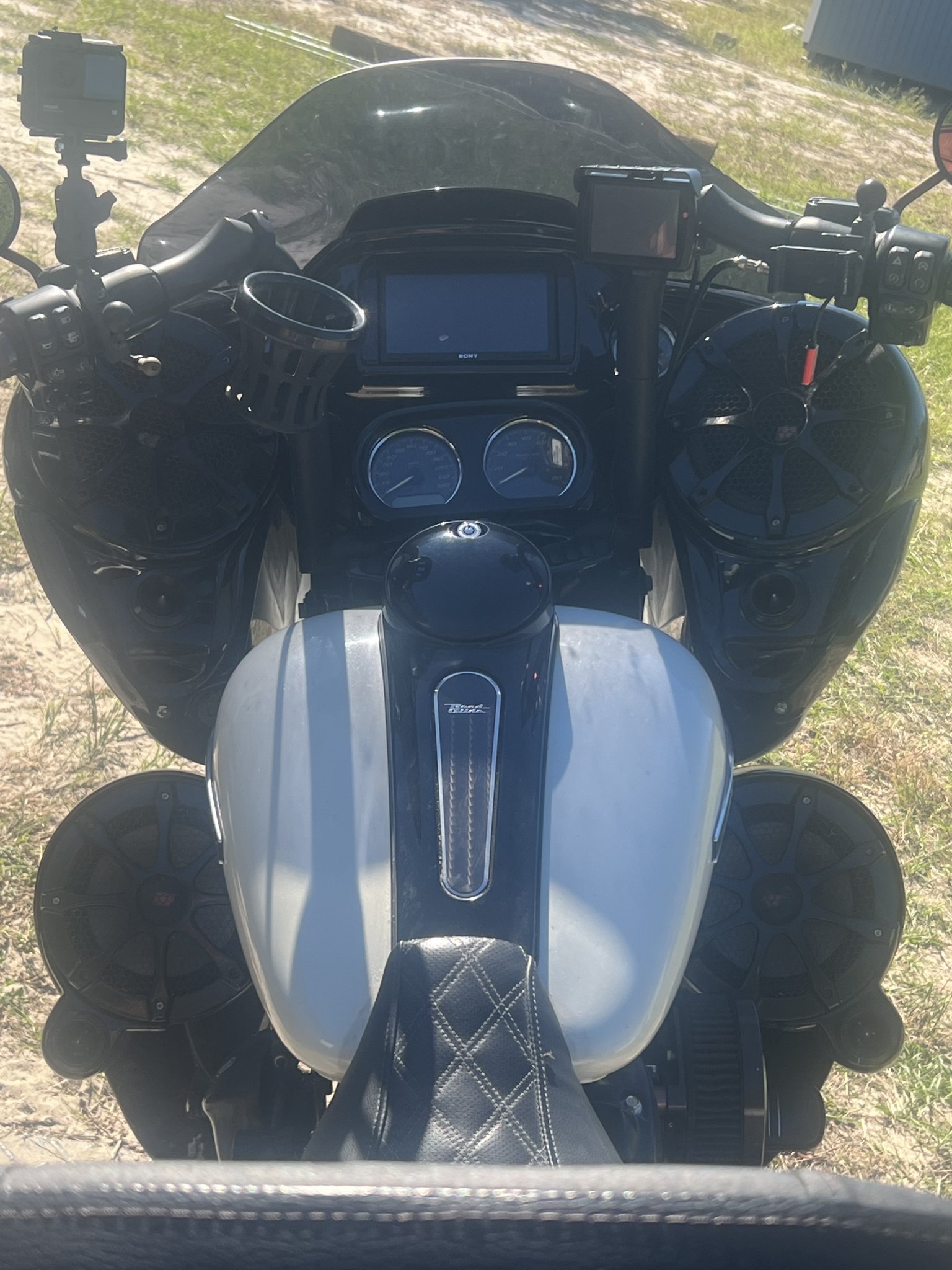

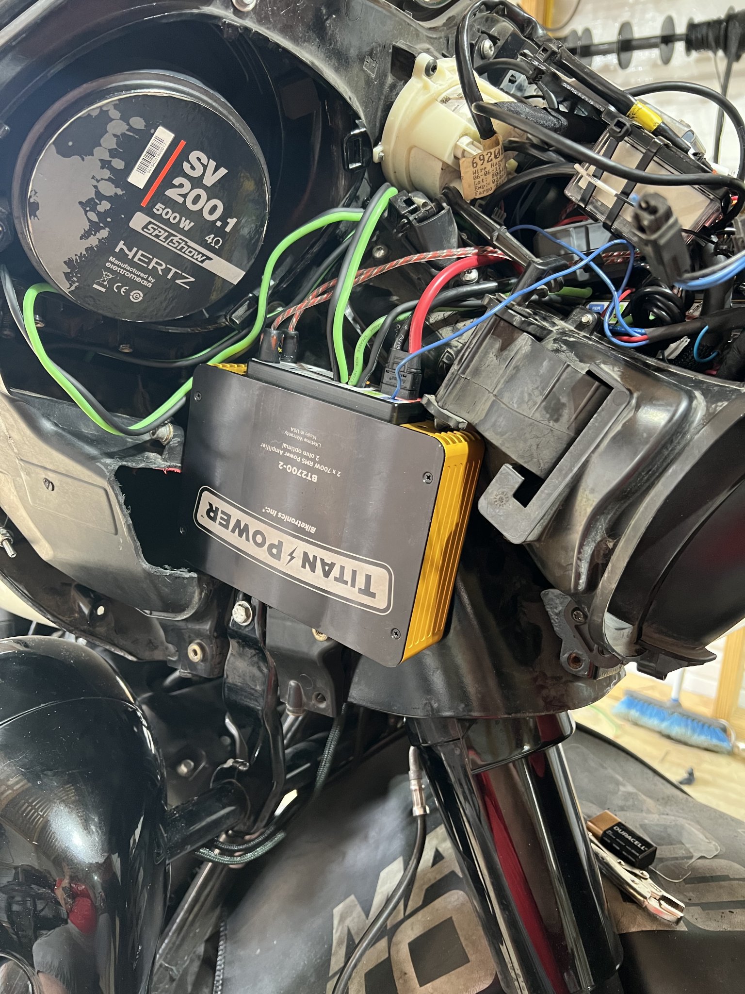

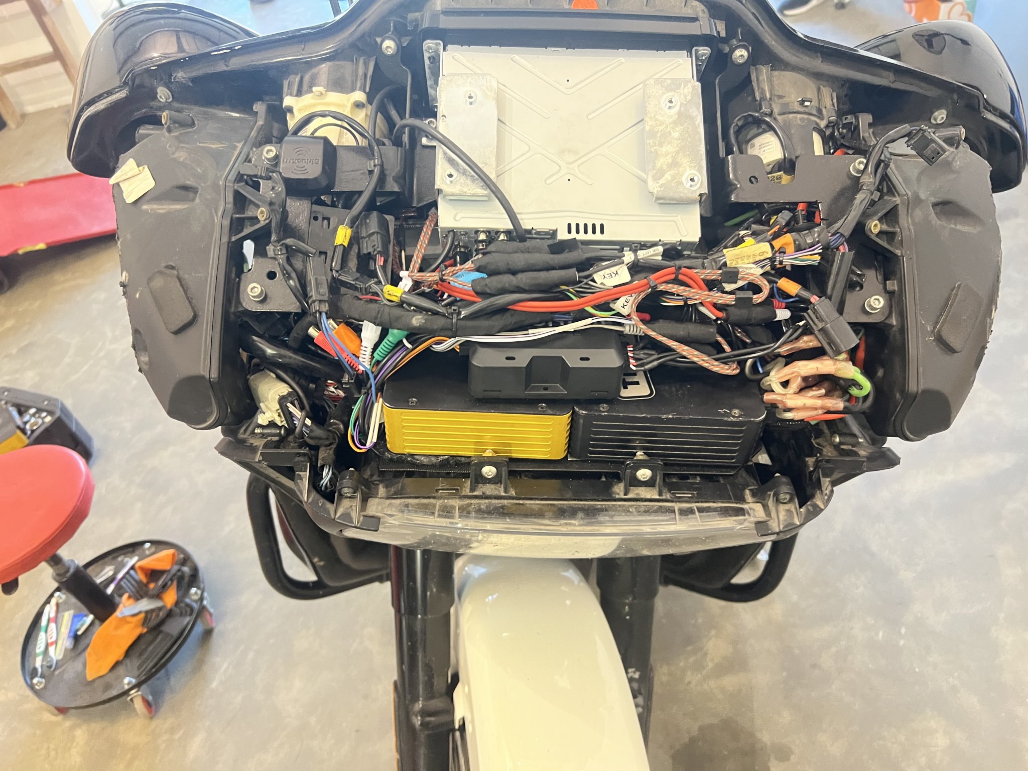

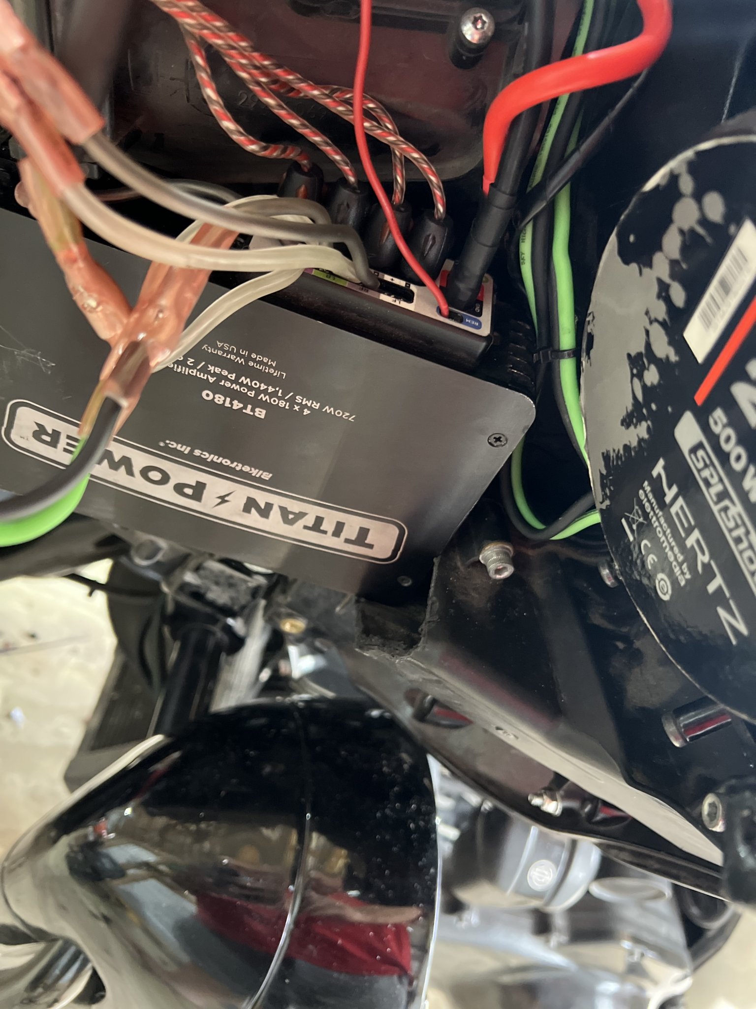

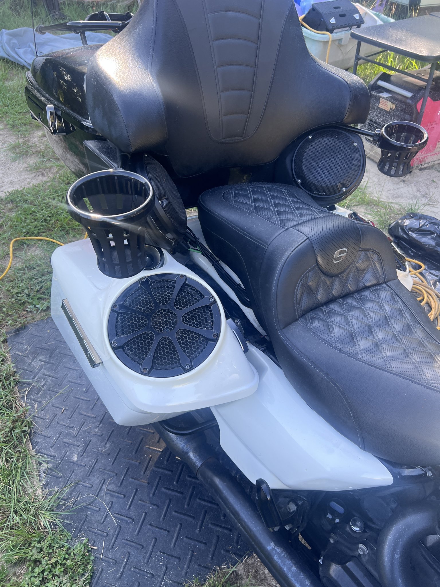

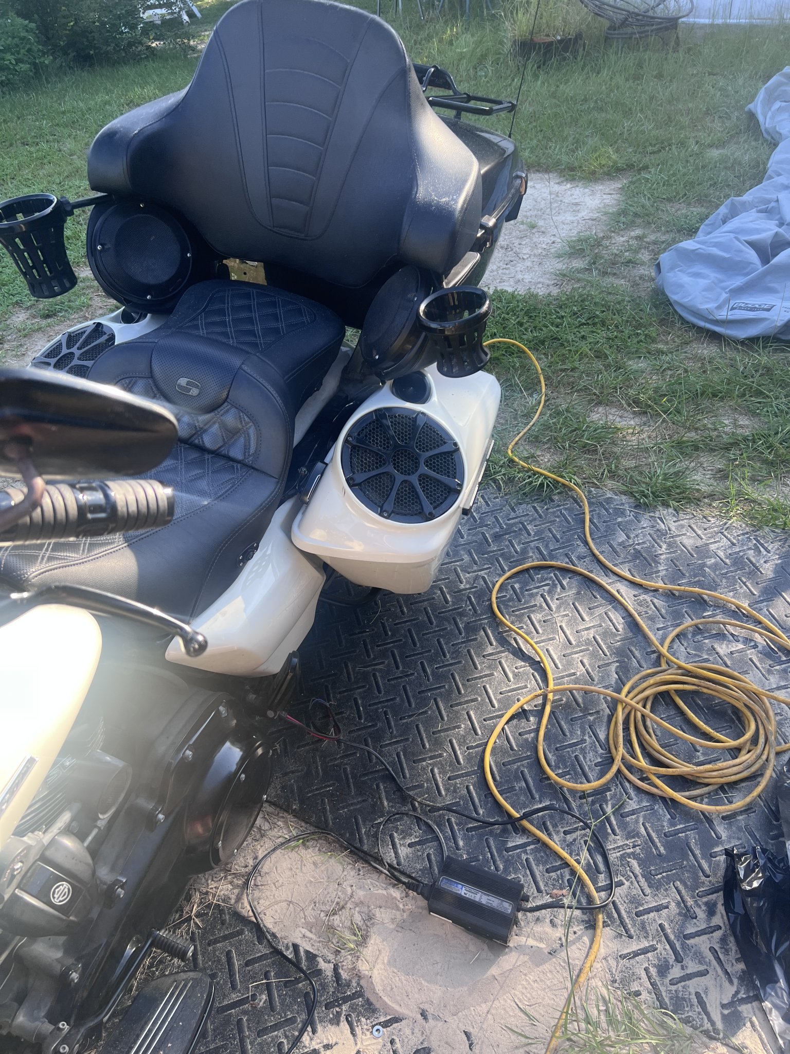

In regards to this specific quote, I am referring to using DSP products in car audio setups. These are often necessary in vehicle which is just about the worst listening environment imaginable. DSP allows us to change things in the time domain, make custom crossovers, align phase of drivers in multi way setups to play as cohesive as possible at the driver seat to place the best stage possible on the center of the car dash. Nearly all The leading automotive DSP products allow users to also adjust individual channel gains. So that makes amp gain pot becomes redundant. Hence the answer to the proposed question of why no gain pots on certain Biketronics amps.
I use Biketronic amps on this.
6 8” soon to be 8 8”
6 horns soon to be 8
2 Hertz ST35’s & 4 Hertz ST25’s
