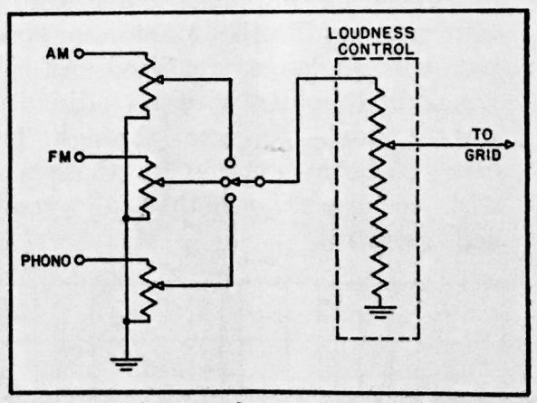

Earlier in the thread you mentioned that when using potentiometers with this buffer, lower value was better. Someone asked about using a stepped attenuator vs a pot and I think you missed it because I didn’t see your answer to the question. I’m curious because Goldpoint offers 24 position attenuators with unstuffed PCBs to allow custom values (see here). According to the table at the link, a 5K attenuator is possible, as are even lower values.
I was interested in your thoughts as I would like to use a balanced stepped attenuator with your buffers. See attached block diagram for reference.

A stepped attenuator will have just as much Johnson noise / thermal noise as a potentiometer. A 10 kΩ attenuator will have the same noise performance as a 10 kΩ pot.
Lower is better for thermal noice. After all, en = 4*k*T*R, where R is the resistance. But lower resistance of the pot/attenuator also means greater load on the source, which brings higher distortion. So that's the tradeoff.
Tom
That makes sense Tom, thank you. My desire to use a stepped attenuator is because it lends itself better to loudness compensation circuitry that I plan to be able to switch in/out.
Do you think 5K is the sweet spot for a pot/attenuator?
Depends. If the source is a modern opamp such as the LME49720/LM4562 or OPA1612, OPA1656, etc. you could go even lower. Maybe even as low as 600 Ω, but you're not likely to find a commercially available attenuator with that low resistance. 5 kΩ is available on special order from Alps (MOQ 500). So most likely you'll have to settle for 10 kΩ, but if you can find 5 kΩ and have a modern source, use it.
If you're using a tube amp to drive the attenuator, you'll probably want 10-20 kΩ minimum.
If you do find a low-resistance attenuator, watch the power dissipation. 🙂
Tom

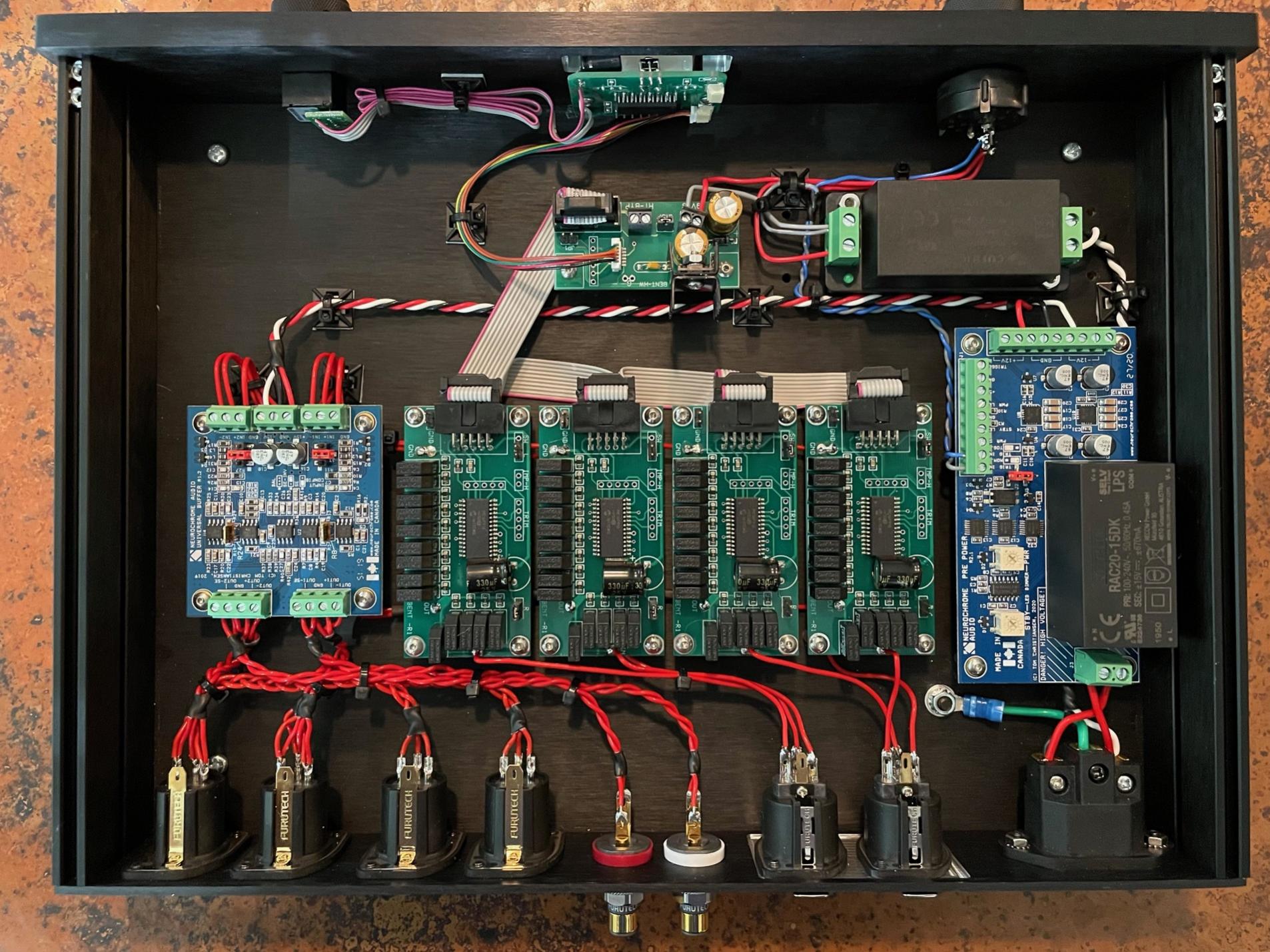

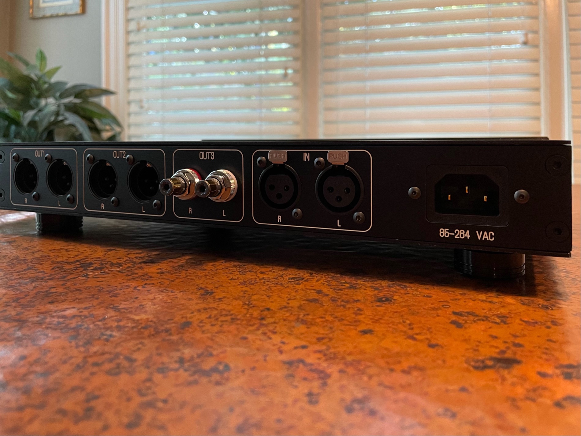

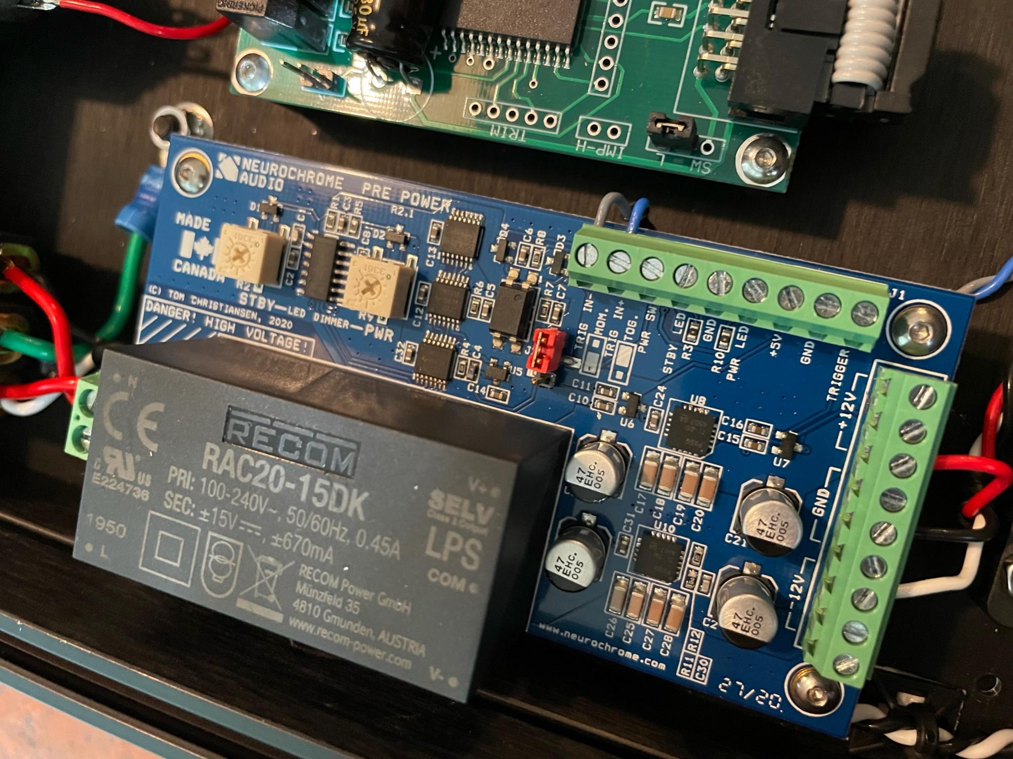

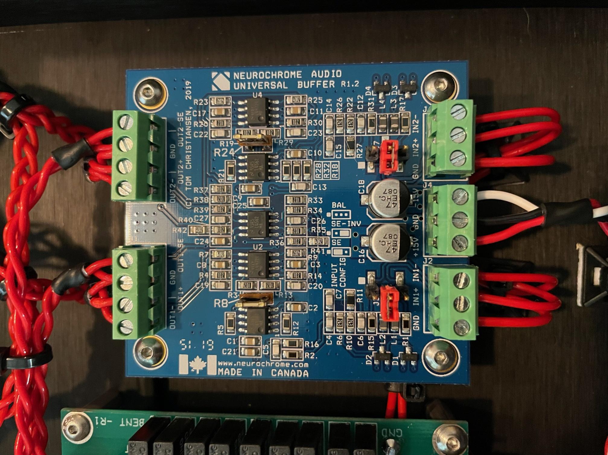

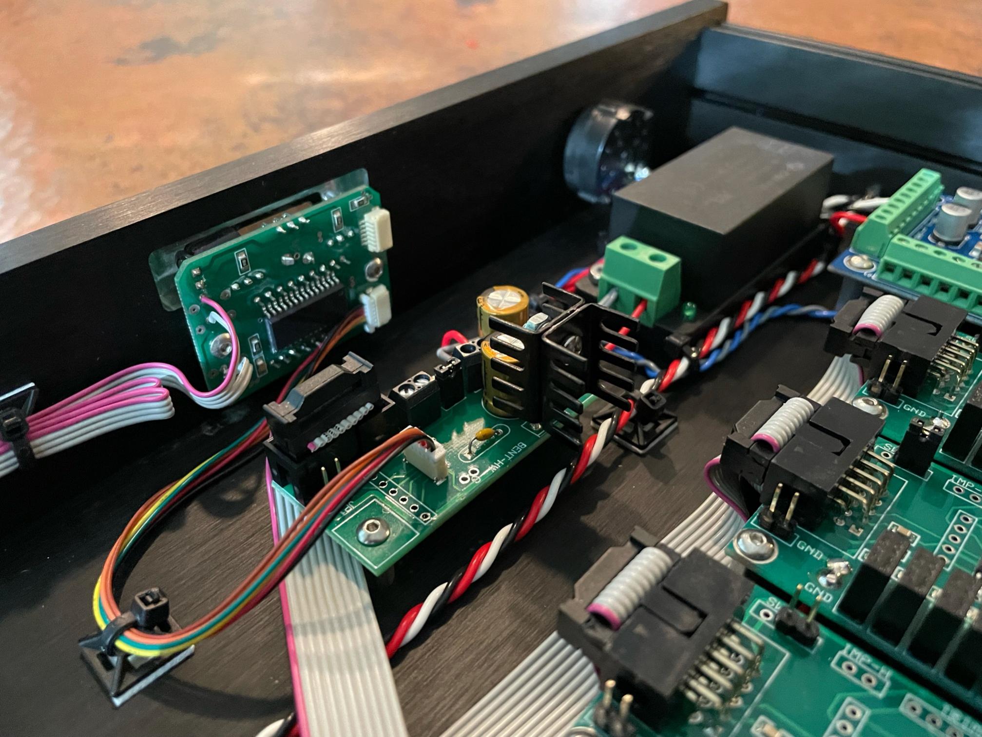

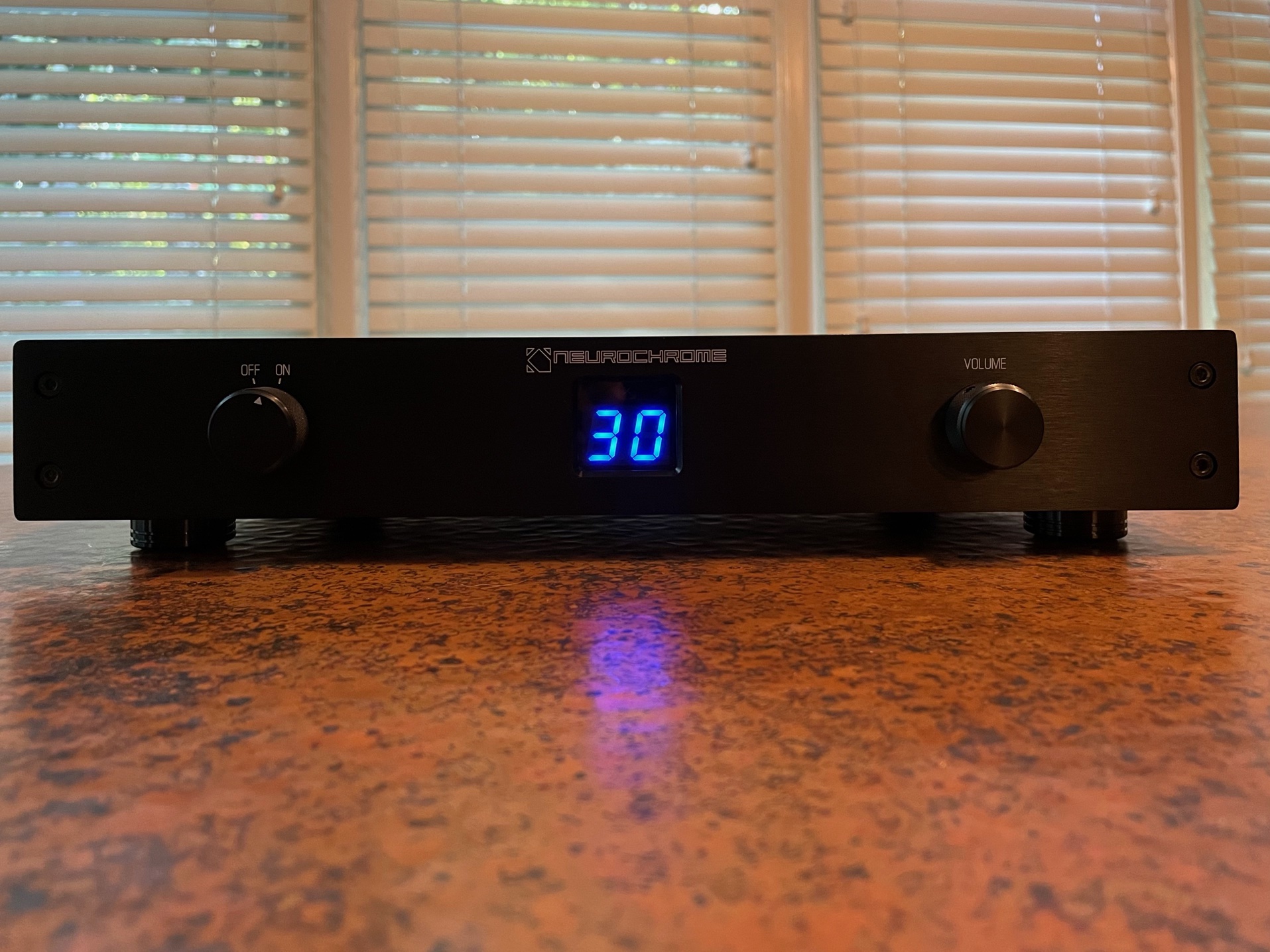

Hello All:
I recently completed a repackage of my universal buffer into a preamp with volume control. I included Tom's Preamp Power Supply and a fully balanced Bent Audio volume control using 4 Hybrid Resistor Attenuator Modules (10K). I built the preamp using a DIY Audio Store Galaxy 1U chassis (330x230mm). Front and rear panel panels milled by Front Panel Express. It is purposed built with one balanced input, 2 balanced and one single ended outputs. The buffer board is configured for 6dB of gain. Furutech connectors and Neotech OCC wire used throughout.
I am using the preamp with a Holo Audio May DAC, Neurochrome 686 amplifier and 4 powered subs. The results are exactly what I was after; totally transparent sound, remote controlled volume and 6dB of gain. I did not want to impact the sonic signature of the May DAC and that was achieved.
