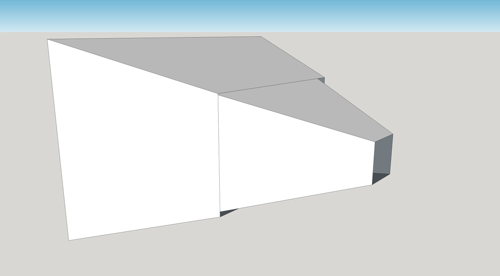

My Sketchup drawing was a virtual prototype on the physical aspects and then I went CNC because I didn't trust my woodworking skills. To do a clean a job as you've done with just a circular saw (=dropsaw?) is impressive.

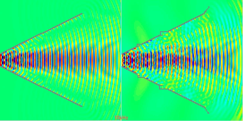

Hornresp can't simulate wavefronts properly above 7000hz. (It throws a warning about this when you try.)
The trick is to scale everything.
For instance, if you want to see the wavefronts at 10,000hz, make the model 10x as large and run the simulation at 1000hz.

Good point and good idea.
Another thing to keep in mind is that HornResponse wavefront models are for an axissymmetric horn (i.e., perfectly round, not square or rectangular). So if going non-round take the results with a grain of salt.

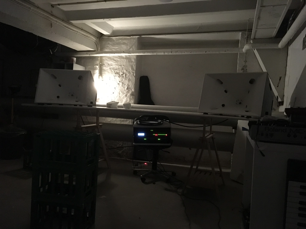

Guys, I just put the speakers together and I'm simply speachless...
I have never heard a synergy horn before, I have just imagined how it would sound like...
The speakers I've build sound heavenly.
They lack some frequencies in the bottom, but the mid and the high is supreme 🙂
Thank you very very much for all the help, advice and contribution.
I'll make write a report with measurements, in a few days.

Yeah, pretty amazing aren't they. I remember I was stunned the first time I got a crude one set up. A cluster of drivers outputting though a bunch of holes through pieces of wood doesn't seem sophisticated at all, but it seems to check a lot of the items you might want in a speaker.

With the next release of Hornresp it will be possible to directly simulate wavefronts up to 20000 Hz using a resolution of 135 x 135 elements and an element size of 0.2 cm, equivalent to a window size of 27 cm.
Also, when the frequency and element size settings are such that the definition is too low, results containing aliasing errors which could potentially mislead users will no longer be shown. A warning message will be displayed instead.
