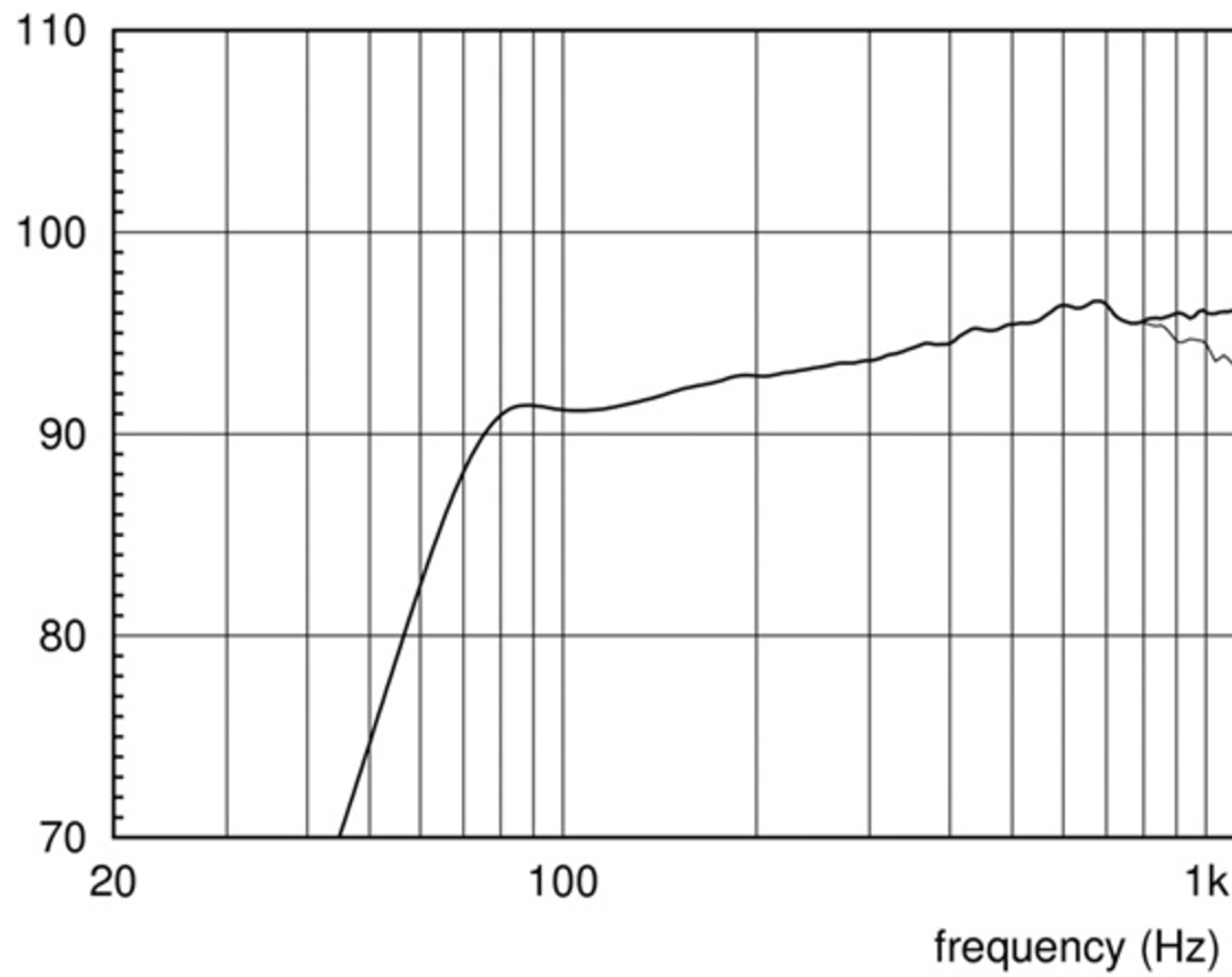

I try to understand why you can't get the 10" below 100hz, its freq. range is from 55-4000
It's not such a surprise if you look at the frequency response of the driver. 55Hz is the -10dB point.
attachment.php
Pro woofers don't have the correct TS parameters to go much lower without venting as nc535 said. Hifi woofers have better parameters to go lower but aren't used in PA applications because they don't have enough output. At home that is not such a consideration.
