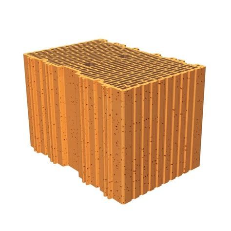

The functional principle of KEF's metamaterial absorber concept is not exhibited in the examples you've shown.
Because the examples are not there to illustrate Kef patent I surmise to be half blah. Especially the 2D maze...

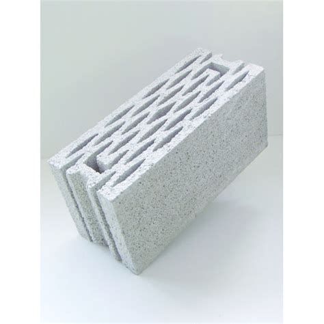

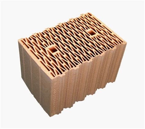

Bricks like that could have a bad effect like a resonator.
I am even not sure it works the same in a sealed or vented cabinet if we talk about the mid rear dome...at least partally rear of the cone. We should discuss more about the patent elsewhere. I am more towards mass spring mass effects or would say meta is another...horn. we have maybe partially something pushed by a marketing dpt to push sells. I would like a phD discuss about this patent concept before we do 3D hersatzs. If the meta bidule is an helmotz trap or something else I would be glad to know what really phisacally happens, not convinced by the patent or mkt description about the maze meta effect. At a point something else still diy could be even better... While our diy felow is inventiv, for sure....

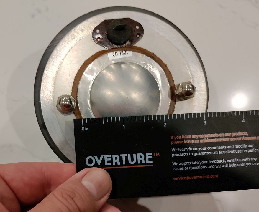

How come I can see the base of your finger through the magnet you're holding - where'd the dome go?
The backside surface looks like a complex crosshatch pattern; is that acoustically transparent, or just a 3-D print way of making a solid wall?

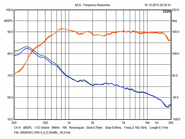

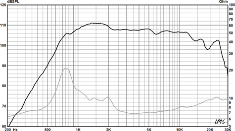

I could've sworn that I uploaded the measurements of this thing, but I can't find them on diyaudio
I may have missed it, but just in case I didn't, here they are:
frequency response on the Unity horn pictured above
distortion with a 3rd order highpass at 1200Hz
Attached is what Troels measured
A couple of things I noticed:
1) It sounds a LOT cleaner than "stock", and the "stock" tweeter is already really good
2) In the distortion measurement, you can see the interesting effect of the metamaterial. That it's basically nullifying the distortion at certain frequencies
3) Because the back chamber is easily 10x bigger, you can see the rolloff is much more gentle

Those are seriously interesting measurements. Do you know if the dips in distortion corresponds with the wavelength of the resonator-tubes in the metamaterial?

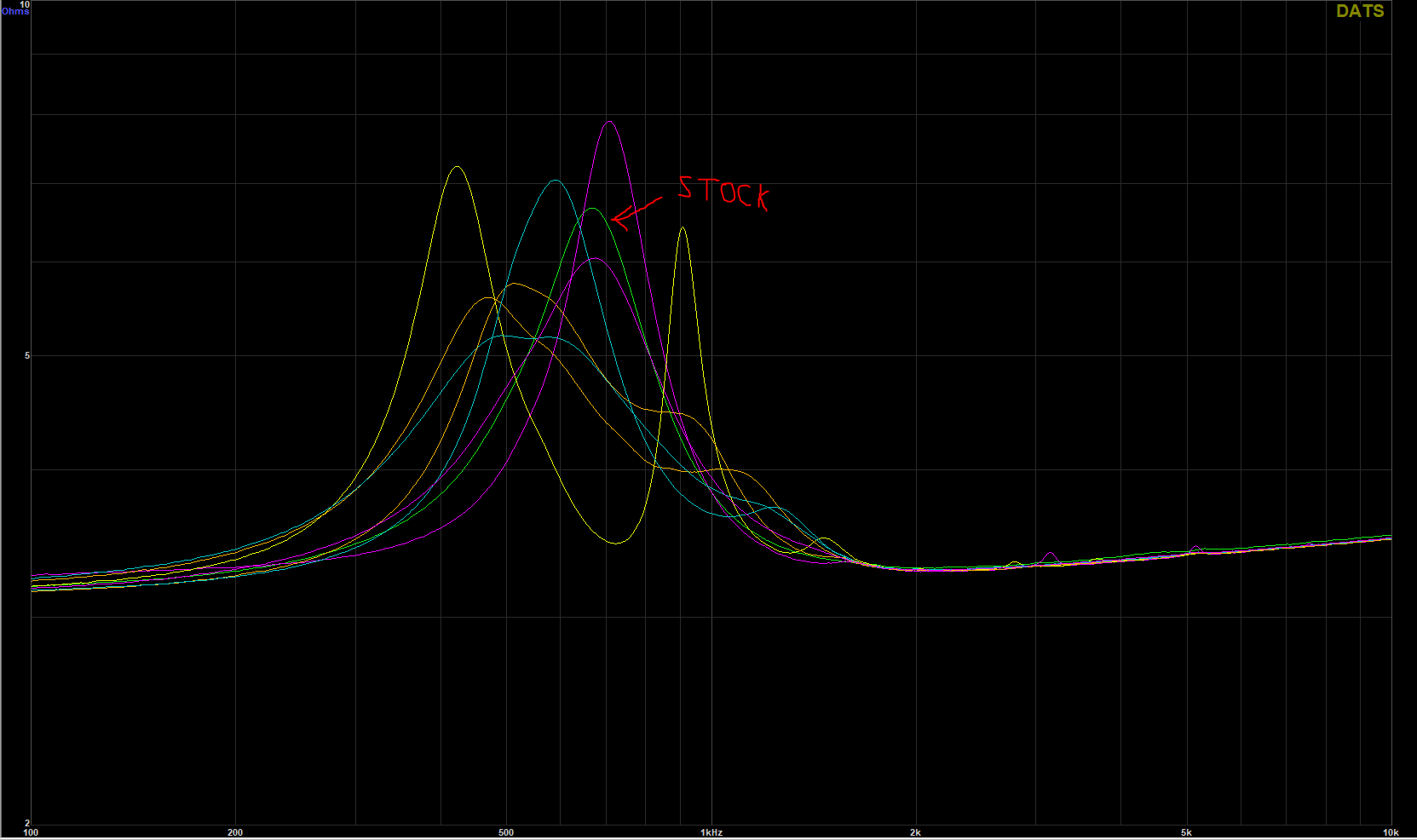

Here are the results of some of my efforts to improve the 26adc's performance mainly between 1-2khz. The green line is stock, and looks like the best overall solution. I tried different shapes, sizes and filling materials. I wanted to try metamaterials, but lost the inspiration to do so. I'm now stoked to give it a go. The goal is to see how low it can be crossed in a XT1464.

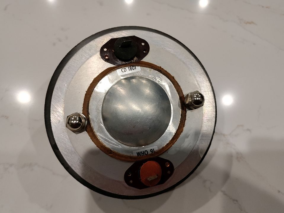

1) find the right one. It must have a back chamber that can be removed. Or sawed off, if you're willing to sacrifice a driver.
2) Ideally we want one that's not so small that it will run out of displacement, but not so large that it can't hit 20khz.
The reason that this "trick" works is because compression drivers are generally engineered for maximum output.
For instance, a typical compression driver with a one inch throat has a diaphragm that's 1.75" wide. Compression drivers barely have any displacement at all; let's call it one millimeter (and that's being generous.)
