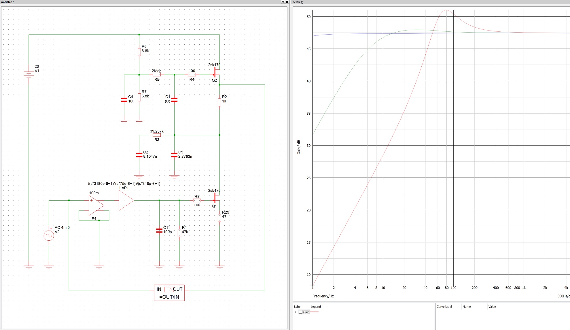

Besides you can use 100...220nF there instead of 68 uF.It is used mostly for coupling the RIAA network.The dc bias is fixed and external instead of autobias and you don' t need so much coupling capacitance.A mu- follower needs a higher value source resistor and the RIAA network would have been placed at the source of the follower transistor.

Along this process it became quickly clear why the cap needs to be large ... at min in a medium 1-digit µF range.
So, yes, it makes sense.
As for the gain=-1 buffer application: You could omit with it by just connecting the pickup inverted .... or, if You don´t believe in ´absolute phase´ 😉

Here a quick example. It's not the same circuit, just quick and dirty with some random components and a riaa network. Notice, that the capacitor C is places at another position. The three results are for 220n, 3.3u and 68u.
