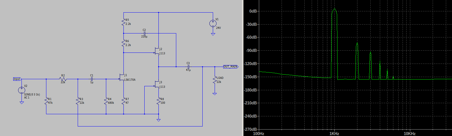

Thanks. At the moment I simulate a THD of about 60dB! 🙄 What do you think is the "best way" to invert the signal and minimize THD using JFETs?
I agree with reply #4 , doesn't make sense to use JFET if minimum distortion is in priority list. To get right THD numbers you have to build discrete OPA using twice more components compare to BJT, this explains absence of pure JFET OPA.
JFET is good for exactly opposite - to Generate distortion. Same way and fashion as tubes do.

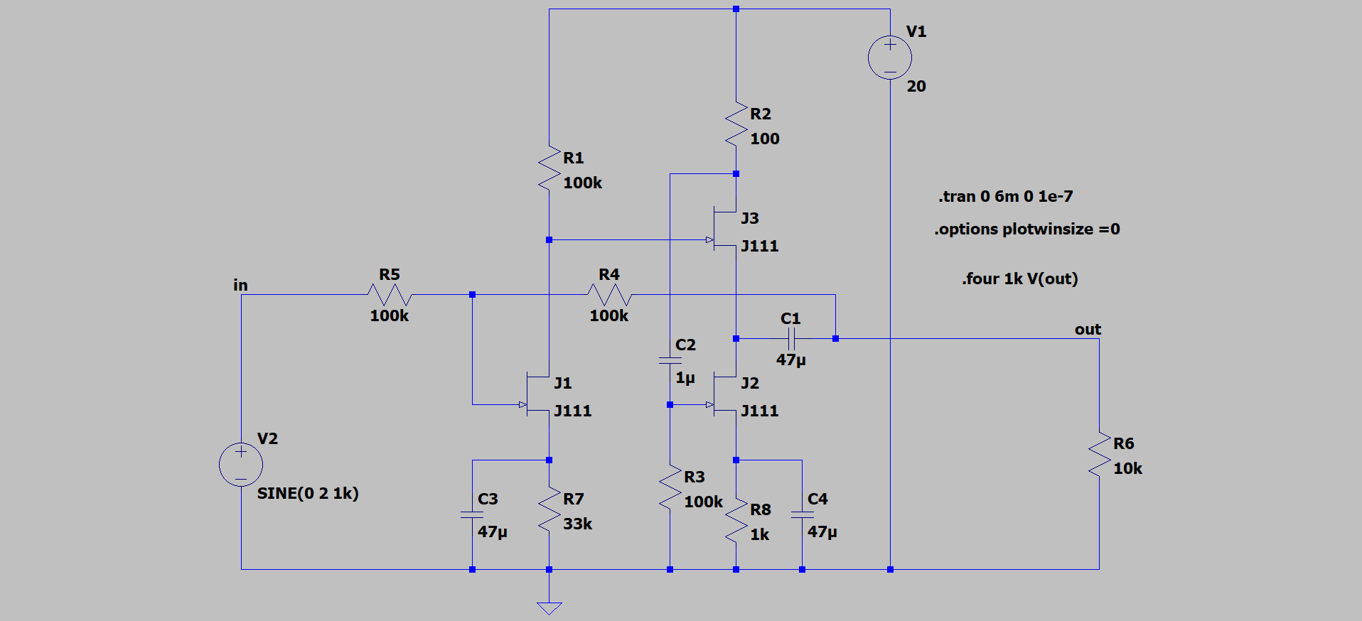

If your OK with the distortion profile, something like this is the first thing that come to mind:
Output level is 6Vp-p at 0.12% THD.
Thanks, I have to compare all your proposals im more details later, but thanks for the great input.

Thank you to all of you for your great support. At the moments @KSTR 's proposal with some addaptions provide good results for me.

I use an JFET inverting high gain amplifier at the input of the phono stage. The only reason I'm working at this inverter stage is to bring the signal back to the "correct" phase, knowing that it should not be necessary at all. The input voltage will be smaller but I try to stay at acceptable THD below 4Vpp.
So what is the design objectives ?
Gain -1, Single Supply 30V, NJFETs, Zero Global Feedback (ZGF) ? Preferably low distortion for 4Vpp ?
For a simple circuit with ZGF, a phase splitter followed by Source follower comes to mind.
But the supply voltage sets some limitations to the phase splitter.
The JFET sees the fully 4V swing at maximum input.
So it needs at least 7~8V across D-S at no signal.
The drain resistor has to be a touch higher than the source resistor to be truly inverted unity gain.
So they should get ~6.5V and ~6V respectively.
The bias is determined by the resistor values. Let's say 4mA as a starting value.
The source resistor is then 1.5k, and 1/Yfs of the JFET is roughly 40R.
That basically determines the amount of distortion at the output.
For 20V, H2 is about 0.05%, and H3 ~10x lower. Tube sound.
At 30V, the values can be halved.
