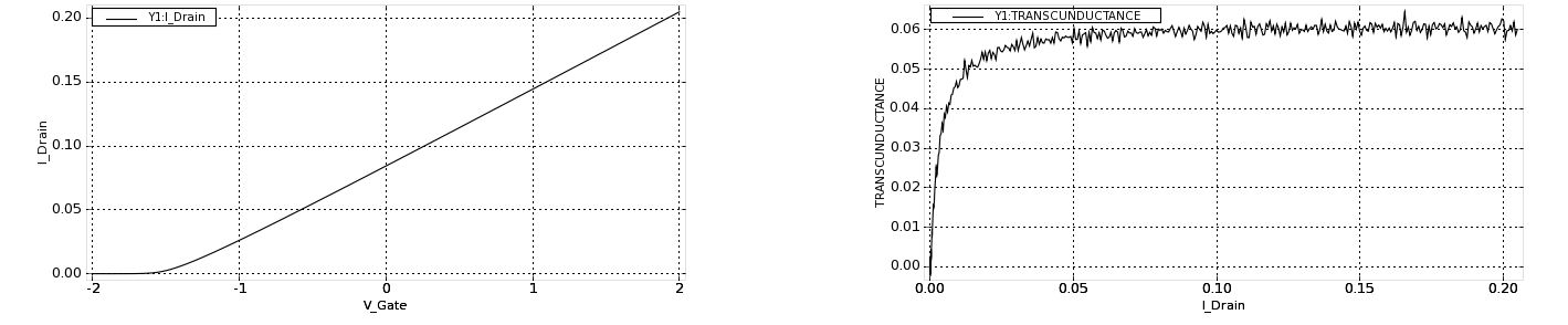

LU1014 Vgs-Id curve
Vgs-Id plot for the LU1014 at 7V Vds as well as gm/transoncductance plot
Next step. Choose bias conditions of Vds=7V, bias current ~100mA. The self bias resistor will be ~13 ohms. I have some 15 ohm resistors in my stash. I placed a 15 ohm resistor from SOURCE to ground and ran the Vgs-Id plot and transconductance plot. They are attached.
The self bias point appears to be ~ 80 mA and the transconductance plot looks very linear with enough gain to almost fully drive rail-to-rail operation with 2v p-p input.

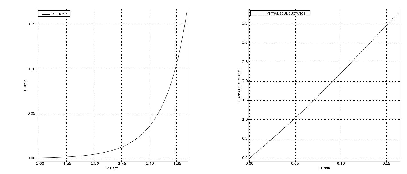

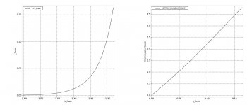

Hello Patrick. Thank you for the nudge and the advice.
I did what you suggested and re-read Zen V9 as well as Zen V8.
I went back to the curve tracer and did some plotting and experimenting with different parts of the possible V-I space.
For a headphone amp with a bias in the 50mA to 100mA range, the attached plot looks to be the most "triodey" part of the possible V-I space. A good space looks to be Vds =6V and Id = 100mA. In the attached plot, from left to right, Vgs = -1.28v to -1.45v. For the operating point of Vds = 6V, Vgs ~ -1.32v

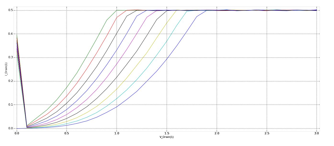

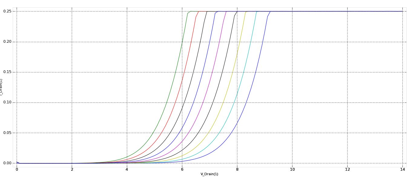

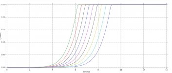

I am changing my mind. Looks just as triodey but lower gain.
I will say that the device looks triodey almost everywhere you would use it in an audio application. It is pentode looking where the device is fully on for a switching power supply.
