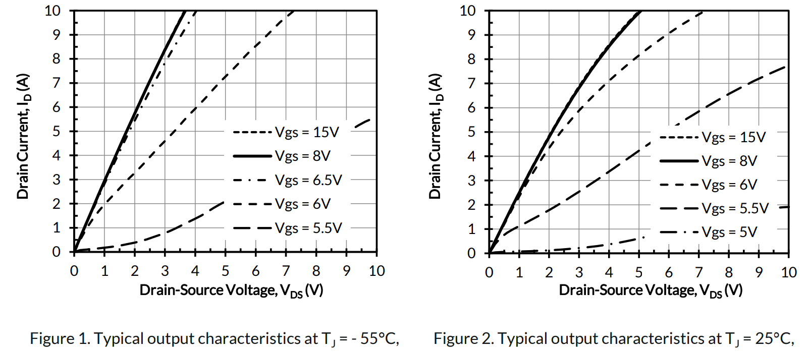

United SiC UJ3N065080K3S, Is there any triode behavior?

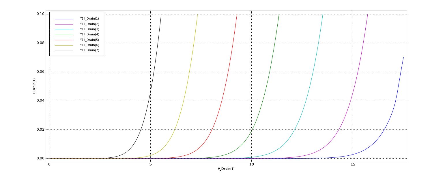

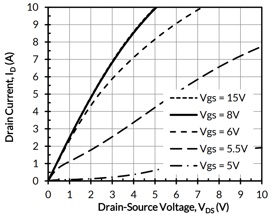

I am opening a thread for the UJ3N065080K3S SiC JFET. Is there an operation area that has triode-like behavior?
This is a thread for curve tracer geeks.
I have attached the results of a curve tracer session of mine on this JFET.

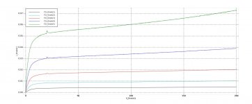

In my experience, devices that have triode-like behavior, this behavior is at high-ish voltage and low-ish current. These same devices have pentode-ish behavior at high-ish current and low-ish voltage. I will post that behavior in the next post.

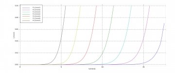

Here is the LU1014D. This family of curves show triode-ish behavior in the highest voltage portion of the plot with the most negative Vgs while the family of curves shows pentode-ish behavior at the highest current portion of the plot that has the most positive Vgs.
In this family of curves, Vgs spans from -1.2v to -0.4v.

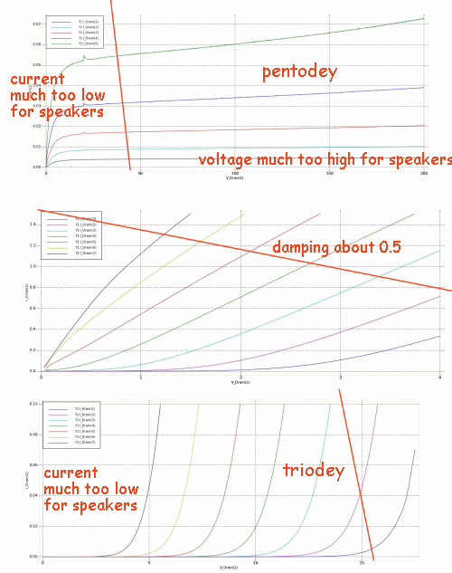

...has triode-like behavior?....

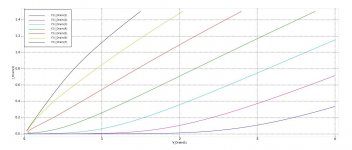

Plot a reasonable load. For speakers, plot say 5A to 40V, which is 100W at 8 Ohms.
Are the device curves more vertical (lower Z) than this load?
While your last example is triodey compared to a speaker, I'd want to check the curves at speaker-like currents.
If you are bench-tracing, it may be useful to use a 40V supply and a 8 Ohm drain resistor, waggle the gate. (This IS how you will use it to drive a speaker, though you have a choice which leg is Common.)

Good points. Thanks for the observations.
The point of the curves posted was just to separate the SIT-ish devices from non SIT-ish devices.
For the triode-y curves at low current at 15v, my interest is to use this operating point for a cascoded Zen V8 or V9-ish balanced amplifier to drive a set of Stax Gamma ESL headphones. From my research, 10mA bias may be enough. If 10mA is not enough, 100mA at 15v would be no problem.
While it is performs more like a pentode than a triode, there is another application which I've tested where they work great: cascodes!
@1-2A they bias at around 8-10V if I remember my measurements correctly. In my testing at least it can handle 30W no problem so a plug in cascode for N channel devices with 24V up to 2A. Conveniently enough that where most single ended firstwatt amps run the devices at =)
