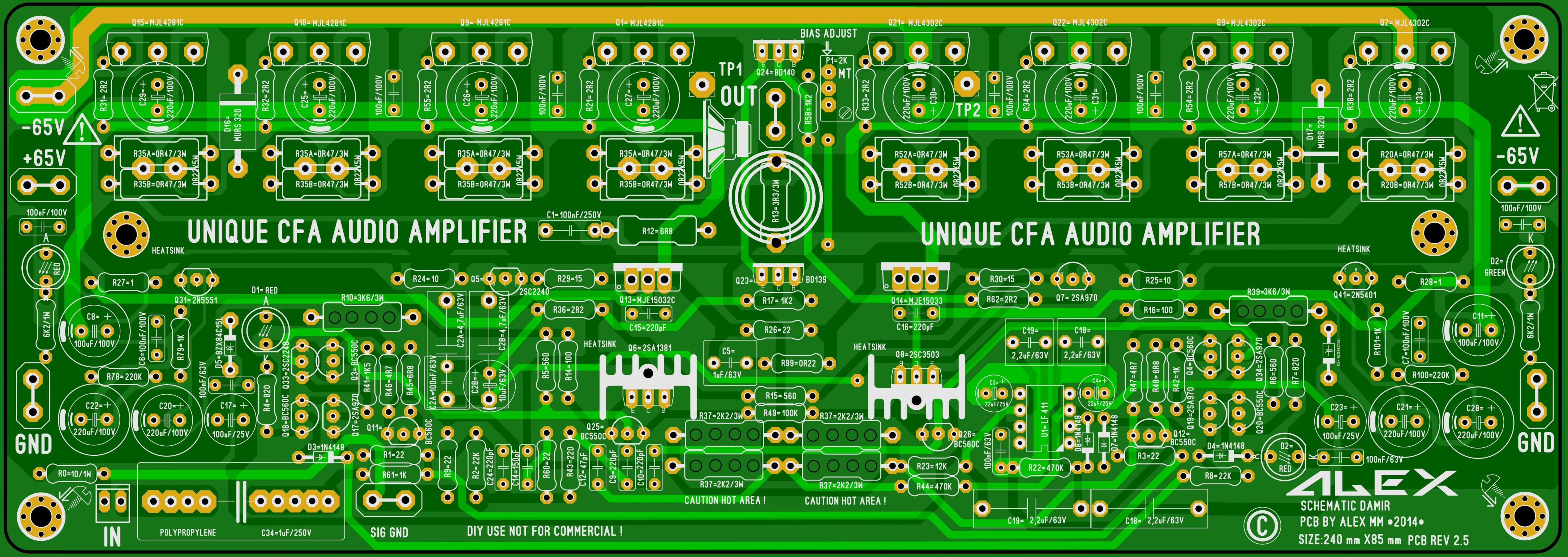

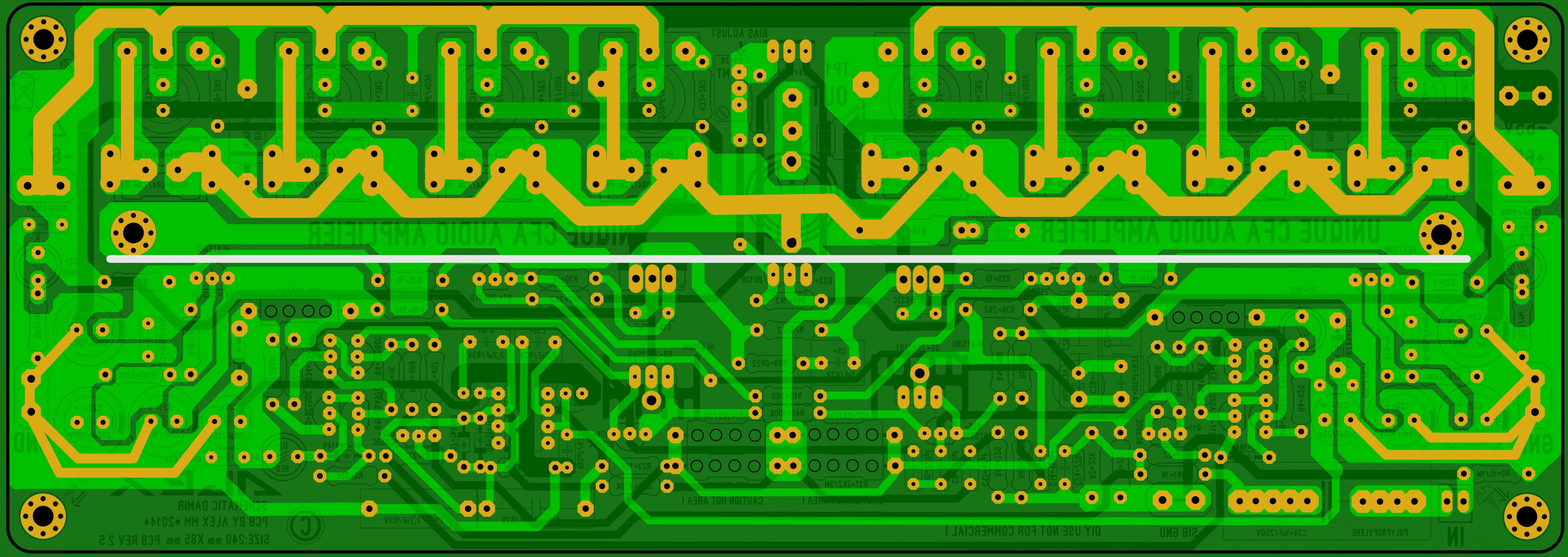

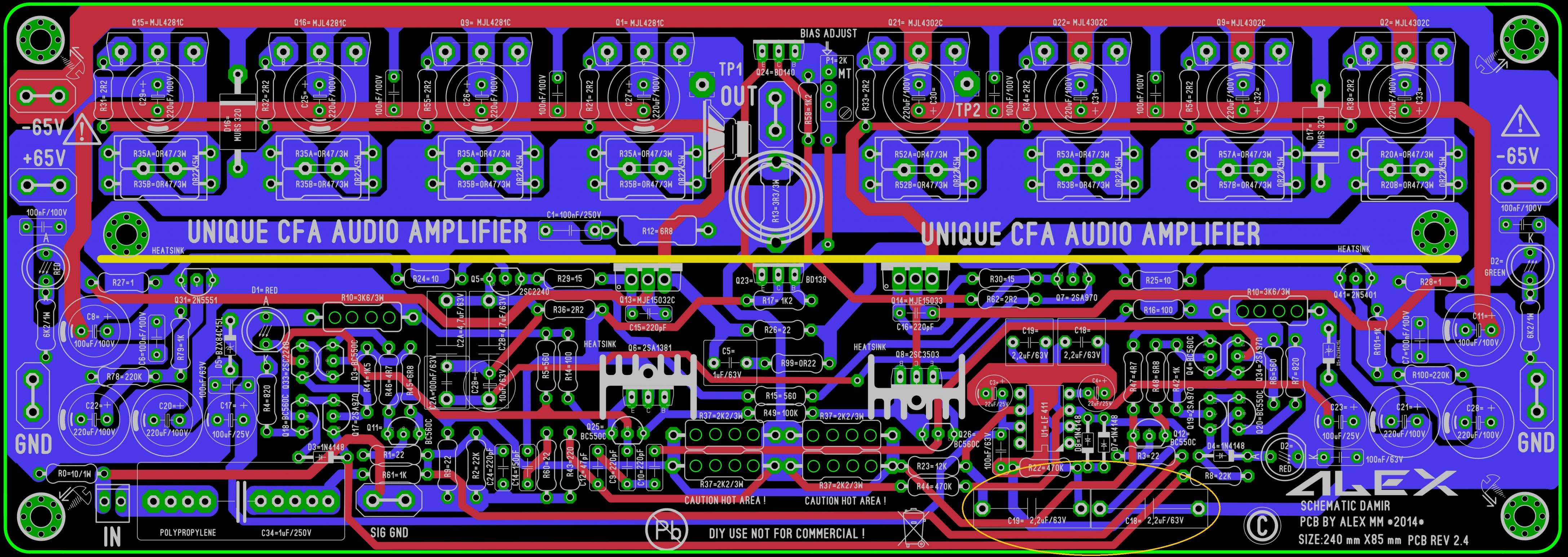

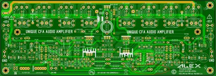

I think it's the final revision of layout , I done everything was necessary /suggested ,even more with personal contribution
Regards,Alex
Yes Alex you've done all, and it is excellent job. Just one thing you don't want to change, capacitors for DC servo, C18 and C19, and I don't understand why.
Cheers, Damir
Cheers, Damir

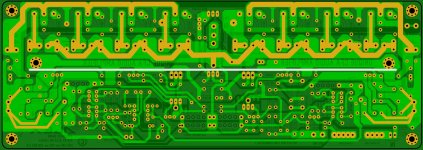

Sorry to tell you but those caps are in place , just look closer in yellow first pic, and red circle in the second pic ....
Alex
Alex
Oh yes, I was looking the same position where you still have 5mm spacing and did not notice added caps. My apologies for that.

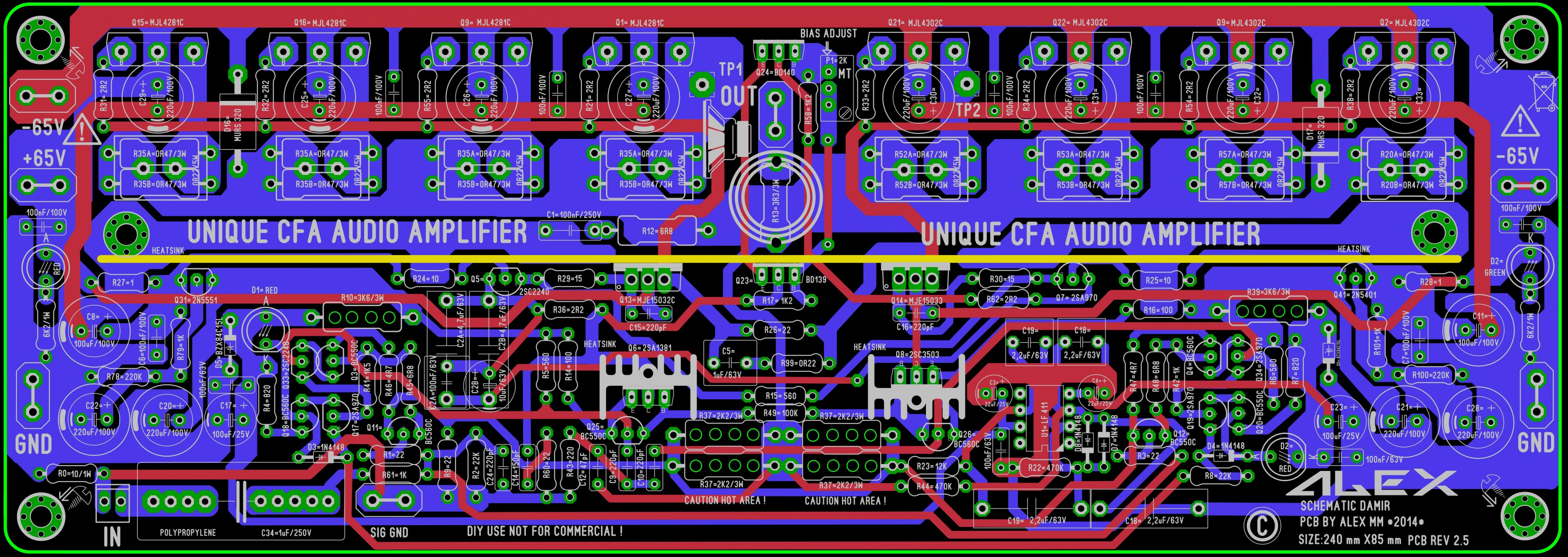

Now we have the PCB with all output transistors on one side and two possibility to fix it to the heat sink, perpendicular and parallel. I prefer perpendicular as in that way the PCB and electronic components are less heated from the hot heat sink, but if someone like to put it parallel it is possible now.
Thank you Alex, I still did not finish connection check, how sure you are that all is correctly connected?
regards, Damir
PCB rev 2.5
I have check again ,found only one bad connection ,corrected now ,and I think are no more errors IMHO so we can move ahead.....
Alex
Alex

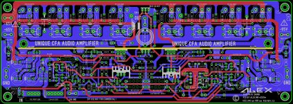

PCB files for toner transfer
PCB toner transfer files are attached may be someone will make to sing ....
Regards ,Alex
Regards ,Alex
