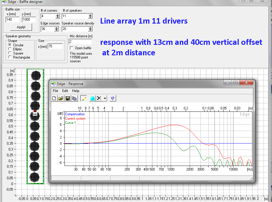

Actually it would be rather difficult to make a multiway speaker to present lobing -an example here. Lobing is a real phenomenom with line arrays without shading or curvature (see attachment).
Here a real case of lobing - a line array KS-160-21 by "Kimmosto" Listeners liked the speaker - lobing was not percepted!
My exprience with a 4-way are satisfactory. We need at least 2m distance, my usual distance is 2.5m (8') Vertical directivity humps and lobing will not be a problem easily, these malicies are overestablished generally in discussions.
