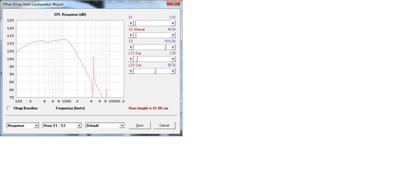

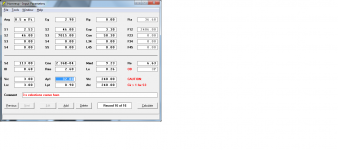

Been mucking around with hornresp to see if I can get a decent looking curve happening in a Tetra horn and came up with this.
Edit- Cant seem to upload at the moment, will try again later.
