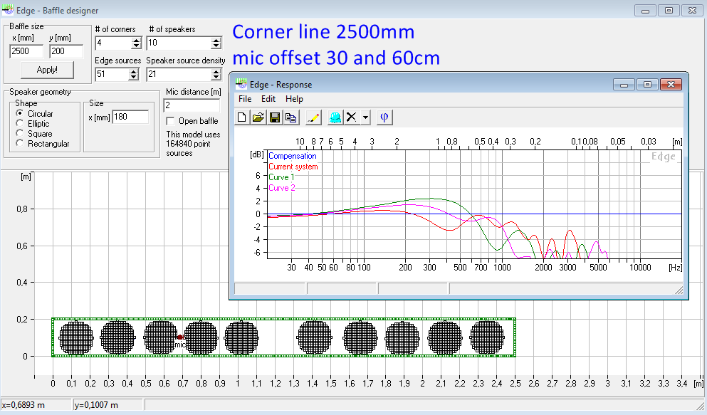

Actually it would be very easy to make a corner line of woofers, then add midtweeter some height. A line of mid/tweeters leads to serious lobing unless delay shading is used.
Here is a quick Edge simulation of 2500mm line of "el cheapo" 200mm/8" woofers. Without wall and ceiling effects. Edge suggests that drivers are fullrange. We see that response at 2m is dropping at 500Hz and with offset we see lobing at higher frequencies.
Imagine a synergy horn to the midpoint of that line, response starting at 400Hz...
Pi speakers six Pi is close to this idea...
