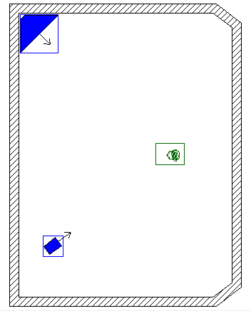

I was intrigued by Wayne's comments on the corner horn the last time the subject came up and ran some room simulations.
Note: These are only dirac impulse simulations in a bare room. But it's interesting to see how the reflections might play out. A speaker out in the room and a speaker in the corner. The green reflections are about 10-12dB down from the direct wave.
Comments?
Both have reflections as I suggested. With directivity and proper setup the speaker in the room can have a reflection that is sufficiently delayed to be less of a problem. For a given amplitude the sooner the reflection is the more of a problem it is (unless it is > 10 ms then it is an asset.)
PS You sim lacks directivity and it will be criticized for that, but it makes a good point.

The simulation from corner placement looks nice, doesn't it? When the source lies on the boundary, there essentially is no reflection, because it is coherent with the source. I did some animations like that too, done the source at various distances from the corners:

I does have some, tho I don't know how much with the Dirac pulse. It certainly shows some directivity at the start of the pulse. And dipoles show a pattern too. What CARA can't do is horns.PS You sim lacks directivity and it will be criticized for that, but it makes a good point.
But of course we would hope that we aren't listening in a room with bare walls, and that things in the room would help break up the reflections a lot more than shown.
