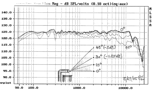

I do, at least a few charts on and off-axis, but they are of an older model that uses a different compression driver and waveguide. Sorry, I don't have any measurements of the current model.
The biggest difference is the compression driver used in the charts below was somewhat peaky and the tweeter horn wasn't quite as good either. This is pretty evident above ~1.2kHz. The tweeter I used back then was radial, so directivity wasn't as uniform as the current model with a waveguide. But the bass bin and midhorn are the same as the current model. So these charts show the LF/MF trend pretty well, and that's what you're after, I suspect.
I used to have access to a tall brick trihedral corner that was outdoors, and this made the perfect place to measure cornerhorns. It is no longer there, so I need to find another place that has this feature, or perhaps make a "portable corner." The measurement system I used back then wasn't all that hot either, but I think it still provided useful information.
Now days, I tend to use LMS outdoors for the measurements I publish, and I use WTPro for development work. When I'm doing design work, I'm mostly concerned with crossover frequencies, and I usually don't publish these pseudo-anechoic test-run measurements. Still, when I changed the waveguide, I confirmed the summing was good between midhorn and tweeter. But again, that has no affect on LF/MF response, so the charts below are still a good representation of current models at low and mid frequency. Still, I want to get new anechoic measurements of the current model cornerhorns using LMS as soon as I can.
In my cornerhorn implementation, the response is pretty much the same at all angles +/-45°. Beyond that, there is no output, because you're in another room. Obviously, some energy passes through the walls, but basically, you have full output throuout the +/-45° arc defined by the wall angle, and nothing outside of it. From the Schroeder frequency up, directivity is constant. There is a slight dip in the on-axis chart between about 100-250Hz, where the bass bin is "shaded". The midhorn and bass bin are blended in this region, so shading isn't bad but there is still about 2dB reduction of output on-axis, and out to about +/-15°.
2002 model seven Pi cornerhorn, on-axis, eighth-space anechoic
2002 model seven Pi cornerhorn, 20° off-axis, eighth-space anechoic
2002 model seven Pi cornerhorn, 40° off-axis, eighth-space anechoic
One small note: The on-axis chart is about 2dB lower than it should be, and and the 40° chart is about 2dB too high. I should have taken care to match the levels between sweeps, but I didn't. So mentally shift the charts when comparing. They show the response shape pretty well, but not the absolute SPL.

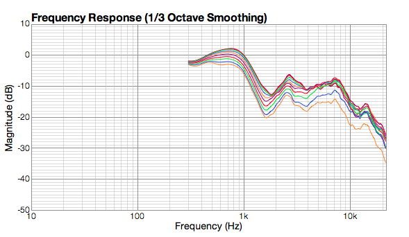

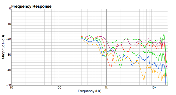

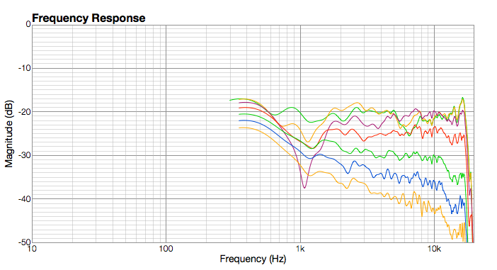

And just what does the vertical response of your Nathan's look like?
The question was "how omni are omni designs" and not "how much less omni are other designs".
For what it's worth here's the Nathan's vertical response (resolution about 300Hz).
0°-90° up:
attachment.php
0°-75° down:
attachment.php
