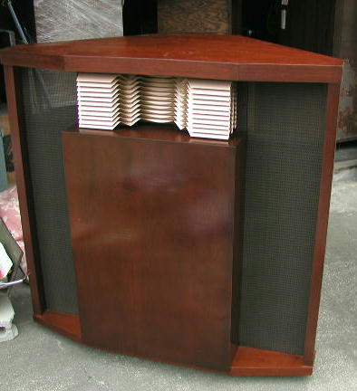

In the picture that you showed before things are even worse. That is because the horn does not actually go all the way to the walls, there is a gap. This gap is likely to be a disaster for a number of reasons.
The way to do this correctly would be to take an Abbey baffle and mount it directly into the corner - no gaps.
This corner placement idea is far from being a proven concept and I suspect that if anyone actually does do the proper measurements they will not look so good.
When the speaker is designed to be free standing and it is placed in the room such that the early reflections are minimized then its direct sound is the free field sound. In the corner placement there is no direct sound which is independent of the walls.
I don't understand why the gap is a problem. It's a horn with narrow dispersion, where what comes out is already partially collimated. One could close the gap with wings, but there shouldn't be a need really.
The gap could act like a port to a potential resonator behind the device.
Leaving the gap can produce a kind of diffuse echo which seems frequency dependent.

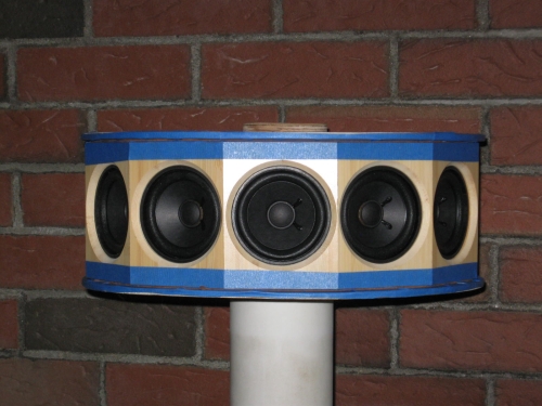

Exploration continues:

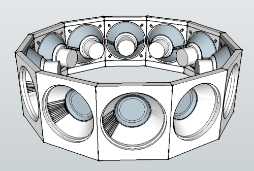

And a sketch view:
Twelve 3" Aura NS3-194-16A in ring structure. Blue tape is protecting wood from plasticine used as temporary seal while exploring stuffing and small volume. Ring structure has fascinating behavior. Placed on end of 4ft 12" diameter tube, and looking down tube through ring, sharp sound image appears below floor. It reminded me of Tom Danley's description of sound when head is placed into opening of Synergy Horn (A horn speaker subscribing to <1/4 wavelength spacing of drivers through crossover point(s)). With additional 12" tube stacked on ring, a large speaker results. It may be viewed as very omnidirectional in horizontal plane, and CBT characteristics give it very wide vertical behavior too.
Prior to putting temporary end plates on, I set rings and plates on floor and stood on them to seal them. Direct sound through feet was intense. Most of sound appeared from whatever direction I was looking.
As pictured, listening is quite good with just about any placement in room. Image is wide, deep, detailed, and very stable. Stuffing and final internal volume still need optimization. Making it two-way with really big tweeter-ring is a possibility too.
Unless the path taken runs the drivers/baffles beyond their design capabilities, then it will be worse. A non-coincident crossover can't be perfect, but can be made so good that it almost doesn't matter.
Those jubilee upper horns don't look quite up to doing 400Hz without being flush with the corner. Do they use a single driver?
The gap is an open space, not a constrained tuned space. The open space isn't going to act as port to the entire room........ Resonances and standing waves are not for HF. Either way, it can be closed for the fearful.

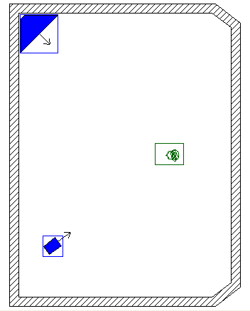

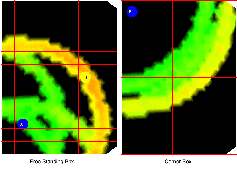

I was intrigued by Wayne's comments on the corner horn the last time the subject came up and ran some room simulations.
Note: These are only dirac impulse simulations in a bare room. But it's interesting to see how the reflections might play out. A speaker out in the room and a speaker in the corner. The green reflections are about 10-12dB down from the direct wave.
Comments?
